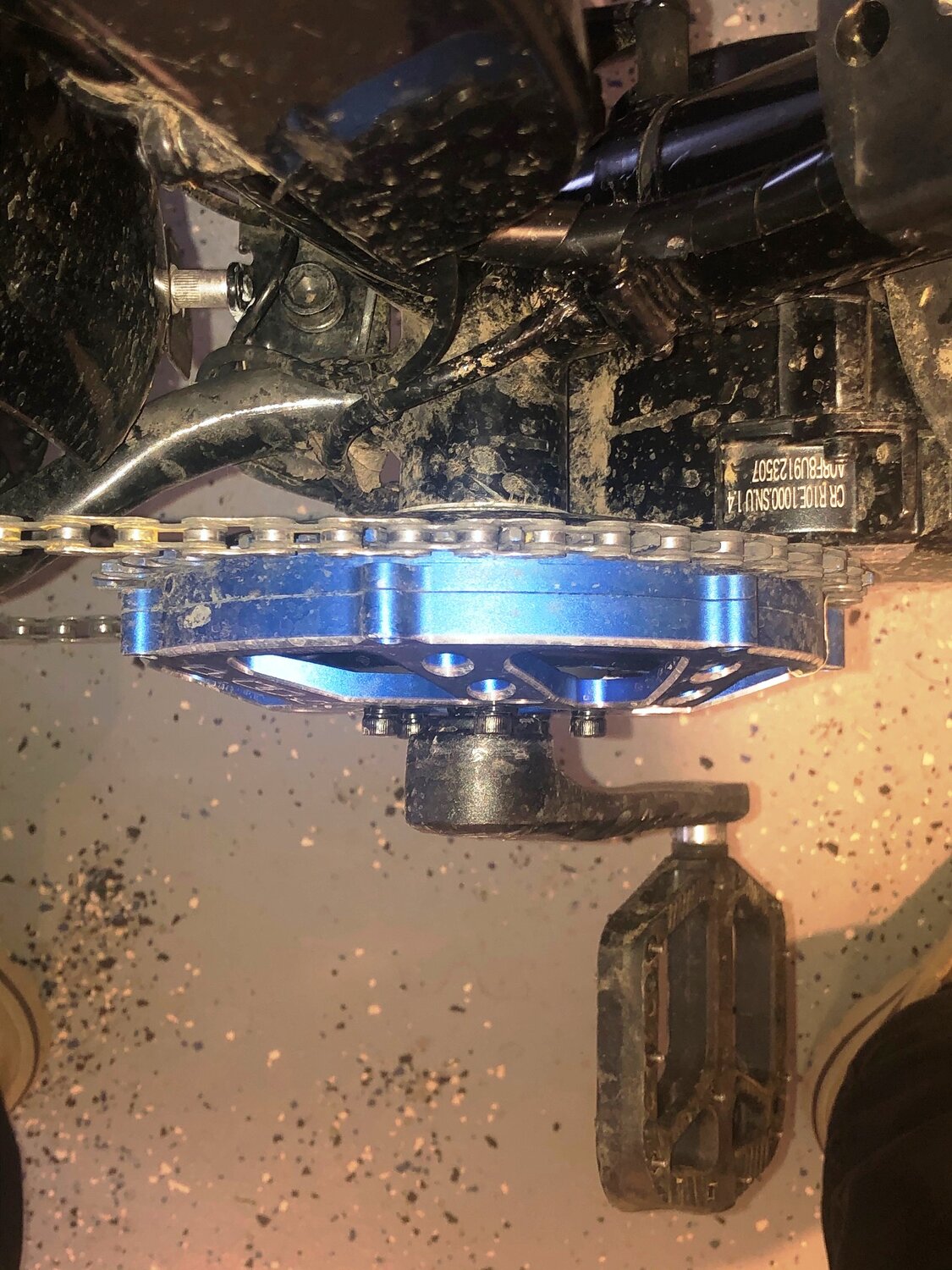

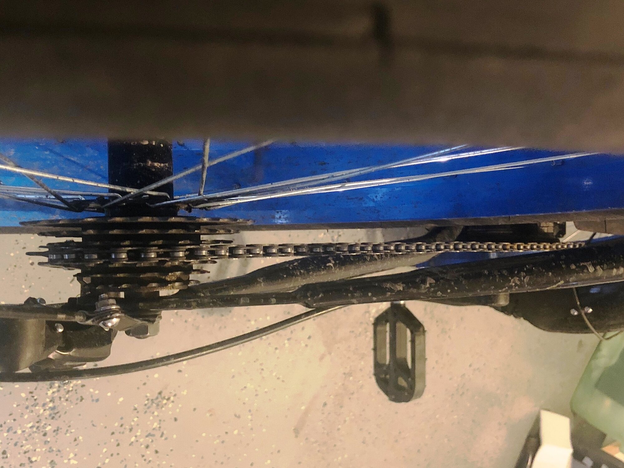

I have fiddled with the Luna 30T Mighty Mini, 40T, 42T and stock Bafang 46T chain ring. The Bafang 46T will not hold the chain consistently. The 42T is where I am sticking. Coupled with the 14-28 you can go anywhere and the stock freewheel gears seems really durable. The Luna 42T Chain line has a perfect off-set. (see pics) The 30 and the 40 had enough of an angle to cause the gears to ghost shift and grind and chatter.
I've been running the 42T with the stock 14-28 Mongoose Freewheel and it works perfectly. Comfortable top speed is about 18-20 MPH. 21-25mph, I am pedaling quickly but the motor is really spinning where it should be. I have my speed limited to 25MPH as I do not fancy dying on the road. I avoid roads and traffic as best I can.
I've got the DNP 11-34 Freewheel from Amazon that I tried earlier with the 30, 40, and 46 chainring, but I have not tried it with the 42T yet. Since the chain-line was previously less than ideal and I was getting ghost-shifting, I tried shifting the DNP 11-34 freewheel outwards with a 3mm spacer (upon advice from my local LBS) and used the 40T chainring. The gear setup for speed (11T) and climbing (34T)was excellent but I managed to completely strip the threads on the hub while climbing a 45 degree hill. Turns out losing 3MM of threads on the hub was critical under so much power. So I figured i would order a Cassette-type hub to replace the freewheel hub. No such luck. There are no fat bike cassette hubs that will fit that bike (190MM) and rim with 36 spokes in the US at this time. They are all 32 spokes. So I managed to call Pacific Cycle, the distributor for Mongoose and they shipped an entire back wheel and hub for $39.00!
So now I am running the Luna 42T with the stock 14-28 freewheel and it works great. Totally satisfied.

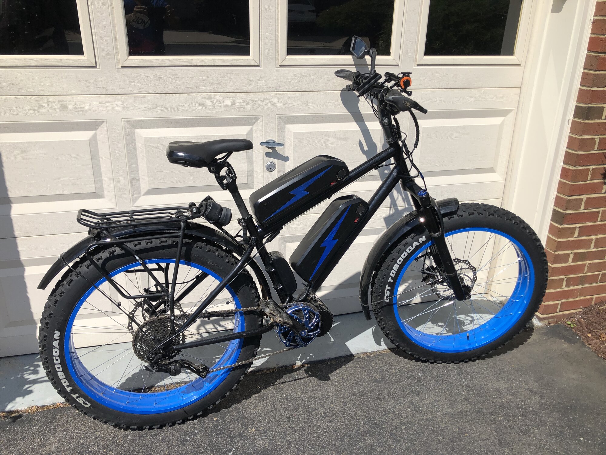

Hey Tom I finished my build today and took it for a test ride. You were right. Chain line is perfect with the Luna 42t chainring. My first test run hit 27 mph throttle only with the stock 14-28 freewheel. The next gear down topped out at 17mph throttle only. Gearing seems perfect for me. The bike is an aluminum framed Mongoose Juneau.
Sin Saint, your build looks great! Looks like a very capable monster and I am very envious of your 52V battery! Glad the chain line works well for you. That bike will go anywhere you want it to go, Be careful it will tempt you to do challenging things :) I always ride with elbow pads.

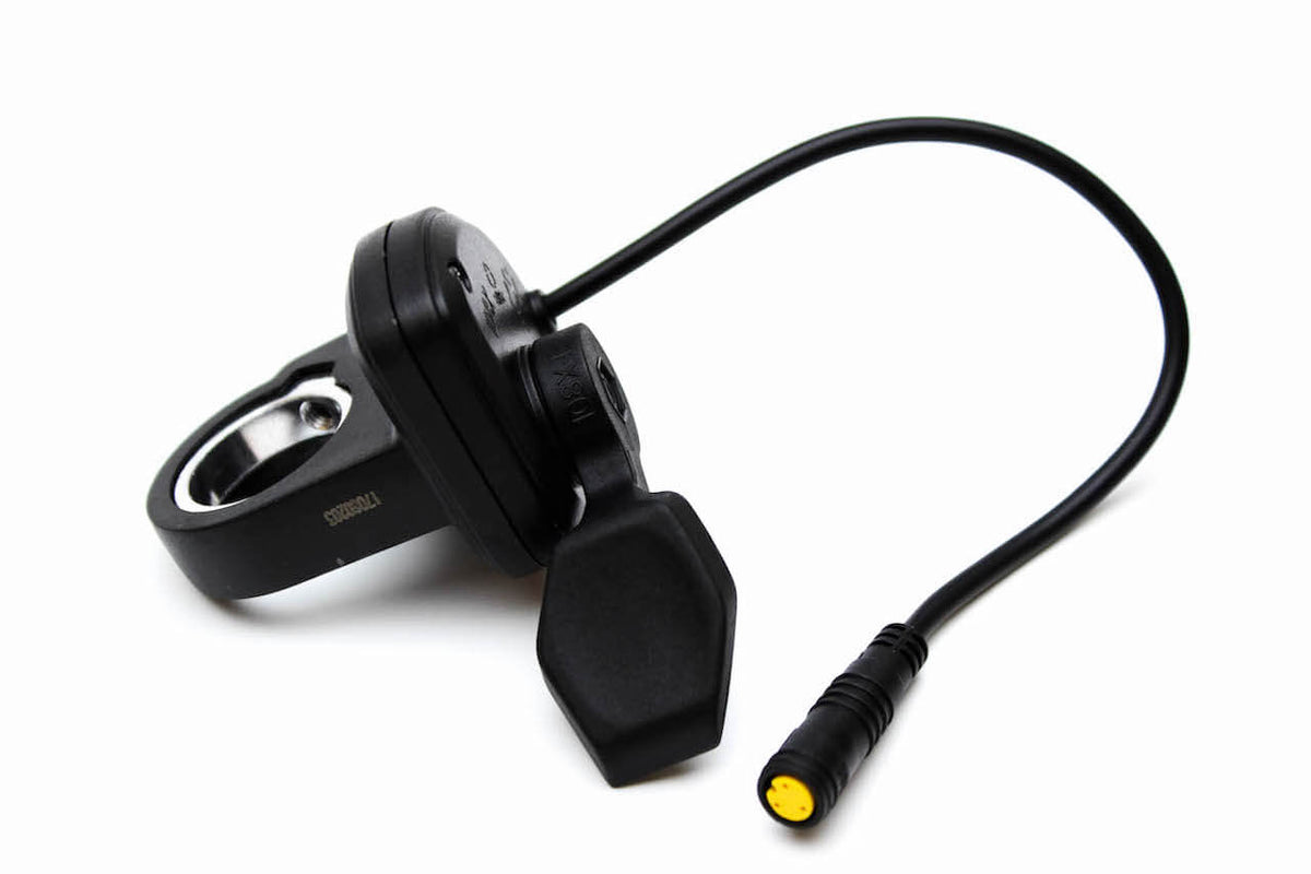

I also added the Bafang Thumb Throttle, I find it more comfortable and easier to use especially while riding over rough ground.

Update on my DIY:
So the pic below is my end product after 1 year and 5 months of riding.
I trimmed the metal fenders to shorten them a bit.
Bolany Front Air Shock
SunTour NCX Suspension Seatpost
Tannus Armor Tire Inserts
Added a second 20Ah on the top tube. It is not connected, It is a swap reserve.
Ditched the limiting Freewheel Hub for a Shimano type hub
9 Speed 11-42 Microshift Advent Cassette with matching Derailleur and Triger Shifter.
42T Luna Chainring
Rear Cargo Rack
SqLabs Grips
As of three weeks ago I have retired this Bike and will be riding my new Luna Cycle Z1 (see here)
My one last mod will be the installation of Hydraulic Brakes. Since I will be having the occasional friend ride this bike, it is time to replace the original (as cheap as China can make) cable brakes.
