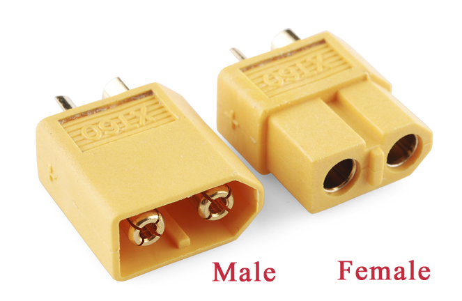

But since I'm in a transitional period.... Here you go 🙃
From the pic, it is a female XT60, the same as the battery ... I know it's confusing.
I didn't even look at the pic... I just went with the description.
And yes typically on connectors if the copper portion is male then the plastic shell is female... hence the confusion.
Are you saying that i can connect it to my battery? I have actually seen that before but I didnt buy it because it looked like it was a female connector.
It begs the question...are up to the task of installing a kit?
Also is there another way because I really dont want to pay 60$ shipping for something.
Buy one with the mating end (opposite) of what is on the battery already.
Batteries typically have a female.
Look for it locally... I was just trying to show you what you need.
That first one I linked is labeled incorrectly and probably wrong anyway

Have someone replace the ring terminals with a male XT60 on your controller wires. There's a "+" sign molded on the side of the XT. Red wire goes on that side.
