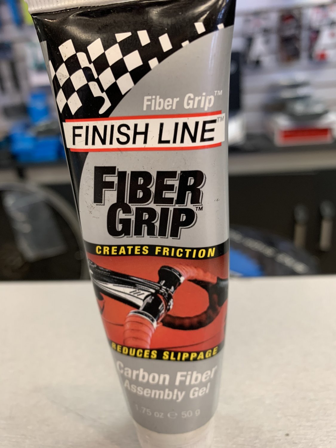

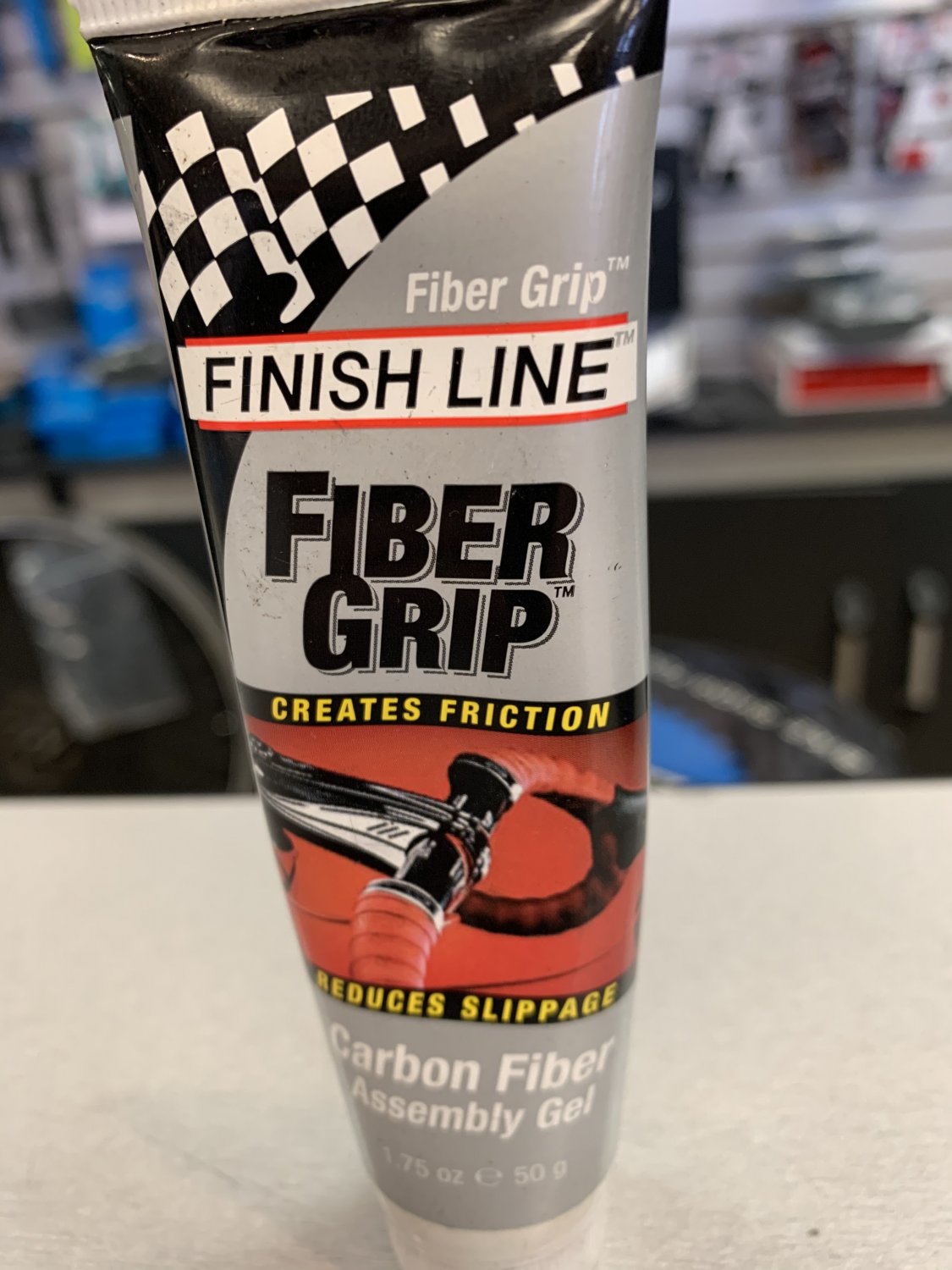

Well, just for shits & giggles, I stopped in the local Trek bike shop today while going through Princeton (Jays) and he told me that the major reason lots of trigger shifters are tight is because the cables are routed internally, have more twist, bends and routes that when they are not concealed, as well as some of the newer cables being coated with a type of covering which when wears away from friction creates resistance. He also indicated that "higher end" shifting mechanisms (as when they cost more) have a more "mechanical" click and feel and are by design stiffer. He said to replace the "coated" cables with pure, un-coated stainless steel cables. He also speaks with 30 years experience. Good, bad, indifferent, I'm just saying, I shouldn't have to do squat for a 2 day old bike and I should not have to be told by the LBS, "It'll break in", or, "That's the way it is"!!! Additionally, he also states that turning any barrels, screws, etc., with cause the derailleur to be mis-aligned. I speak from my own stupidity when I say over the last 5 years I've 'tried', and failed. Not my thing, cannot do, no luck, and I pay others to do what I cannot do. But again, I think my initial point is, I should not have to do crap for a brand new $6,000 bike and be told it'll break in or that's the way it is.
Additionally, the reasoning behind my carbon bike and seat post question is I got a new RedShift ShockStop Suspension SeatPost, and the instructions specifically state, " DO NOT grease seat tubes of carbon frames unless specified by the frame manufacturer". Hence, if that is a concern, and Trek has no definitive "answer", I find that problematic and of concern.
The bike shop I stopped in showed me this: (I'll be ordering)
Hey Trek, Educate your people!!
The bike shop I stopped in showed me this: (I'll be ordering)View attachment 42722Sounds like t
That was the grease I was going to suggest you when I saw your post but you have found it.
