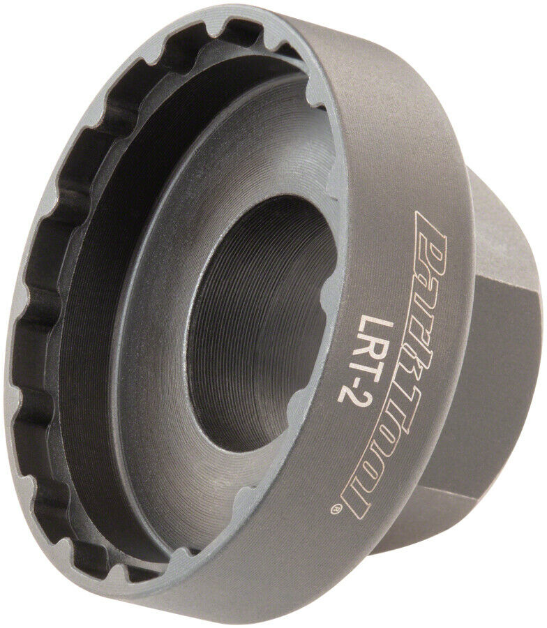

He lacks the proprietary Shimano tool to remove the chainring, which will be necessary to pivot the motor out of the way to complete installing the dropper.

Sorry to hear that the dropper cable was pinched... here is the correct tool for the Shimano Steps chainring.
Thanks, I have the tool but I'm in MA and he's in OR.
