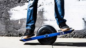

All models of Onewheel electric skateboards are being recalled after the maker Future Motion received reports of four deaths of users between 2019 and 2021 and multiple reports of serious injuries.
A bike company that I worked for sold these. One look and you just know it is a deathtrap. Leading up to Christmas of 2019 I could sell one per hour online from stock in 13 retail stores. The thing is what I was selling was often already in the hands of a retail customer standing in line waiting to check out. When they got to the counter they would need to be told that the one they are holding was already purchased and that they can't have it. People were going ape-shite over something that could clearly kill their kids. I wonder how many people will refuse the recall. They sold for $1,000.
Most OneWheels can be fixed via an OTA firmware update so its not a recall as we old-timers understand it.
For the oldest models that are not connected to an app, all they are doing is giving a $100 credit towards buying a new one so I doubt thats going to fly very far.
The software update makes what is called a haptic buzz. The motor shudders at limits and high loads. It dose not help with the inherent instability, or the types of people who are attracted to these things.
Lots of clavicles, tailbones, and split melons. I read that it is mostly because of the wheelbase geo. Some sell for $2000 before add-ons like a fender so it does not suck in your pants' leg. So, no Mc hot coffee for us!
