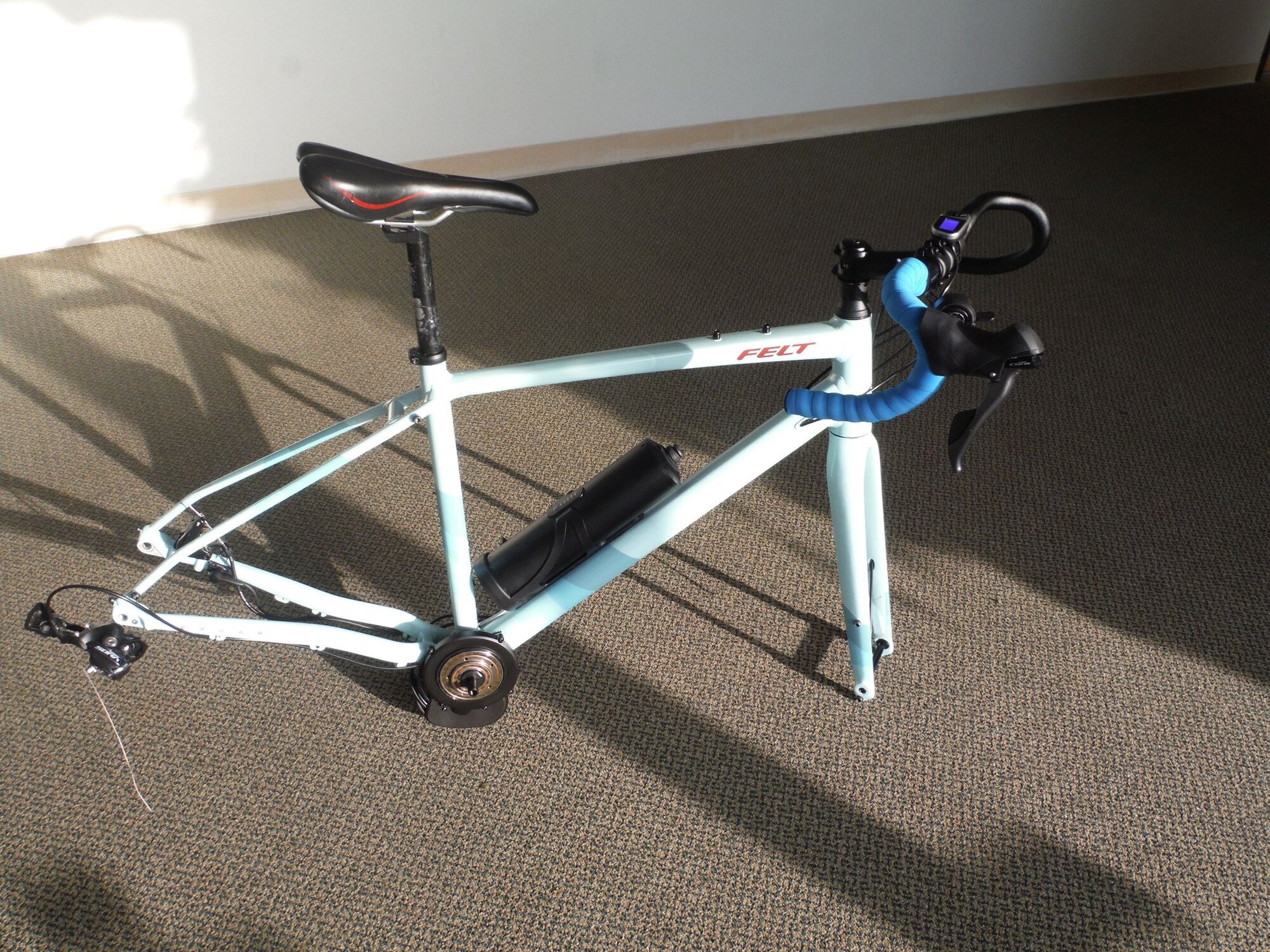

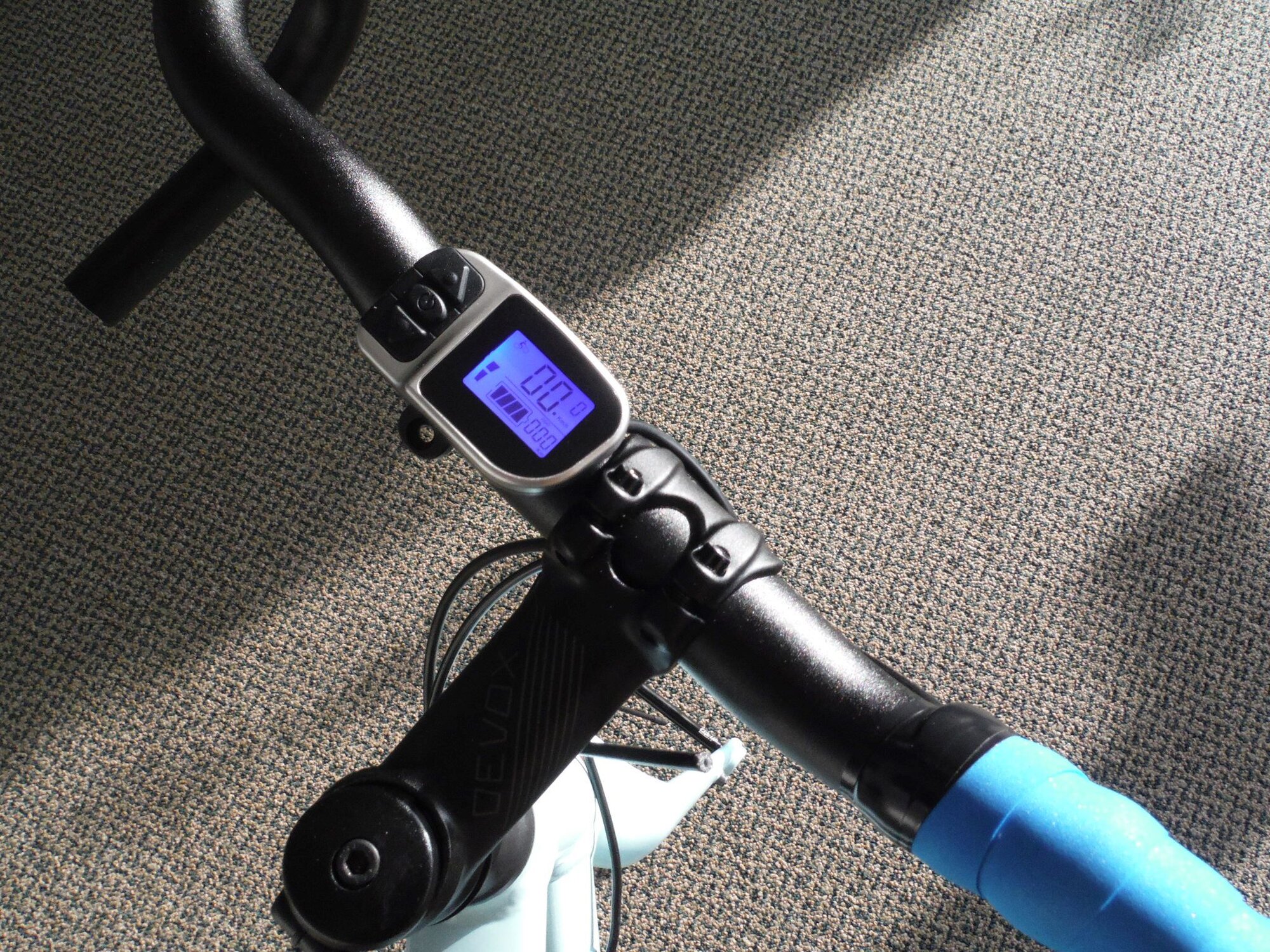

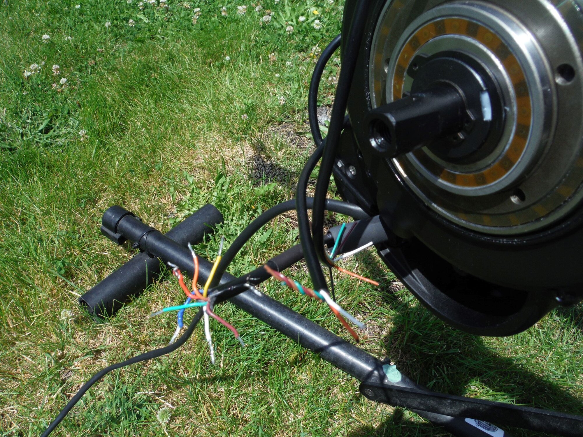

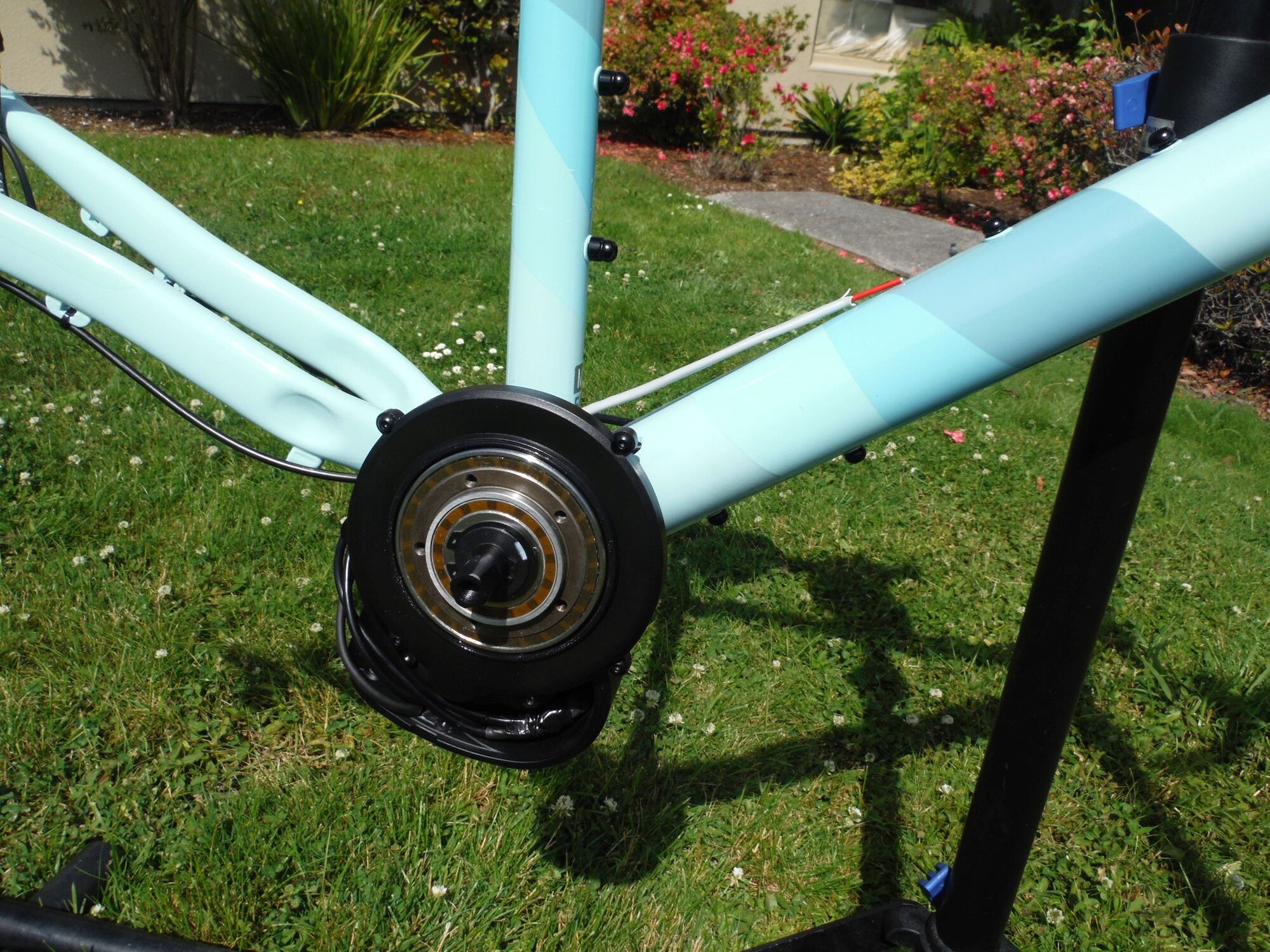

I run open source all the way, proprietary sucks. This gravel/adventure build is open source like Wiki & Linux. It is 90Nm, with a cargo duty motor. It has a torque sensor, cadence sensor, & supplemental throttle for just in case for emergencies, and is all through frame. Quiet, smooth, intuitive! Here it is in the process. This is how sausage gets made. It got wheels today and 45mm 650b WTB gravel tires. The ring and crank arms and pedals are on. Ready to rock with no distracting Peleton BS. Pure. Nobody has a bike that does this all at any price! Note: the seat post was just for the stand and has been since updated. This is what happens when art fuses with tech.
