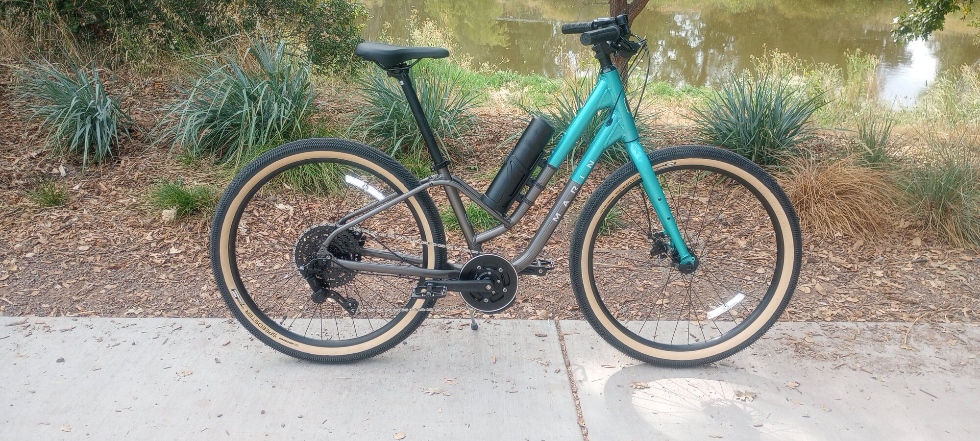

This is a Marin Bikes Stinson 2 that has been converted with a 500W torque sensing cargo motor and a premium 48V battery. The top gearing is 46-11 with an 11-47 cassette. It is getting a rack, panniers, and fenders as a commuter bike. It does 29 on the flats. Poll question: What would you do differently to suit your riding preferences?

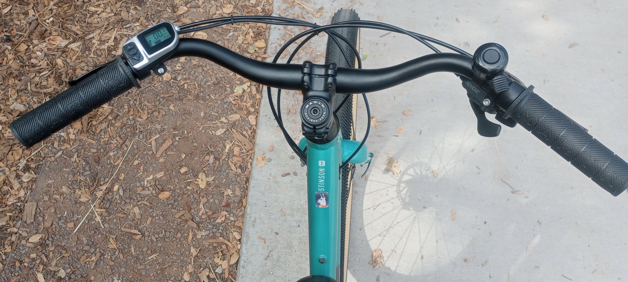

I want to add contoured Bontrager comfort grips and a Boulevard saddle along with the German fenders, the rack and panniers. It has mechanical brakes with no compression housing and highly polished stainless premium cable coated with gun oil. The pull to lock is 1/4 inch. It totally skids at lockup. Adjustment is easy, no vapor lock ever, or messy bleeds.

In terms of design this is an A+. I love how clean everything is, the cable management, the "hidden in plain" sight water bottle battery. Would love to hear how you built it.
That’s a good looking bike and looks super light and quick. I wouldn’t change a thing and would ride that for my commute all day long. I don’t care for fenders and just wear a backpack. Does the water bottle battery come off to charge or do you plug in to the bike?
@JGcycle, It is a 9-speed with the overall range of an 11-speed. Because it is nine, it is 22% more robust. It is much less expensive to maintain. The cassette is 11-47 teeth.
@AvalancheRun, It is a very strong climber. This setup 'likes' high cadence. Like a sports car, down shift and rev to accelerate, then up shift. I like the external battery. In five years I can replace the battery with whatever I want and won't be stuck with something that is expensive, proprietary, and not supported. Because the motor does not have a proprietary mounting system, in ten years I can also replace it with any motor I want. It took drilling to run the rear cables over the bottom bracket, so they wouldn't get crushed by the motor. It also took soldering little wires inside the motor after chopping off connectors. I removed speed limiters and drilled the motor housing to run the display and sealed that hole with gasket maker. Three people just tested it with runs up a five-story parking garage. For one avid cyclist, there is no going back. The fenders went on this morning and the rack goes on this afternoon.

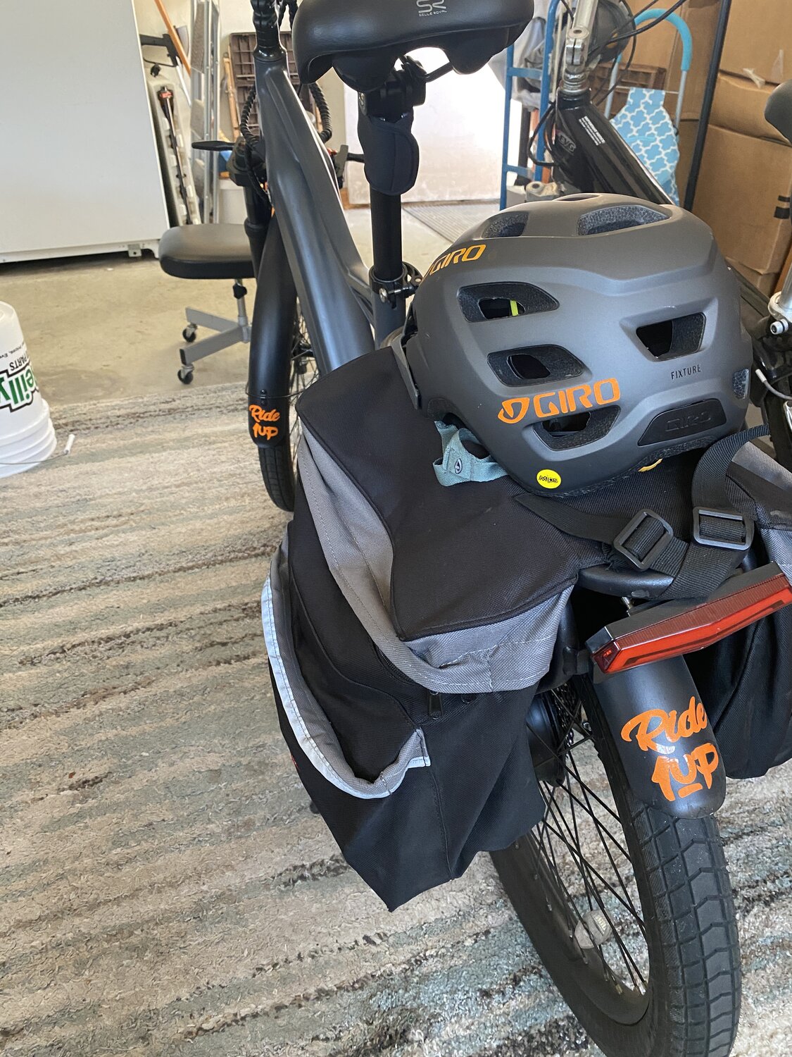

@scottsdalecommuter, I like a rack so that I can do things like shopping and still keep the center of gravity low for handling. Also, as a commuter bike panniers won't wrinkle your shirt before work. It needs lights. I have some picked out. These are German SKS fenders. They are very lightweight and come with anti-rattle bushing. I had to stack bushings to get around the front caliper.

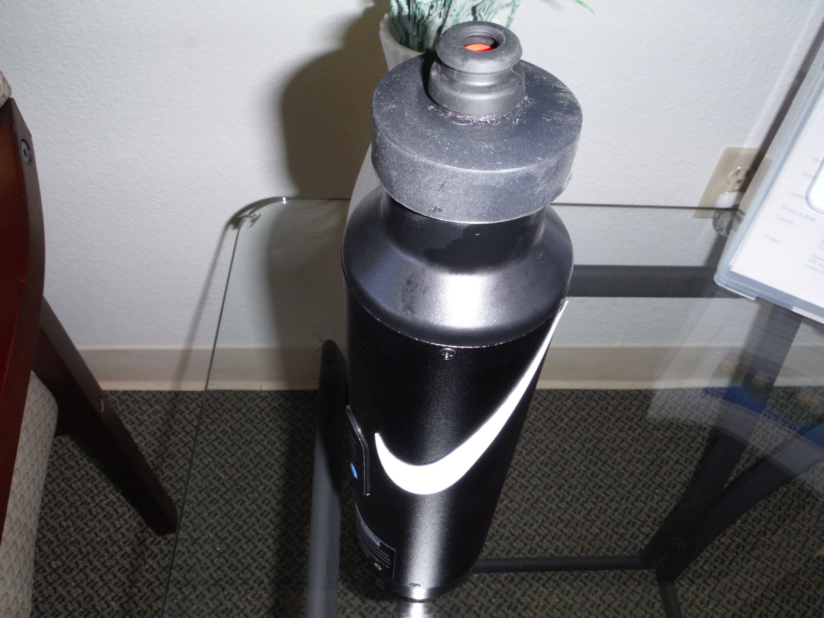

One more question: how many Wh is the battery?

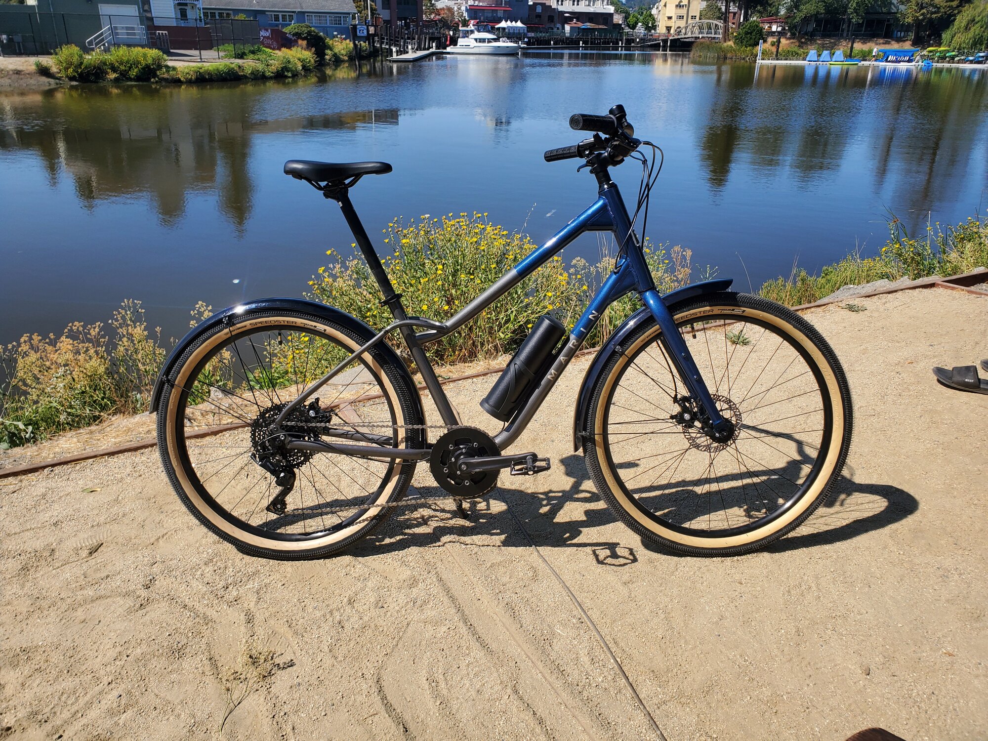

That battery holder can take either a 48V 7Ah or a 48V 10.5Ah, depending on that day's ride. If you want to ride until your butt gets numb and falls off, take both. The 7 is 336Wh the 10.5 is 504. These are premium cells with a super premium BMS chip and the motor is highly efficient. I normally take the smallest battery I can get away with. My town is four square miles and it takes 15 minutes or less by bike to get anywhere. The hills to the West are nice leading to the sea but I don't often ride just for recreation unless it is a group ride. Oh, here is that bike's little sister. It has an 11-50 tooth cassette, 42-t chainring, and a 90Nm motor.

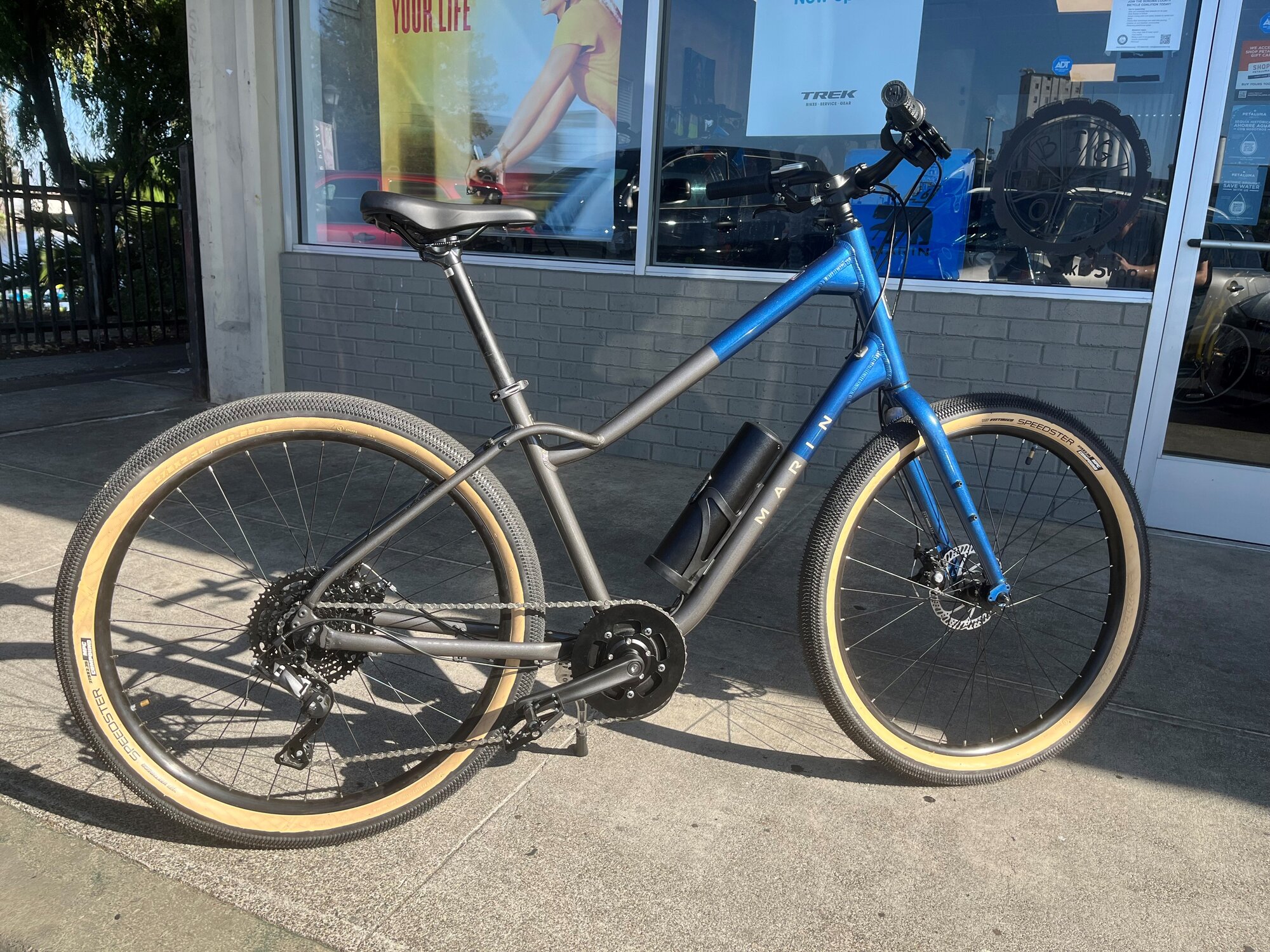

You did not design or build the Marin bike. Marin makes e-bikes, too, and these do not look like the Stinson. Ever wondered why?
You maimed the Stinson, making it a potential danger to the rider and people around him. Do you have a good lawyer in the case a disaster strikes?
