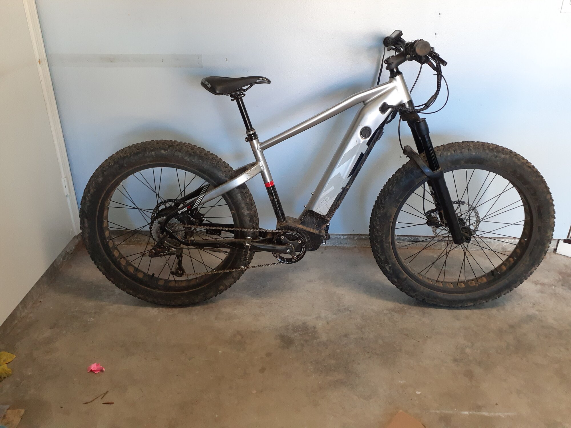

I have a Mastadon Comp EXT 140mm travel on an iGo fatbike; I upgraded from the stock RST. Its a fine choice and you dont have to worry about it being too firm; you adjust it to your weight with an air spring, set the sag and compression, and enjoy the ride. I use my fatbike as a full-on mountain bike on the same trails I take my full suspension Yamaha.

Nice bike. I just had the Comp put on my bike. I'm picking it up this weekend. The bike shop ordered the Masterdon Comp - 120mm version. They suggested not expanding the fork to 140mm since it will raise the front end of the bike. How is a full 140mm of travel working for you. Did it raise the front of the bike for you?
The fork length matched the one that came off the bike so it didnt raise the front. Thats not necessarily a bad thing if its raised a little though, most modern mountain bikes have slack head tube angles to help with downhill stability. I've found its hard to use all the 140mm travel.
I'll try the fork at 120mm to start. I had a spring loaded 80mm fork so I'll see if it changes the geometry of the bike. The bike shop said that the Comp was half the weight of what came off the bike so that is great. I weight 207 and the wife is 126lbs so I asked my shop to setup forks accordingly. How did you find the setup on the Comp? Was it fairly easy to set sag, etc?
