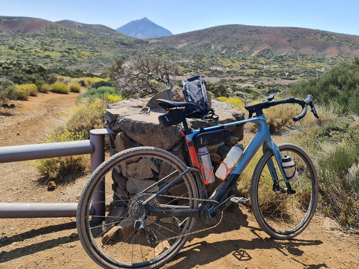

Hi all, I own a 3T Boost with the Mahle X20 motor and live in Europe. The bike has a fixed speed limit of 25Km /h. I was wondering if I could update the firmware from Europe to US as in the US the max speed is 20Miles that is +/- 32Km/h. Thanks for your advice,

Not. No dealer would do that for you under the threat of losing their dealership. (They are even unable to do it because the dealer software is geofenced).
You might look for (illegal) speed derestrictors available in the aftermarket. As I do not own any Mahle X20 e-bike, I cannot give you a concrete advice though.
