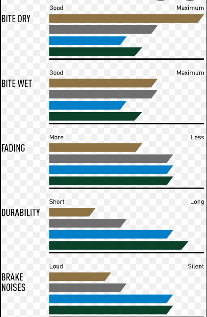

Here is the chart for how the pad compounds compare, and a link to compound description (gold - race, grey performance, blue comfort, green s-pedelec)

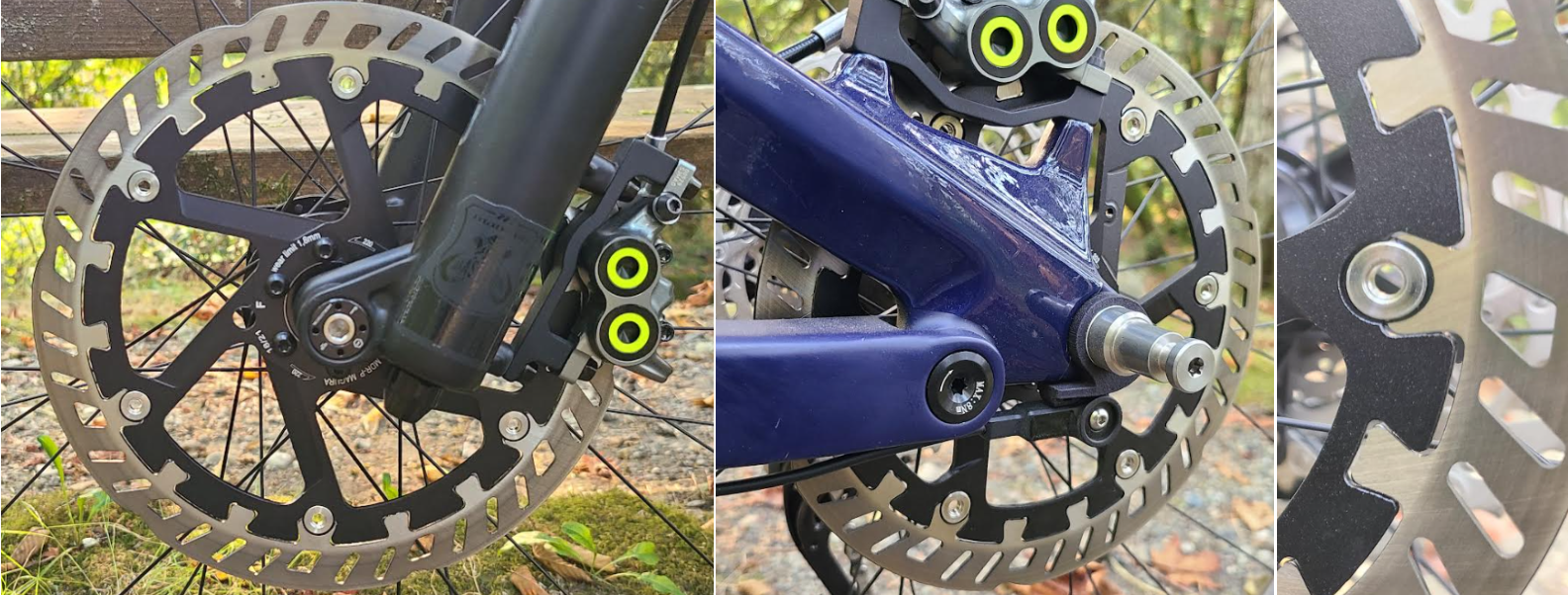

I took a ride out over the weekend and bedded my 8.S Magura pads in - at least I think I did them right. Finding enough of a flat stretch around here to get 30kmh then stop isn't easy to do once let alone 30 times... so I opted for riding to the top of my neighborhood and going down, probably all in all a 550-600 foot descent over a mile or so with two relatively flat stretches. My tires are 30" tall and the bike picked up speed crazy fast down 15% grade - so I was able to get the rotors nice and toasty - though I'm unsure what the optimum temperature is... I don't think I noticed any squealing or chattering from the brake pads over my ride which got quite dusty, though about halfway on the return trip my motor got a little loud at certain speeds for a while. Here's what my rotors looked like halfway through the ride - I took more opportunity on the downhill back to get on them some more but more or less they look about the same - smooth as glass and I have to be careful with how hard I hit the brake lever - so I'm assuming they transferred pad material properly. I still get a little bit of rub from them from the rotors not being perfectly true to the 0.01mm but already greatly improved after just the one ride.
