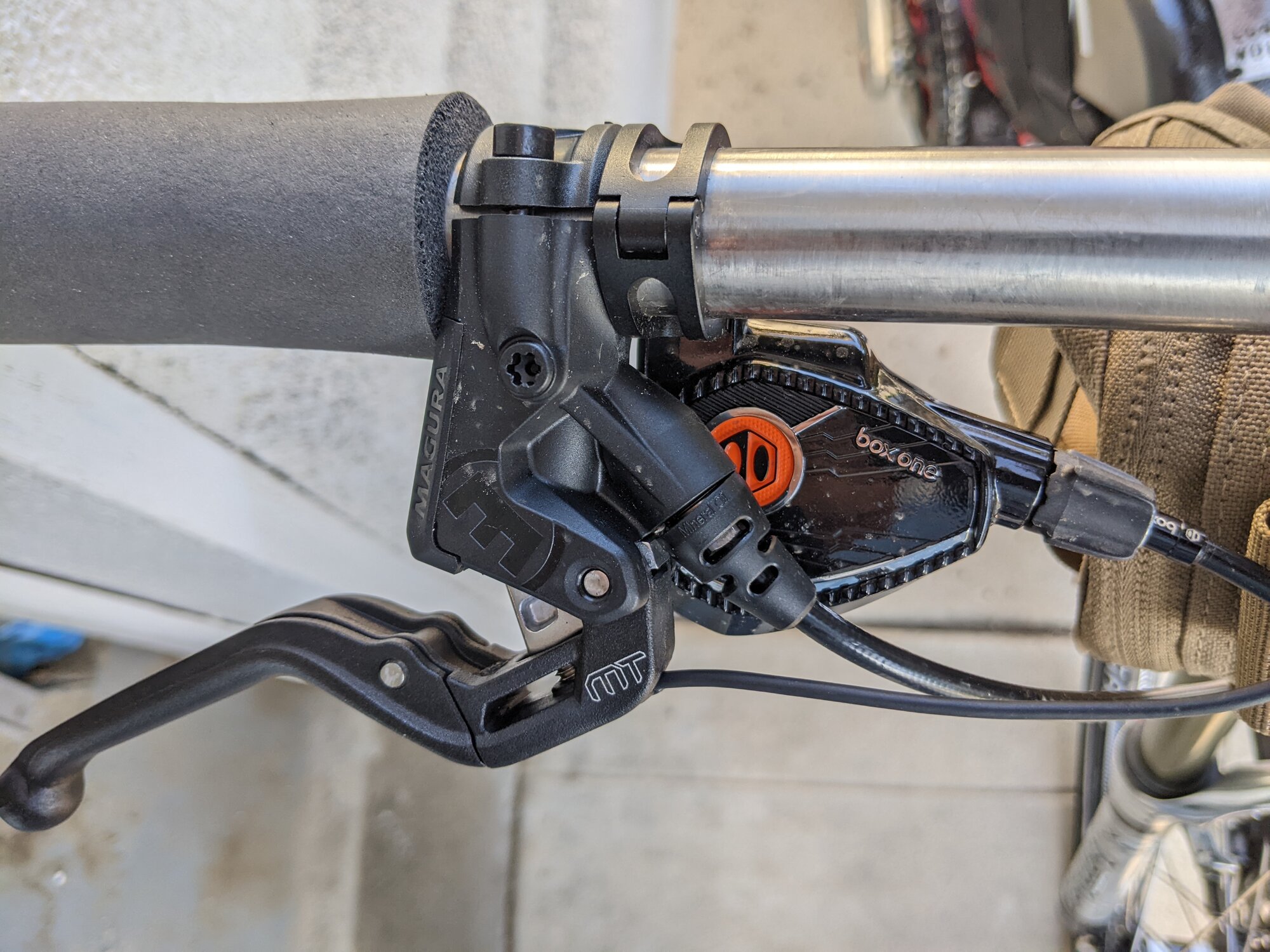

On the wire direction coming out of the levers, I snapped a pic on a bike yesterday. The wires follow the direction of the lines, not sticking out front like an earlier post claimed.
