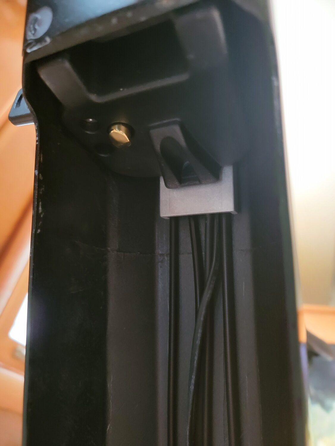

Just spoke with Greg at WW, sounds like they've been tucking the extra brake connectors inside the downtube above the upper battery locking cradle, so that's good news!
