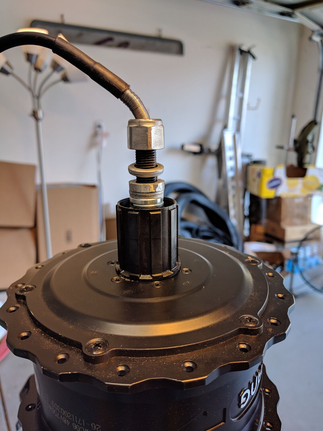

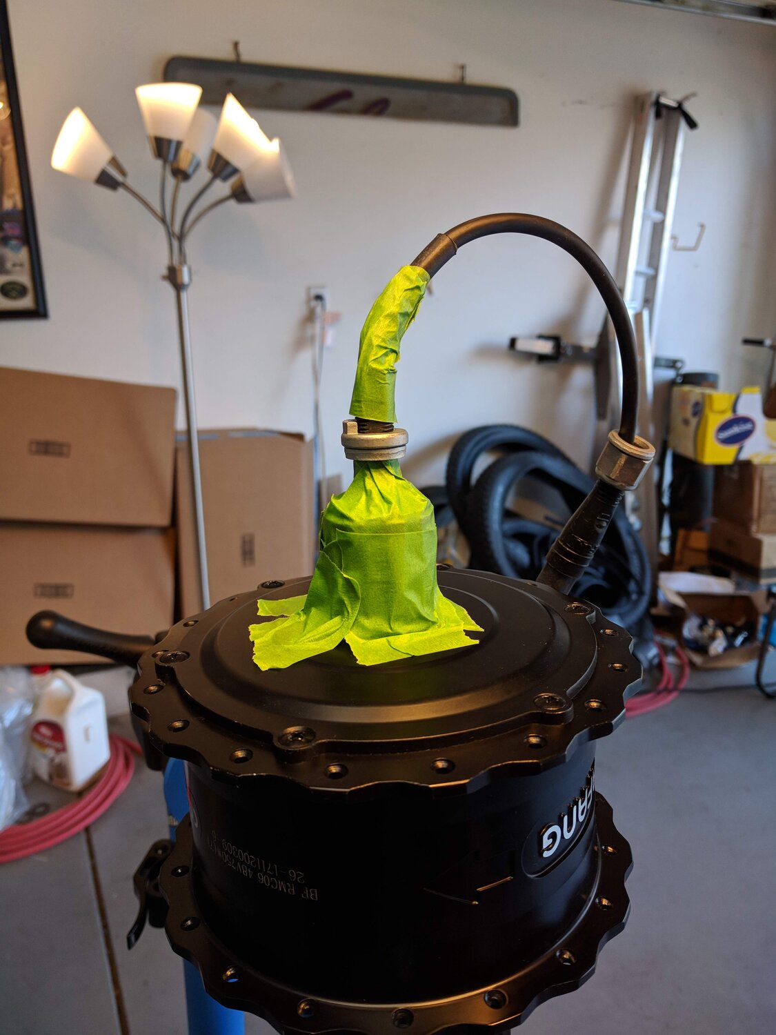

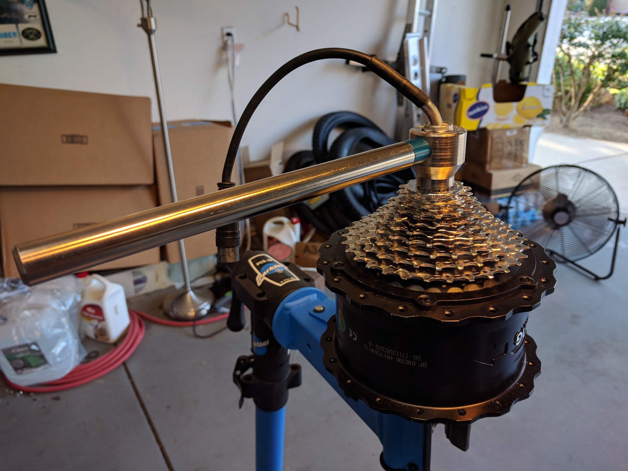

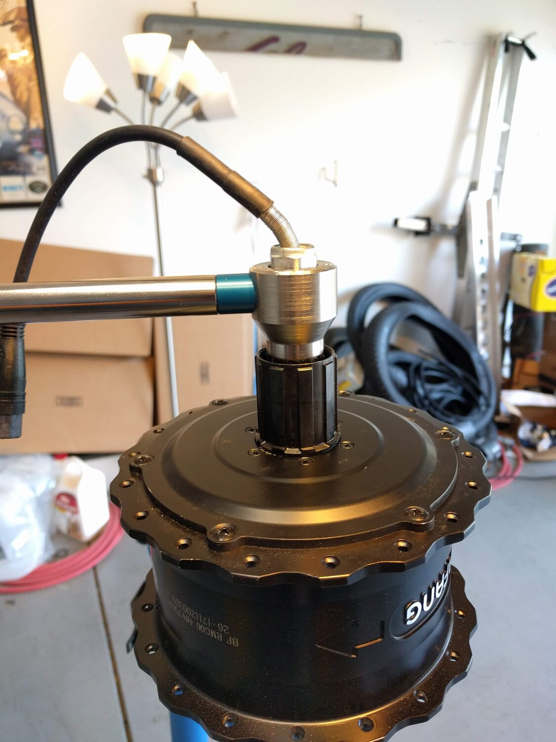

On cassette motors, Before the Bolton tool existed I went a different way. I have a variety of cassette tools. Nothing fits because of the bolts although the Park tool in the pictures can make it over the plug at least.
I reprofiled the bolt and washers with a hand file. Its not as tough to do as you might think although you need to be careful not to overdo it. And use a hi quality hand file. You take off the corners, which are most of the obstruction, and *carefully* shave down the flats just a bit. then you also reduce the diameter of the locking washer.
Since I use a quality adjustable wrench, and I didn't change any of the angles, removal from the bike is unaffected.
Even the Bolton tool doesn't fit every motor. Good old Bafang isn't 100% consistent on their parts. This can be your only solution depending on your motor.

View attachment 86008View attachment 86009View attachment 86010View attachment 86011
