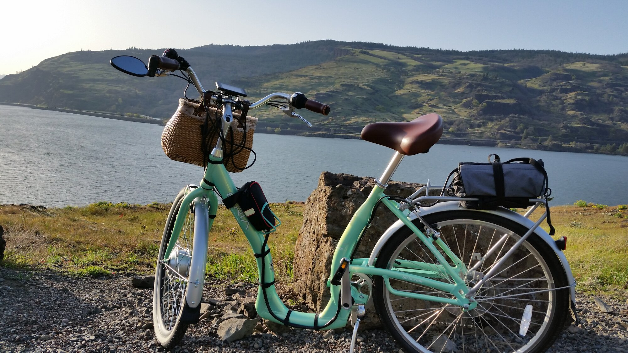

This is my wife's bike that I installed a front hub motor on - it works great including steep grades but a front motor can spin the wheel on low traction surfaces like gravel or grass.
