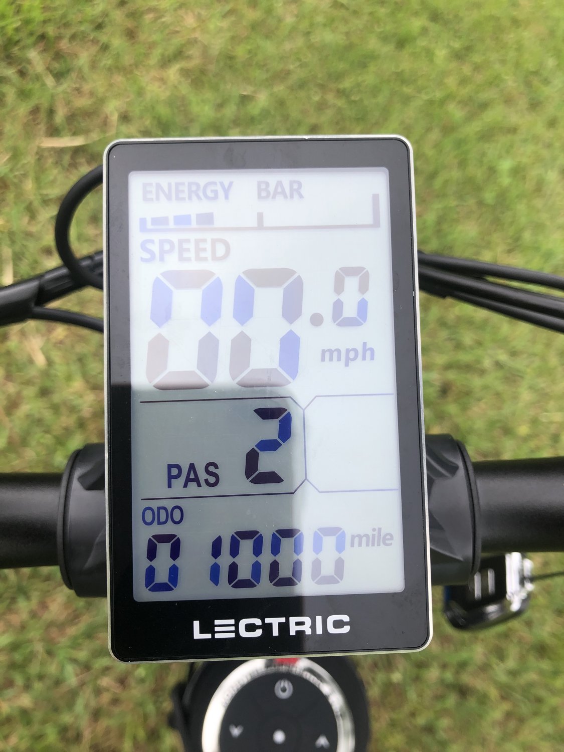

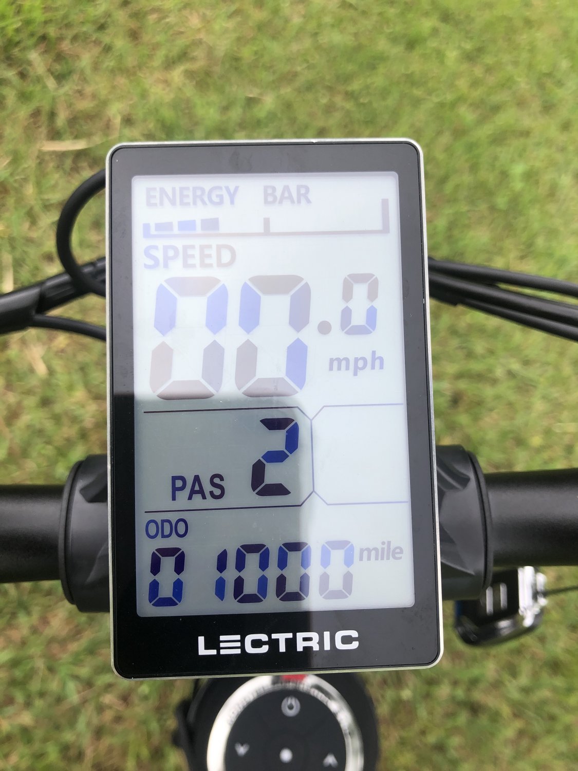

Just seeking some info about anyone that has a lot of mileage or has been an early adopter of the XP....I am about to hit the 1k on the ODO. I know primarly about battery care not charging it to 100% too often and maybe checking the brake pads, but not too much else about long term ownership or taking it for longer end care if some vets care to chime in I'd apperciate it.
