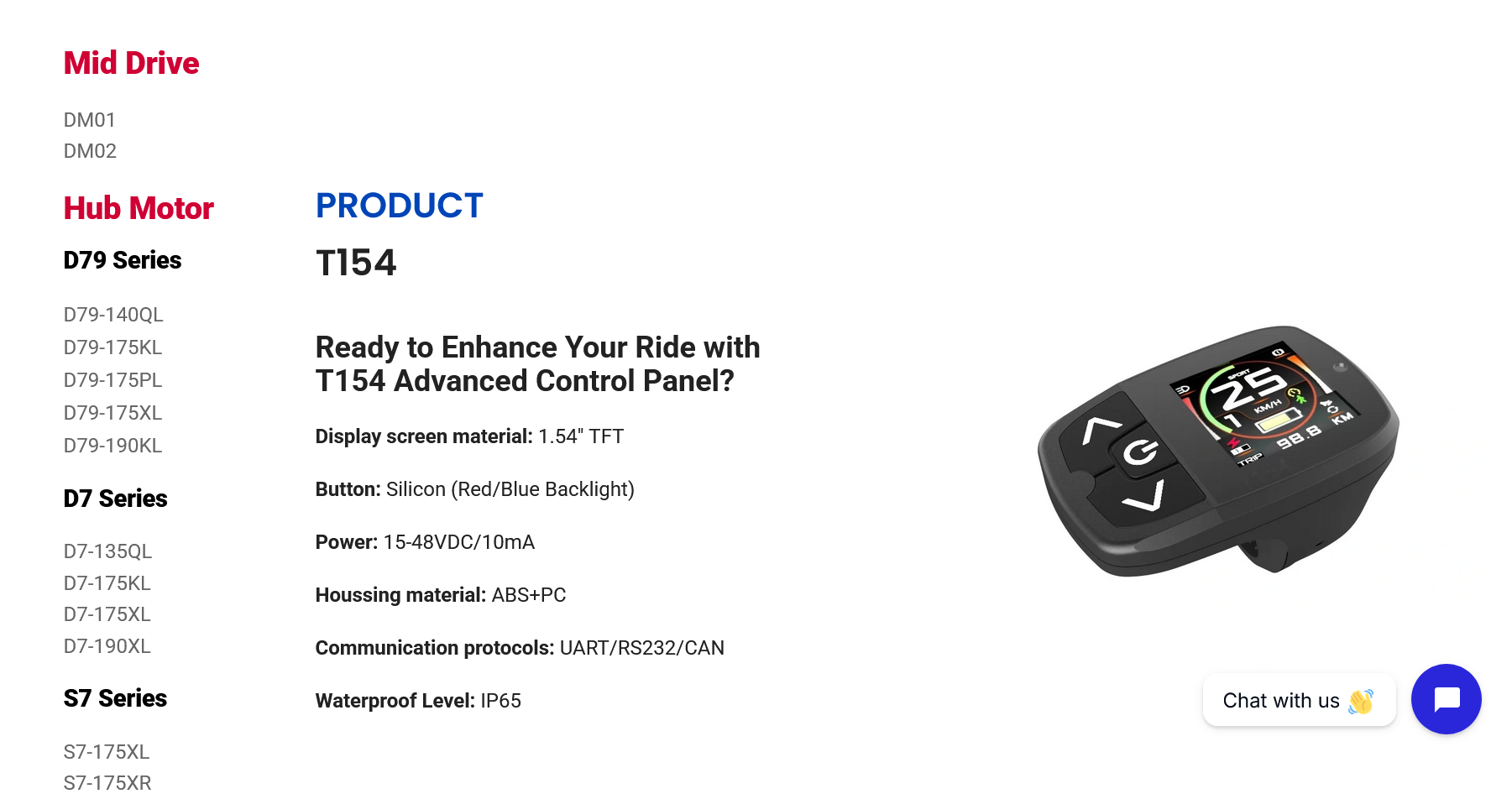

@PedalUma is having a lot of success with the new ToSeven motors. They add a layer of refinement as it uses a torque sensor which gives a more natural ride experience. The aforementioned BBS02B uses a cadence sensor to implement assistance.
Not sure if these are CANbus or UART... but you can inquire with Anna: [email protected]
ToSeven Communication protocols: UART/RS232/CAN
