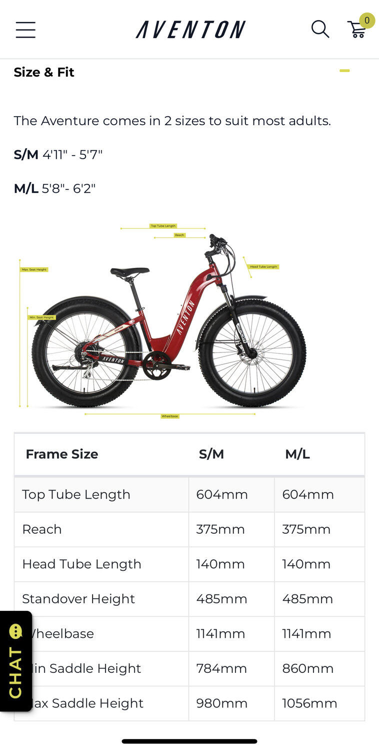

1. Unfortunately, the S/M frame has the same dimensions as the M/L frame. The only difference is the S/M has a shorter seat post. I’m a bit concerned about the reach, but suppose I can add an adjustable stem to help with that. For perspective, there are no perfect solutions for a 4’9” rider, she’s been riding bikes her whole life that are technically too big for her. Just looking for something that approaches a suitable size that she can safely ride. Are there any shorter riders out there who have any experience with the S/M Step Through frame who can share there thoughts on whether it’s manageable?

1. How did you come to the conclusion that the S/M and M/L frames had the same dimensions? The geo chart on their site says every relevant measurement is different(I am a bit confused about the standover height, though).
Frame SizeS/MM/L
Height4'11" - 5'7"5'8" - 6'2"
Top Tube Length572mm613mm
Reach373mm404mm
Head Tube Length120mm130mm
Standover Height477mm459mm
Wheelbase1095mm1130mm
Min Saddle Height810mm875mm
Max Saddle Height975mm1065mm

I could have sworn all the frame specs on the Level 2’s were identical on Aventon’s website a few days ago other than the seat post height. Interestingly, I see now the S/M and M/L frame specs for the Aventure are all the same except for the seat post height. So maybe that was what I was looking at.

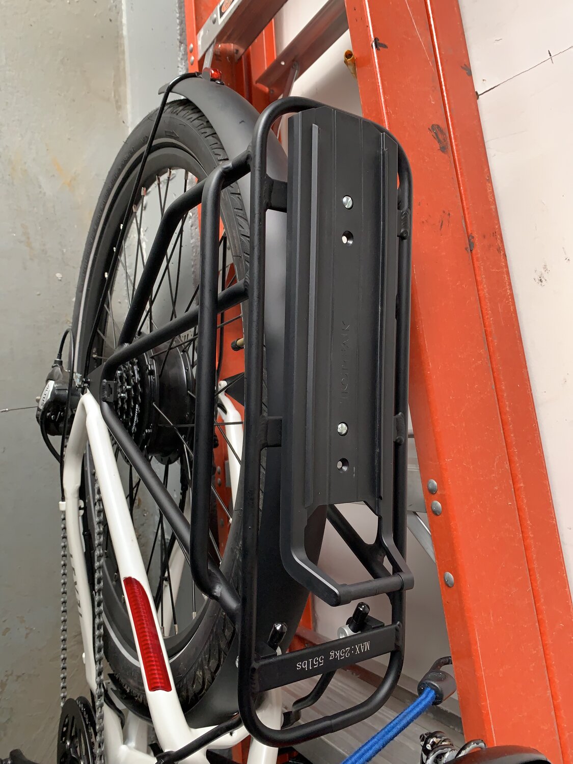

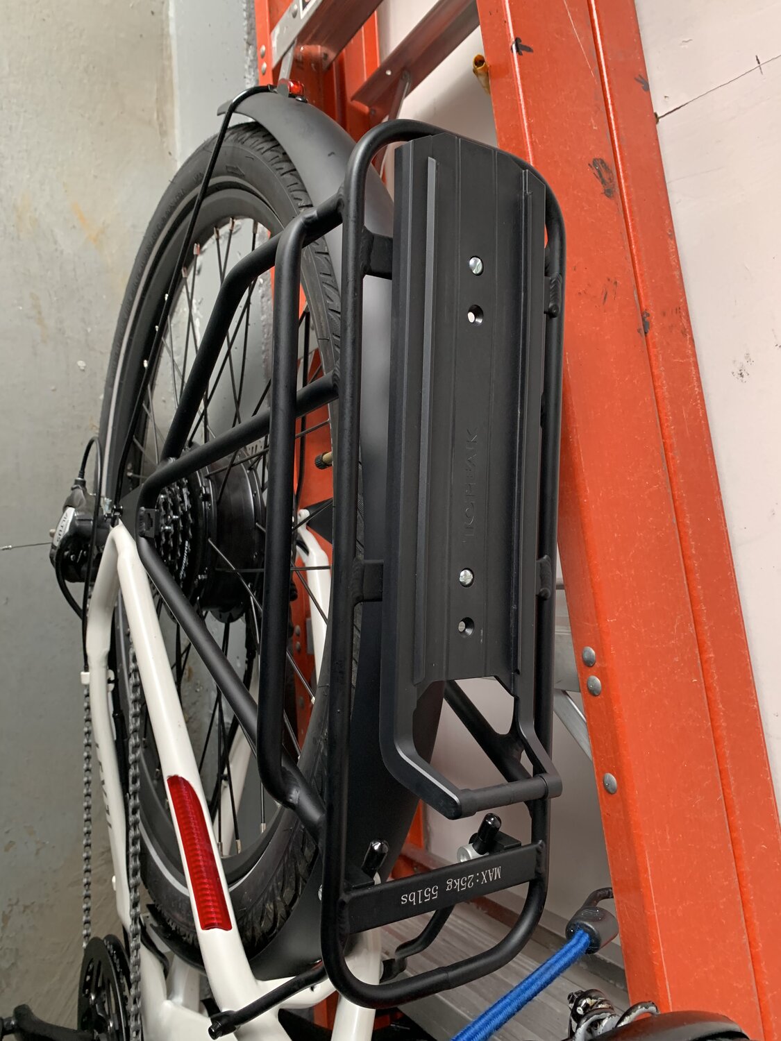

Has anyone tried to attach the Topeak quick rack adapter to their rack on a Level 2 ST? I have a couple of them attached to my Espin Sports and it is a tricky fit requiring some zip ties based on the fit of the quick rack.
Yes , I installed on my level 2. , had to drill new holes in bike rack and add new screws and nuts.
