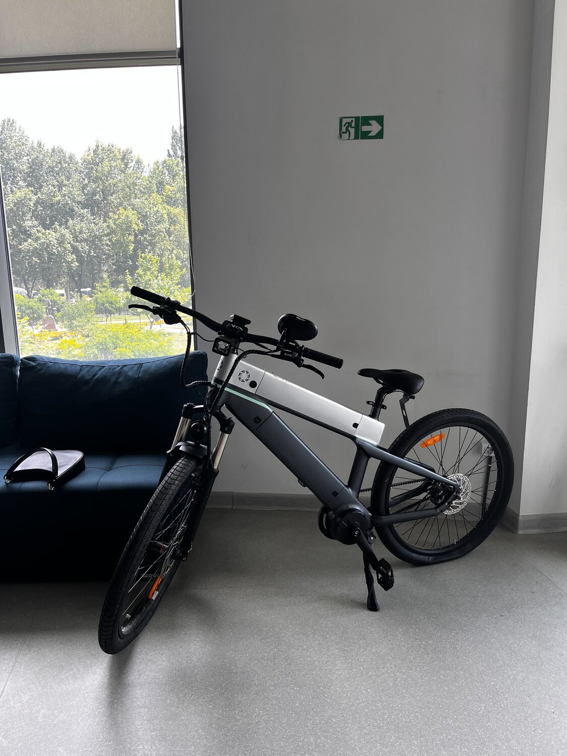

Great bike. Here's ours, standing at the office. We've validated it recently. Are you familiar with Fuell?
