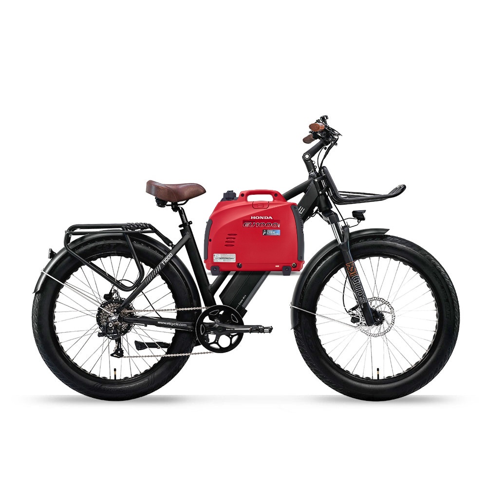

Legal? Hybrid ebike.
No, 600w in 250 out, but of course legal ebikes use more than 250, but rarely more than 600.

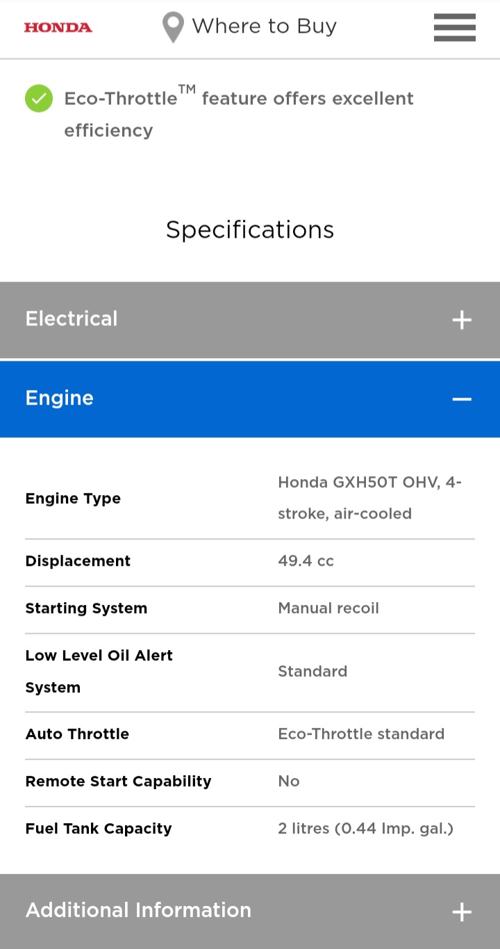

The Honda EU1000I generator has a 49.4cc, quiet, clean burning, fuel efficient 4-stoke engine.

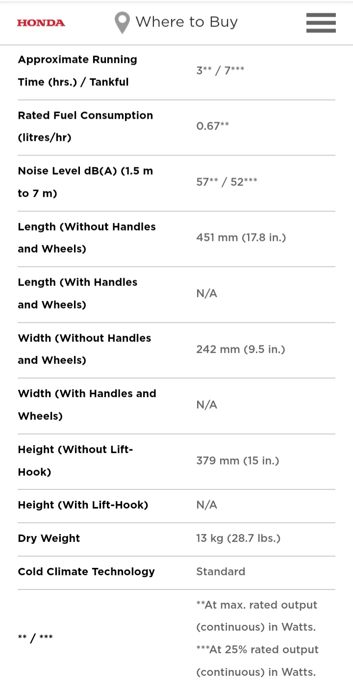

It weighs almost the same as my two batteries at 28.7 pounds.

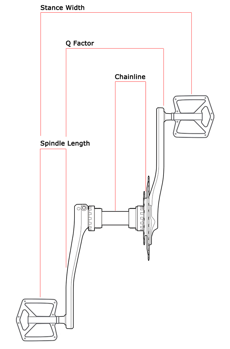

The generator is 9.5" wide, so my Q-factor will increase by 1.5"... Not that bad.

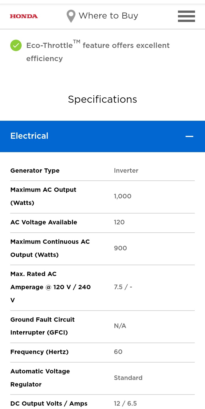

The EU1000I puts out 900 Watts for 3 hours.
That's 2700 Watt Hours for a tank of gas.
My 48 Volt 25ah battery is 1200 Watt hours.
So for the same weight, the EU1000I has ~the same power to weight ratio as two of my batteries.
BUT,.. Gas stations are everywhere. It can be a lot harder to find an outlet in the middle of nowhere.
So,.. I'm thinking one battery along with the Honda generator will get me to my next gas station while searching for an outlet.
