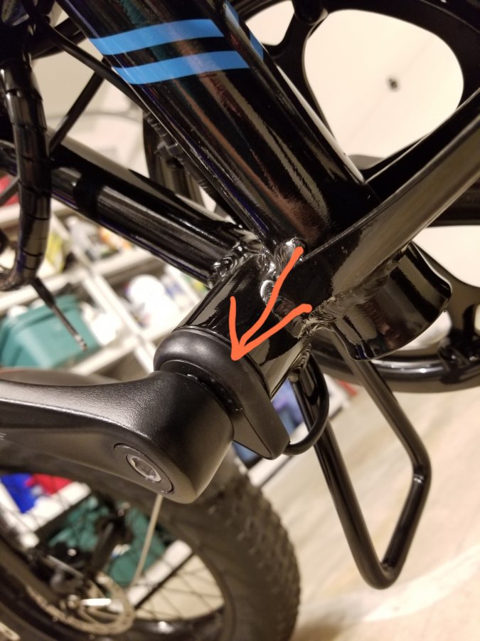

No, that's called a torque sensor and they only come on high end ebikes usually with mid drives. Ours is a cadence sensor. Magnets around the crank with a sensor. Just like a cycle computer uses but with more magnets.
You can see it right here: 38315
Smarter people than me can chime in if you know how this all works together.
You can see it right here: View attachment 38315
Did the red arrow come with the bike? It looks bent. Think you could use the derailer to straighten it?
