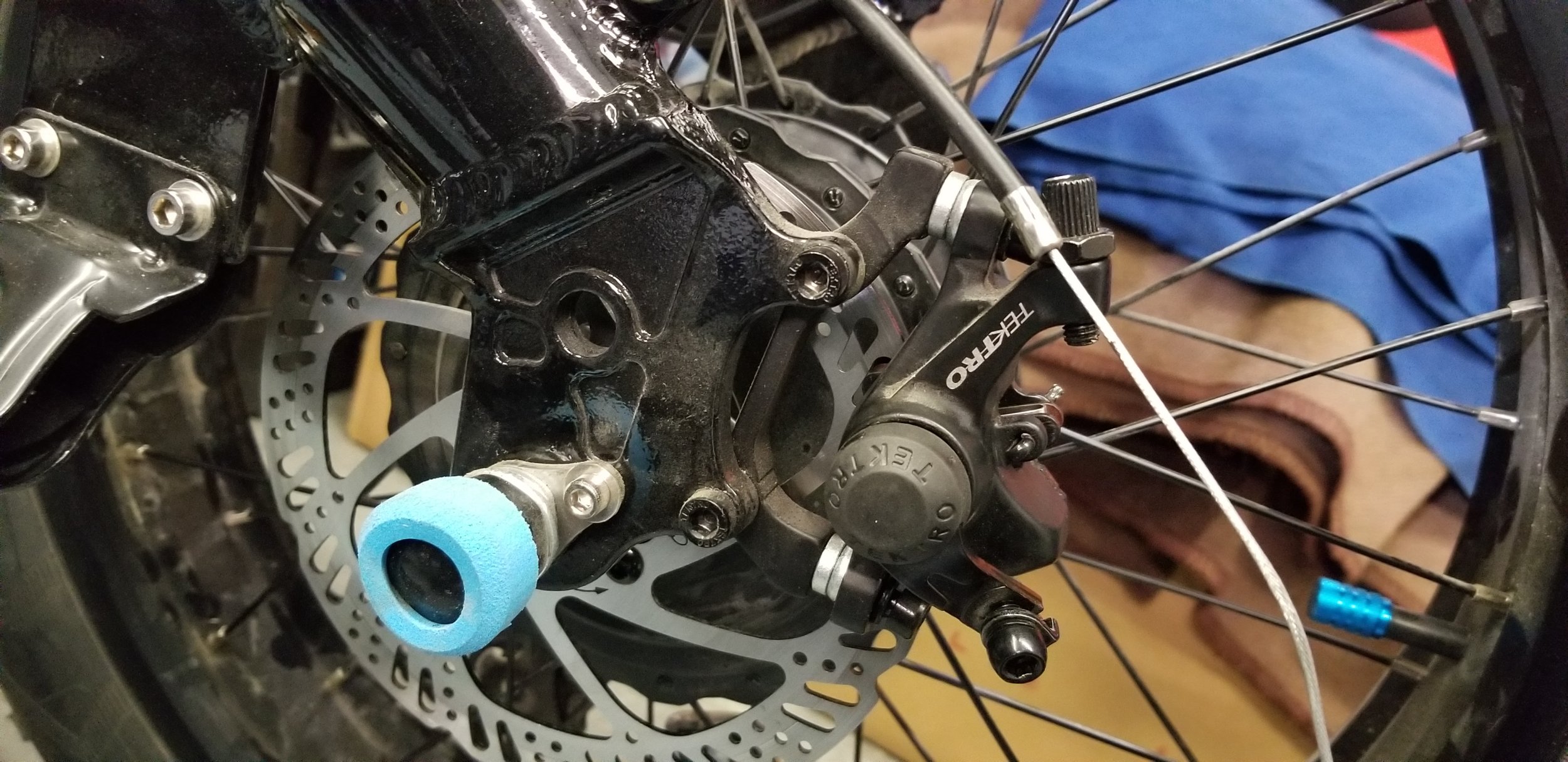

I couldn't get my girlfriend's brakes to stop squeaking. I'm usually good at this after taking apart and cleaning I notice that only half the pad was wearing. It seemed odd. I then discovered that someone at the factory put the wrong spacers where the caliper aliment bolts are. So when you adjust the alignment it's never quite straight and the bolts are too short consequently. Also because the caliper wasn't sitting all the way down only half the pad was contacting the rotor. I removed them and the noise went away I'm pretty sure they didn't belong there as her front caliper doesn't have that and neither do either of my calipers on my XP.
