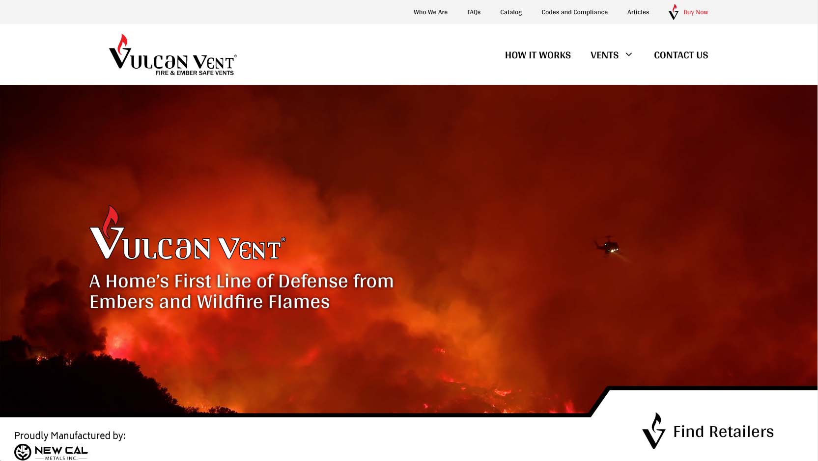

There are also these really cool vents that are fire safe. I make do with screens over all of my vents. Although some of them melted in the 2021 burnover event -- for that matter, some of the window screens melted.
