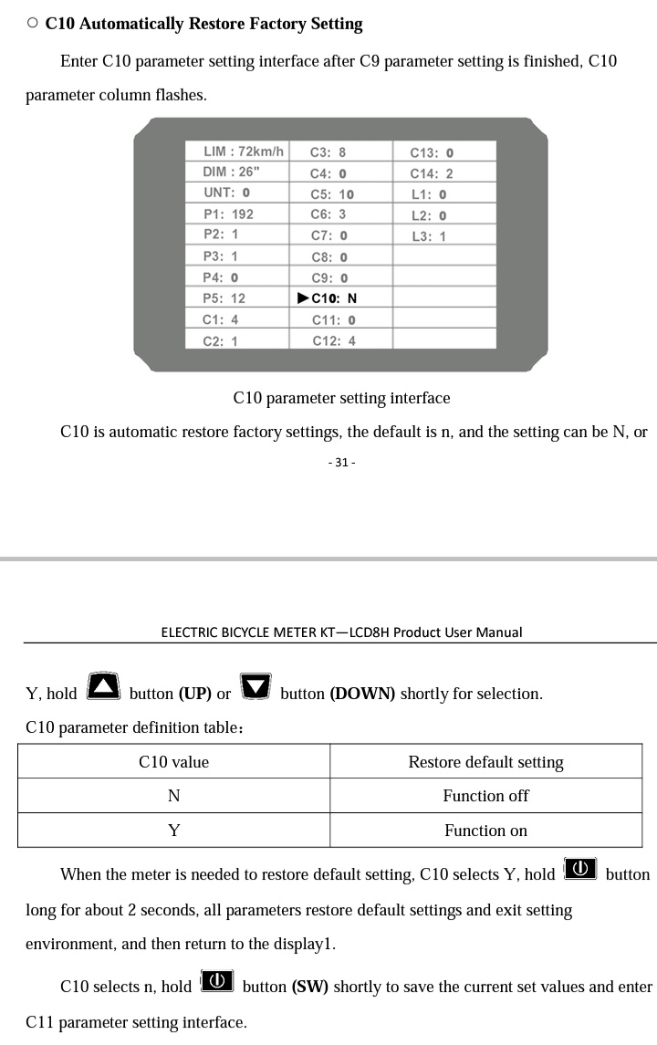

First, realize that the display holds the settings (parameters). If you are bringing a used display on to a different bike, you need to do a reset as potentially MANY of the parameters are going to be incorrect. That's where I would start here. Then see what works and what doesn't.....
I may be able to help at that point.... -Al
That's it. It will automatically reset itself to N after being used once if I remember correctly?
