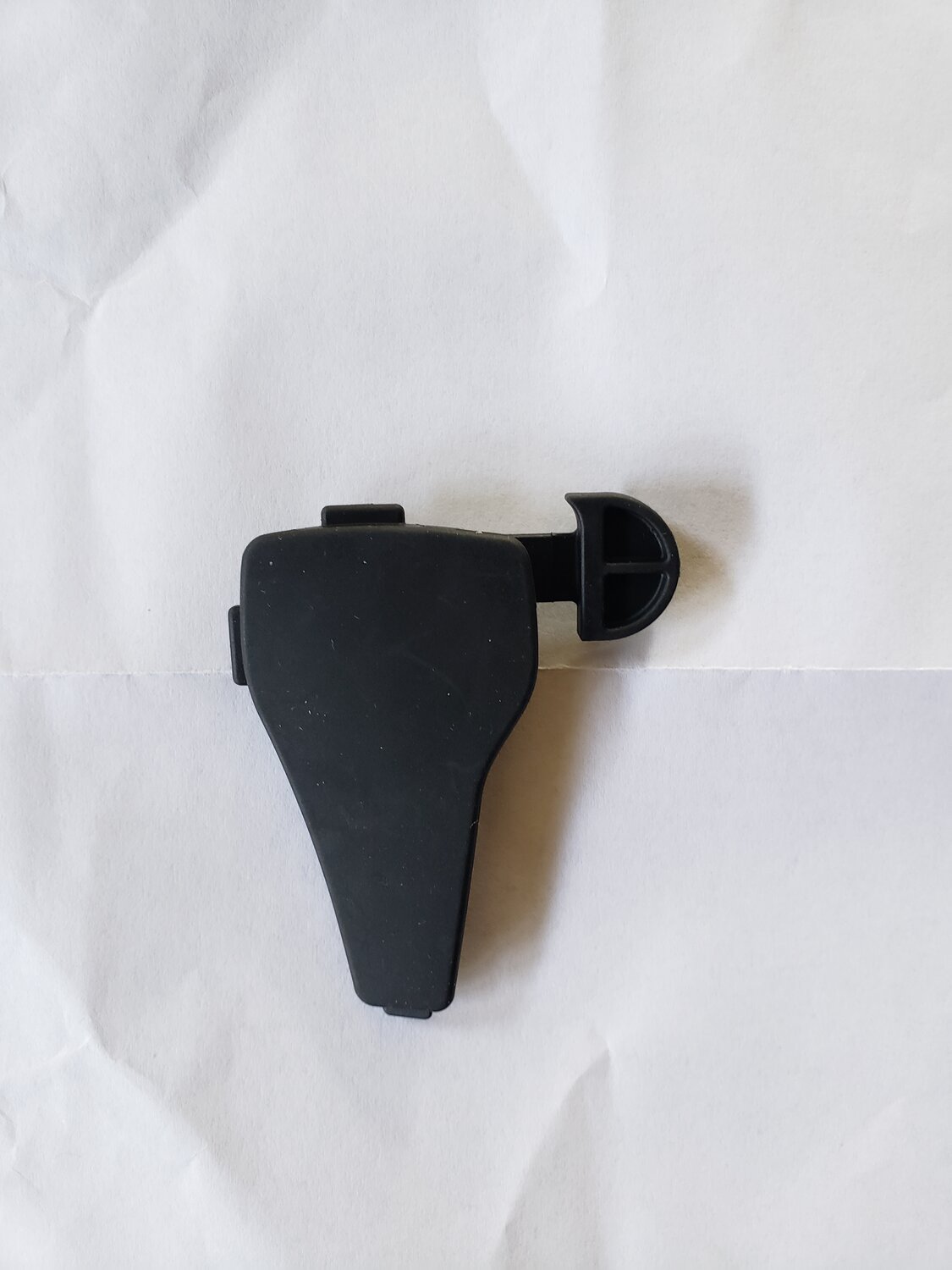

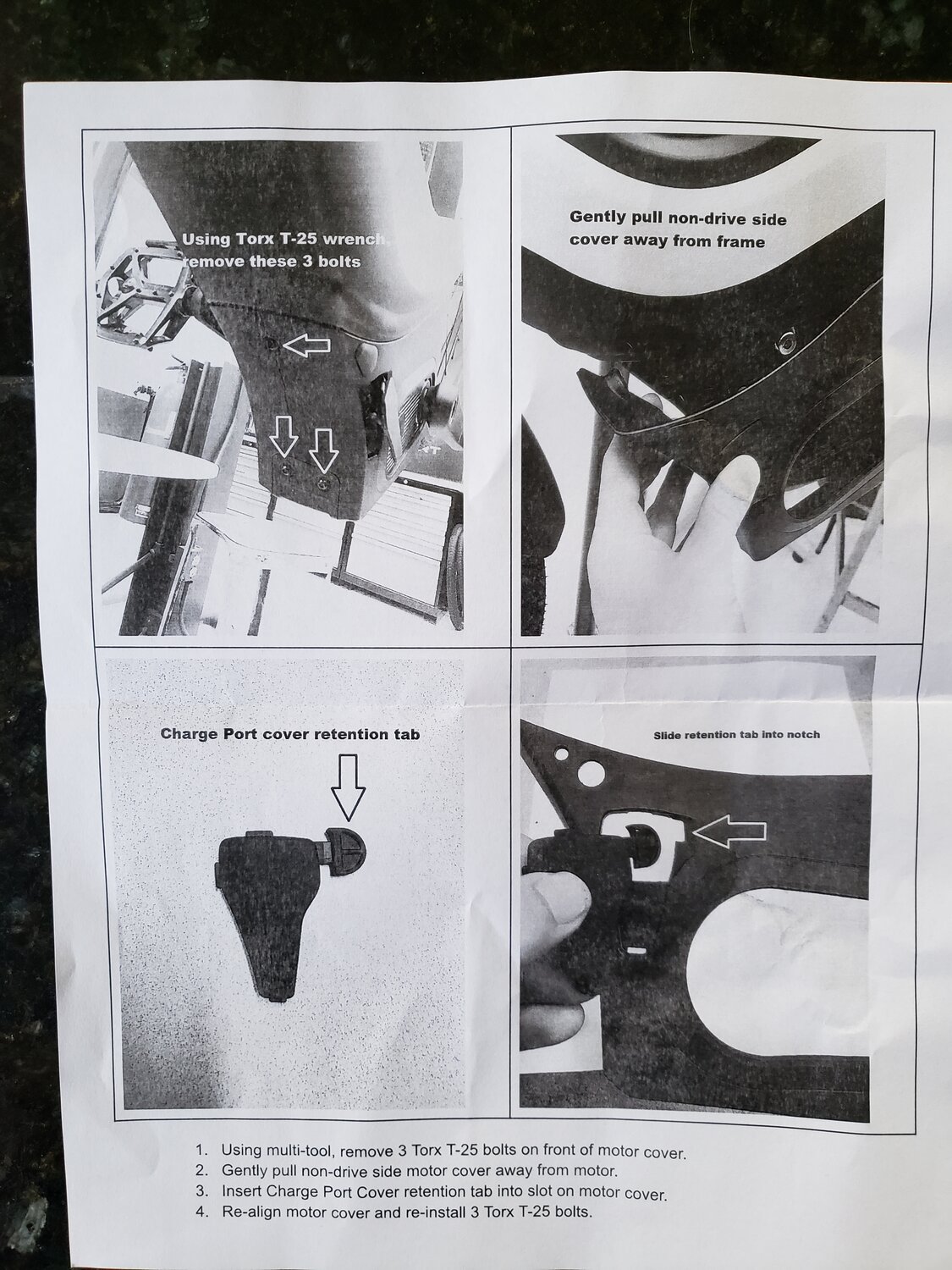

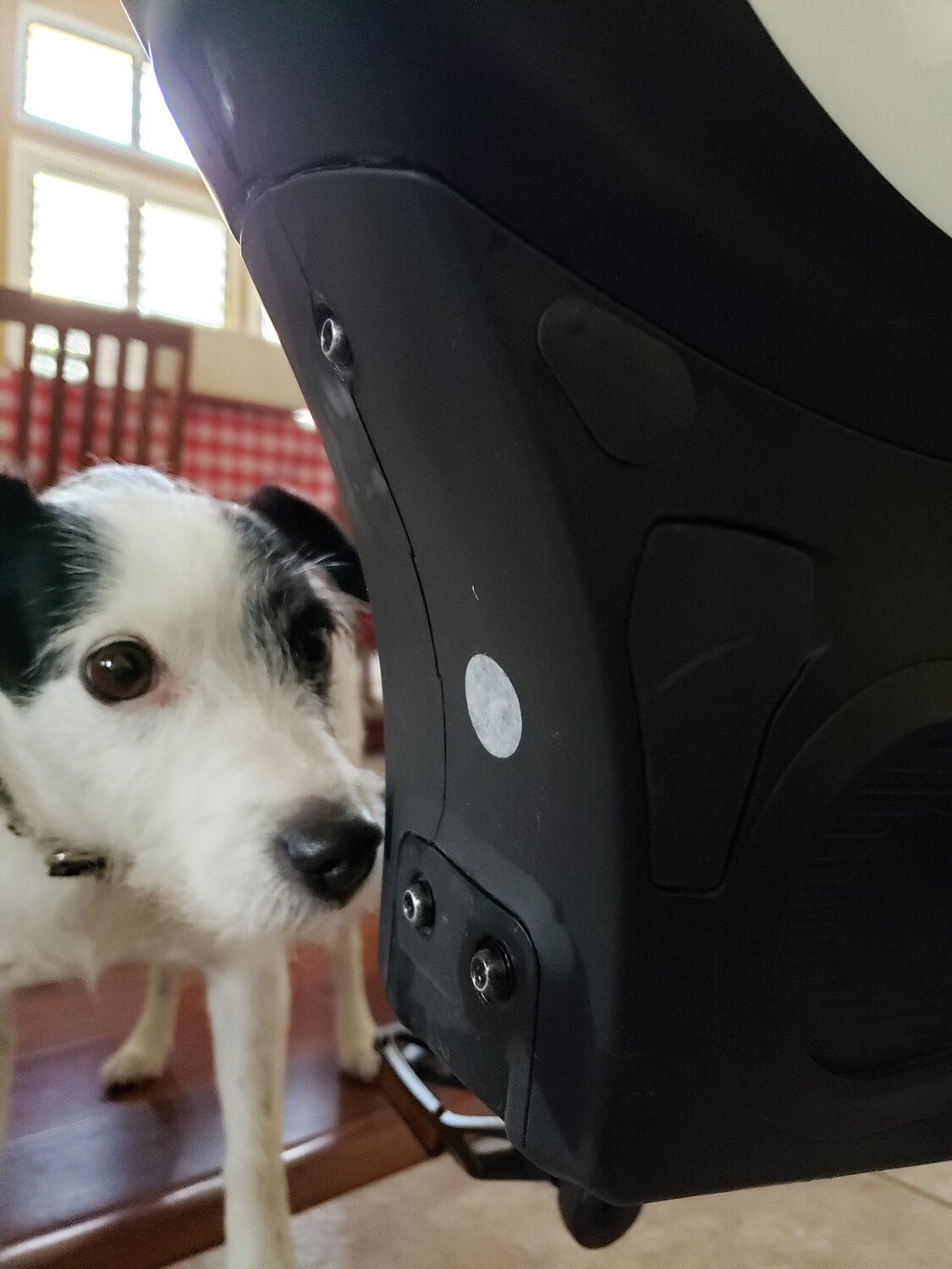

I received the new charge port cover from Serial 1. Looks to be a more robust cover and pics of the cover, installation instructions as well as a close final inspection by my assistant are attached. ;-)

oh snaps! you have to take apart the bike a little to install it. At first, i thought, it just looks like a bigger nub, didn't realize the installation was different. Hopefully the rubber holds up over time or it looks like we will have to replace it from ripping off.
Its a simple install and I am less worried about it ripping off as opposed to just falling out. The previous retainer was a joke (but not funny). I believe moving the charge port up is a better long term solution but this will do for these 1st gen models. Good job Serial 1 and thanks for listening and acting quickly on this re-design.
I don’t know if moving it up is an option as I believe it is a trade off for how low they placed the battery in the frame. Not complaining as it handles like a dream but it might be the best we can get.
I agree it is very comfortable and handles great. The charge port could be moved anywhere on the down tube and would not require relocating the battery but based upon this new port cover, it should do the job for me. The Serial 1 is my favorite bike to ride and I have done nothing with the Enviolo App. When and if when Serial 1 comes out with an App, I might play with the settings but it won't be out of necessity. The bike auto shifts smoothly and silently as I go up and down hills and/or increase pedal pressure. Really a remarkable game changer transmission/drive train that is perfect for a touring, commuter ebike. Makes my excellent electronic shifting Rohloff E14 IGH on my R&M bike seem primitive.
