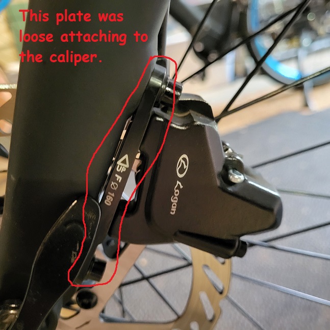

I'm a newer member of the forum with 2 Propella Pros v2 bikes, just what I was looking for in a lightweight ebike, nice ride, nice build and a pleasure to ride. I don't care much for the matt black paint job, but it's just cosmetic. lol
The issue I bumped into was the brake calipers were all loose after 200 miles. I had to remove the calipers to tighten a plate and then reattach the calipers to the bike. This could be a safety issue so be sure to double check the calipers to ensure they aren't rattling off. Coming down a hill and having an unexpected break failure would suck!

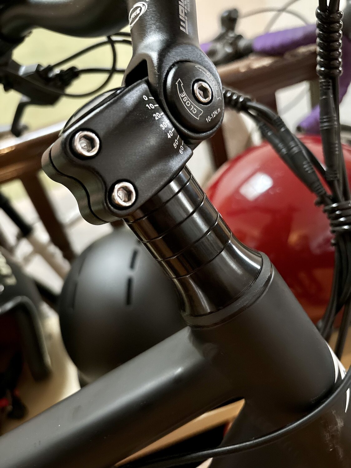

Thanks to OP Ann, Jesse and Blork for some great insights on their experience. I had my 7S v4 about six months now and always felt I the handlebars were low. I am 5’10” so I got the Wake Adjustable Stem but skipped on the riser per Blork’s recommendation. Already feel more comfortable but still testing the right angle for me.
The one issue I ran into was that the top of the new Wake stem was now flush with the steerer. I ended up with the situation on the right in the illustration below.
This is because the base of the new Wake stem is 5 mm shorter than the stock stem. I had to get an additional 5 mm spacer to add on top of the current three 10 mm spacers (see photo).
TLDR If you are buying the Wake Adjustable Stem, you also need an additional 5 mm spacer ring for your steerer.
Hope this helps.

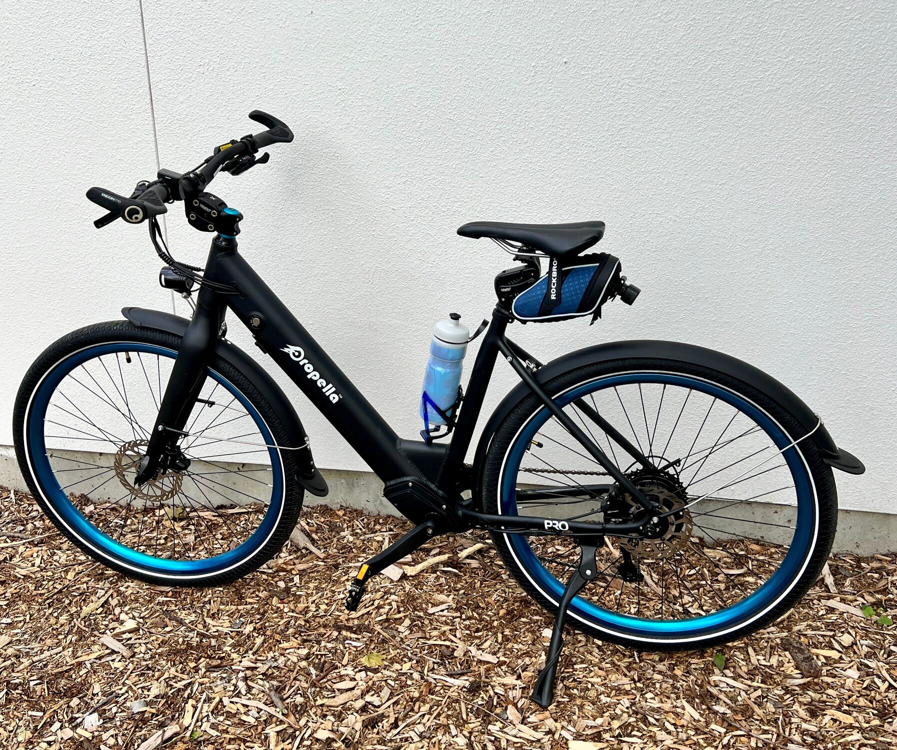

I just purchased a Propella C9 V2 Pro. The bike is pretty comfortable out of the box with it's 2" wide tires. But being 75, riding the mean streets of Seattle, and some easy single track trails, comfort is a high priority to me. Toward that end I purchased a Kinect XR suspension seatpost and Kinect 30 degree suspension stem. They cost about $450 but are worth that to me as they really isolate the jiggles & jars. Additionally I also added Ergon G3 grips & replaced the OEM saddle with a lighter weight Montrose road bike saddle that I have used for years and found comfortable. I am very pleased with this bikes comfort and performance on both the pavement and dirt.
