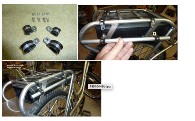

In my case since my handlebars were set to be higher (meaning almost 90% as Eddie shows here
Adding full panniers made the front end wobbly, and adding the range extender made it worse.
By moving the panniers down on the range extender, I fixed the other 1/2. Unfortunately, lowering the pannier on the range extender rack means I cannot use the range extender (photo)

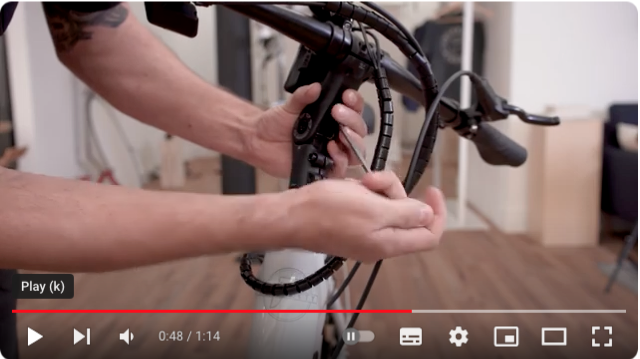

I am adding this solution from @6zfshdb in this thread:https://forums.electricbikereview.com/threads/current-battery-extender.53433/post-611763 to fix it:
By changing the handlebars (a second time :-/) to a backward sweeping pair, I was able to set the handlebar back to all the way forward, which fixed the other 1/2 the problem - I used SATORI NOIRETTE CLASSIC Trekking Commuting Bike Bicycle Aluminium Alloy Swept Back Flat Handlebar 31.8x550mm - Rise 43mm - Sweep 70 Degree and they did not require any cable changes.
