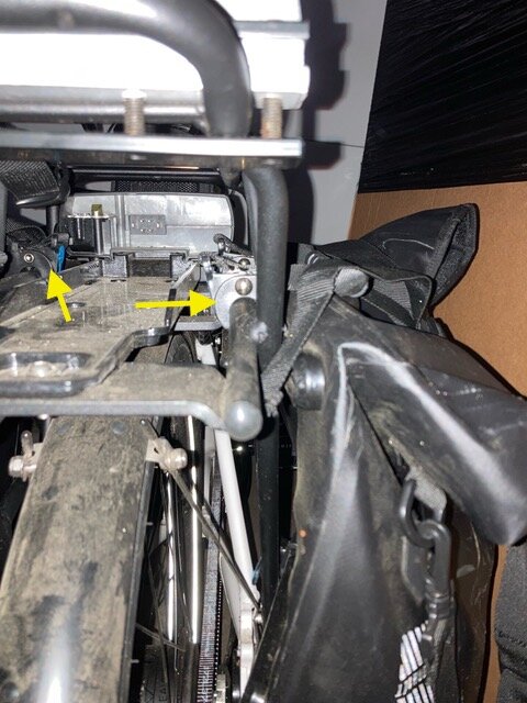

Adding full panniers made the front end wobbly, and adding the range extender made it worse.
By moving the panniers down on the range extender, I fixed the other 1/2. Unfortunately, lowering the pannier on the range extender rack means I cannot use the range extender (photo)

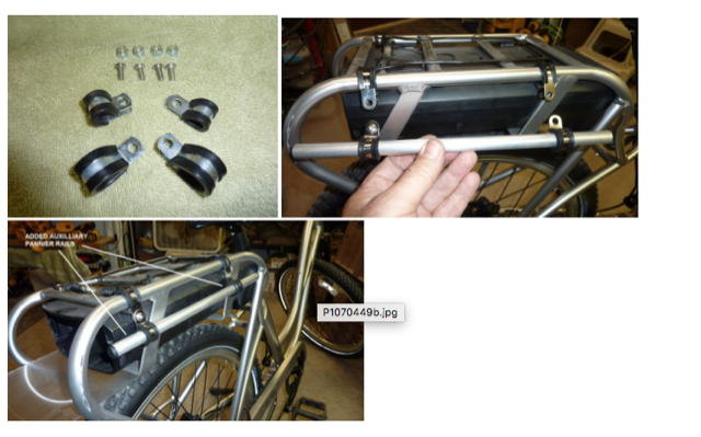

I am adding this solution from @6zfshdb in this thread:https://forums.electricbikereview.com/threads/current-battery-extender.53433/post-611763 to fix it:
