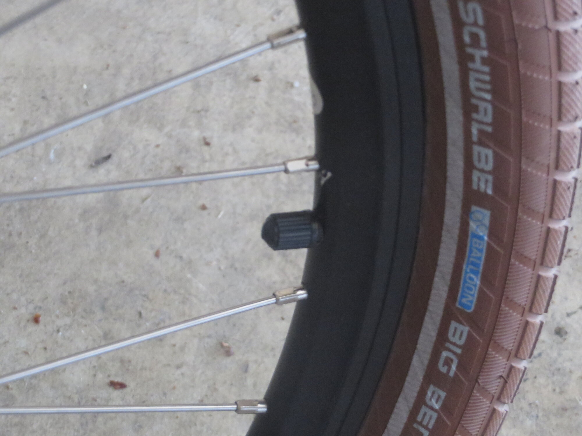

Tried to replace patched tube on front wheel, unable to find tube with stem that will fit thru wheel. Original is a CST 26x1.9/2/125, they are out of stock everywhere I looked. Standard (American?) tube stems are too fat to fit fully thru the wheel leaving most of stem inside wheel pressed into tube - and I think this makes a flat very likely.
The photo shows the replacement tube installed by eBikes USA in Denver. IMG_6477.JPG
The photo shows the replacement tube installed by eBikes USA in Denver. View attachment 54155
Make sure your rim strip hole is lined up perfectly with the hole in the rim. It's called a Schrader valve stem.
