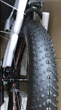

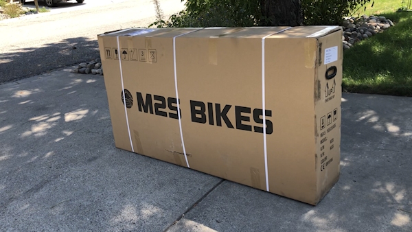

I've had my Kush for almost 3 weeks now and it has performed quite well. It arrived in great shape, was packed snugly, and was easy to assemble and ride the same day after charging. Took me on some great rides in the Pioneer Mountains in SW Montana. I'm a bit miffed by how little battery power I'm using so I'll be conducting some distance / terrain tests ASAP.
View attachment 24882View attachment 24881
