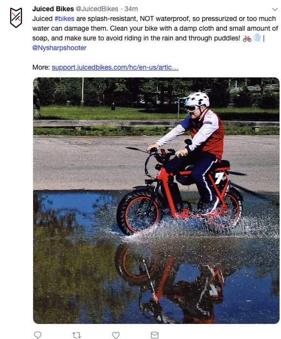

Juiced says not to ride in the rain
WTF?
