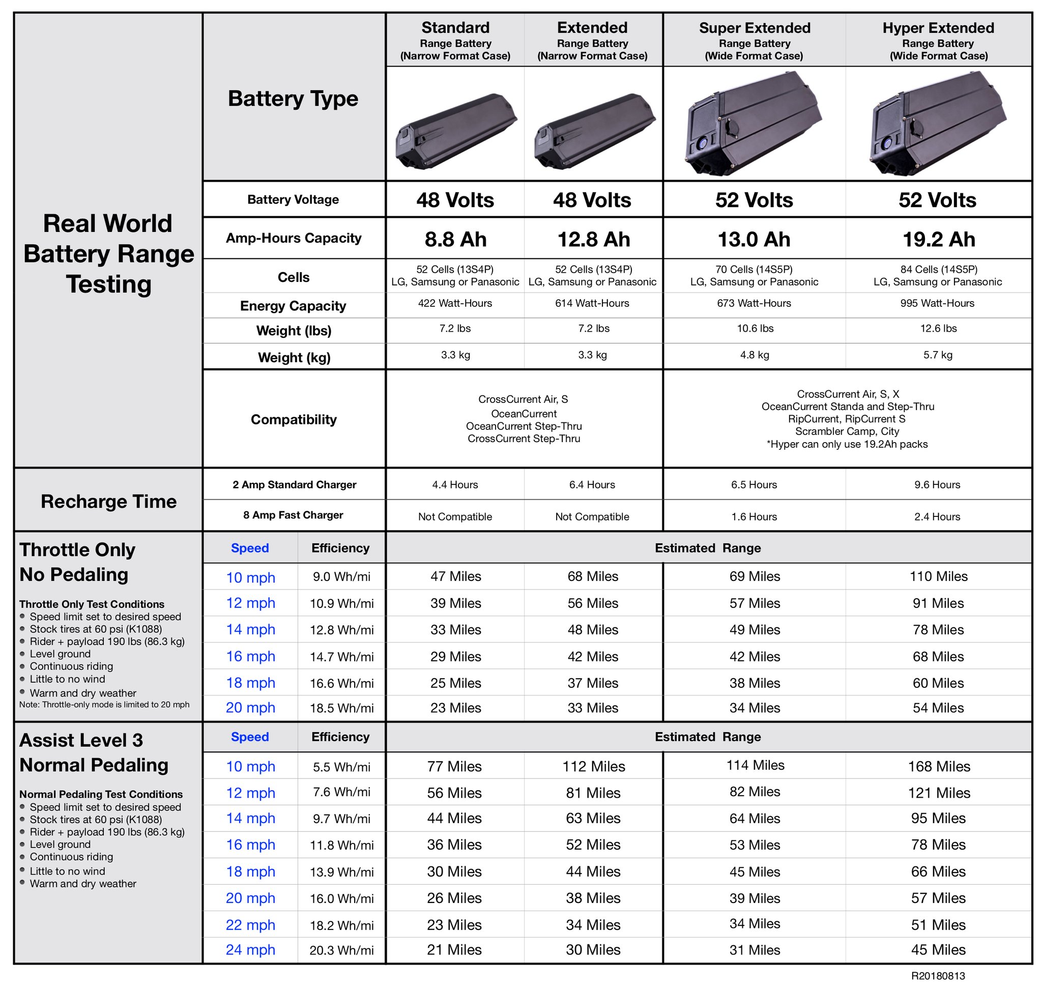

Has anyone ever actually achieved the touted 100 mi+, range of the hyper-extended range 21ah battery on a CCS, on is that just extended hype?
On a warm spring/early summer day, with no headwind, 175lbs rider should be able to travel 100 miles under these conditions.
