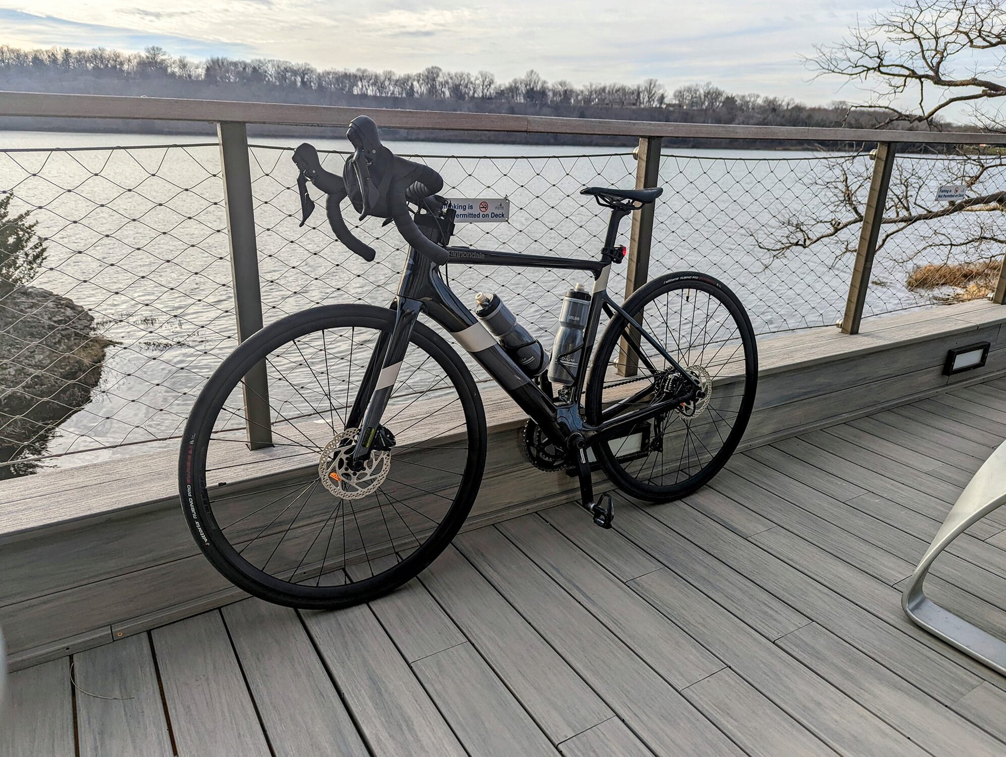

If this question has been posted I apologized. Ok Starting with the Battery I have a 2021 Cannondale Super Six Neo and it just started I looked at the battery status It use to register 100 percent when its fully charged now its 99 percent. Yes I have compulsive issues I am sure its not a big deal I am talking 1 percent but can I make this correction? Also I noticed the battery temp was 81 degrees is this normal this is towards the end of the charge. With that said I love this darn bike I have a pre existing condition and this bike got me back riding with my group again and not worry about getting dropped too far.
Thank you
Hello Everyone If this question has been posted I apologized. Ok Starting with the Battery I have a 2021 Cannondale Super Six Neo and it just started I looked at the battery status It use to register 100 percent when its fully charged now its 99 percent. Yes I have compulsive issues I am sure its not a big deal I am talking 1 percent but can I make this correction? Also I noticed the battery temp was 81 degrees is this normal this is towards the end of the charge. With that said I love this darn bike I have a pre existing condition and this bike got me back riding with my group again and not worry about getting dropped too far. Thank you
Hi sometimes my battery only does 99% but other occasions it does 100%
This is my second battery as first one dropped to low 80s on full charge
