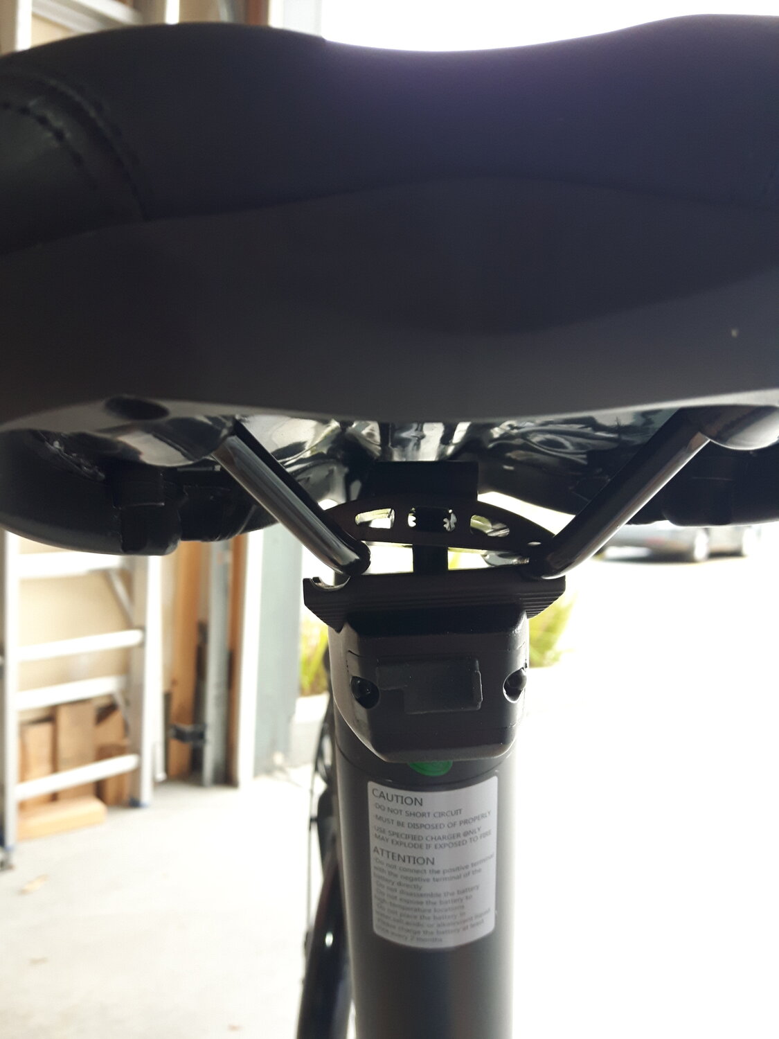

April,I got my bike from Carbro ,CarbroX model , straight stem , basic battery(250W), weight about 29Lb .Bike ride solid , well made , good quality parts .
Slight delate in delivery because of not available upgrade parts .Ride had been smooth & solid ,motor noise is low in lower power (1-2).more noise from 3-5;max out in 16m/h .only initial sqk noise was coming from the belt ,after a few customer exchange
w WD40 resolve the issue. There is still occasional noise (unknow origin ) from the bottom bracket I cannot 100% local where it is from . Otherwise , bike ride very smooth
very easy to fold compare most of other folder i had . This is indeed lighter & easy to carry up ,in & out of the car or any maintenance. I upgrade carbon handlebar & lighter bike peddle removed bike stand .The Hydraulic brake is good .Seat is upgraded to lighter .Through & Through it worth the price for a Carbon frame & fork !so fast custom service .They have some video support from their forum. Wish they have parts like the empty seat post which has a very large 46mm DIAM (u cannot find any adaptor ring for it ) need custom 3D print ,if anyone can help me make one ,willing to pay ,let me know . so I can use a much lighter seat post to drop the bike weight to 27lbs,for a regular bike riding . There are a few other companies made used a similar frame but I don't think they have a carbon folk .
