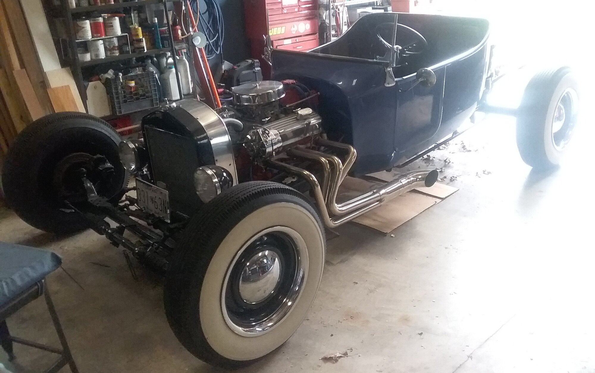

The reason my build looks clean, is because I retired from 35 years in yacht repair and build "hot rods" as a hobby. Here is my latest...

The reason my build looks clean, is because I retired from 35 years in yacht repair and build "hot rods" as a hobby. Here is my latest...View attachment 77148
looks like a badass ride. I get a rush just lookin´at it
