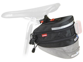

I have that in the old style strap on variety. And I have the Kinekt. I had to add a velcro extension to the seat post front strap but it works fine. The Kinekt going up and down does not create any problem that I can see.I ride with a kinekt and find the Rixen Kaul snap on saddle bag to be the roomiest most accessible and quickest to mount and dismount. Reasonable priced as well. There are several models. This one with the expandable zipper gets really roomy. No front attachment to fuss with either.
KLICKfix Micro 200 Expandable Bike Saddle Bag 0295S
KLICKfix ▶ Largest Rixen & Kaul saddle bag with expandable design for more capacity (1.5 to 2.0 L). Wide opening for easy access. Incl. saddle adaptor.www.bike24.com
