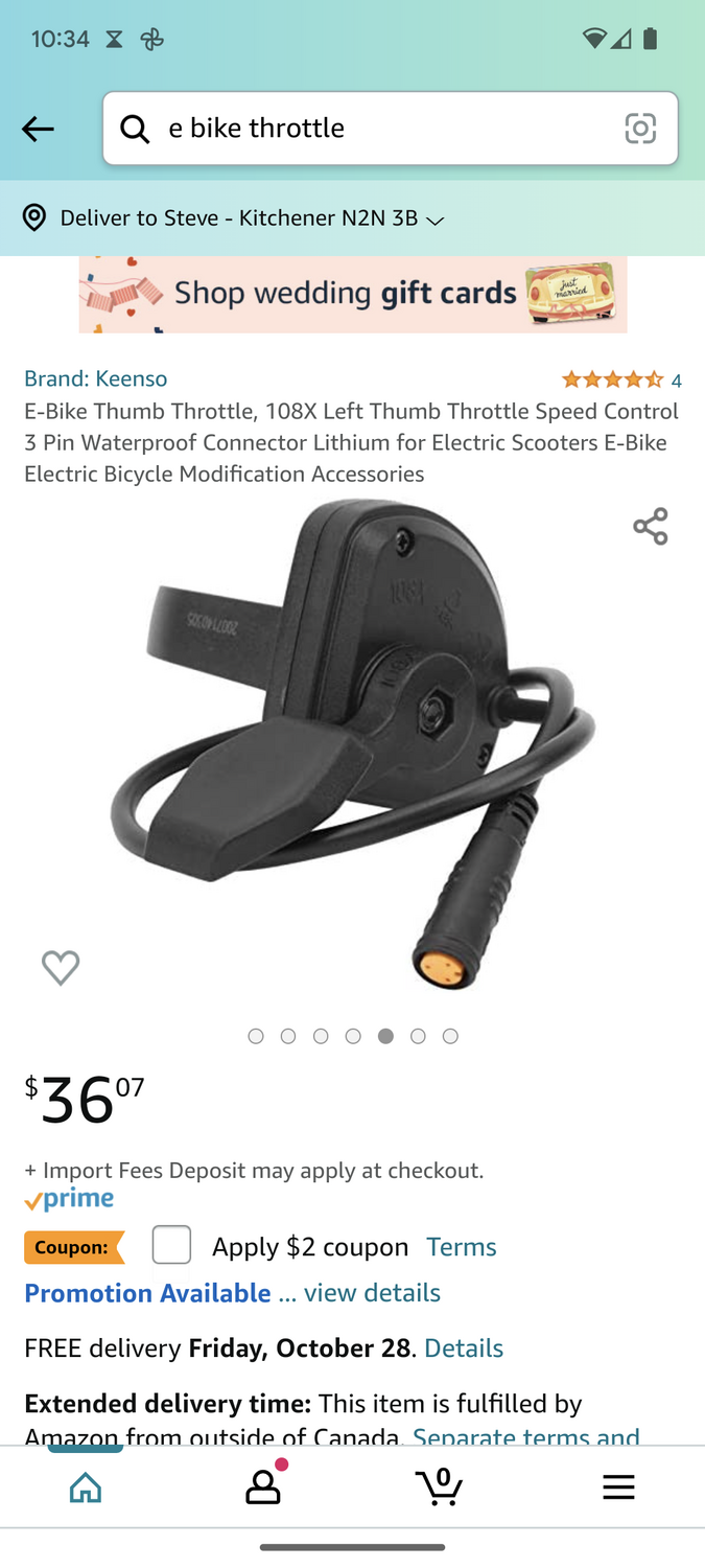

sorry I completely forgot to update this post. I ended up finding a good one on Amazon and it works amazing and works with the connectors that I have
https://a.co/d/djaUi2L
it works really well and I actually like this way better.
