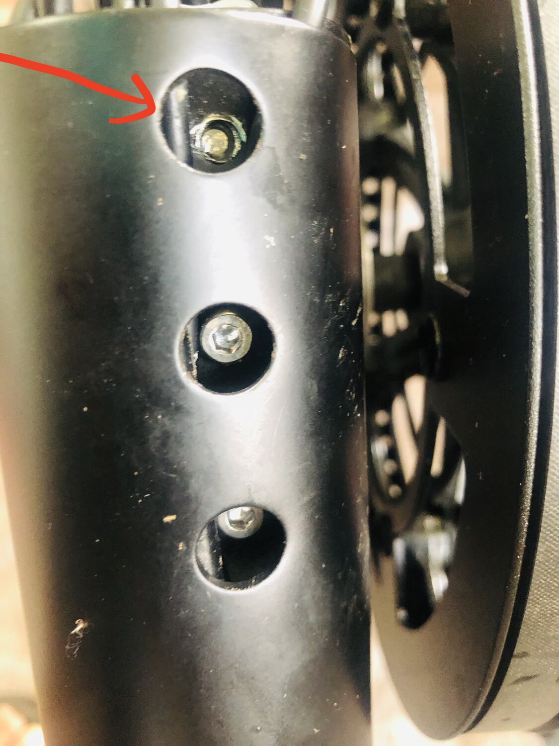

Yes i reached out to them, but to get them speaking I had ssweat a lot. They were on total denial that controller was the issue. I had hardly used the bike for 50 miles since purchased it. When I started looking into how the controller or the battery can be removed to my shock I found that they had shipped the bike with a broken bolt. It took several weeks for me to convince them as each customer support person who responds to the email start the thread back from the beggining. I posted the pictures and videos and finally they got convinced and agreed to send the replacement part, but I had to pay 90 dollars which they say is refundable after I send them back the removed part. Now my challenge is to remove the broken nut. They have promised to pay 50 dollars towards the labor if i take this to any repair shop. I still have to see where to get this done. Overall it took more than 2 months to receive the part and as I live in east cost the clod air is already making its way, I lost precious 2 months of biking.
