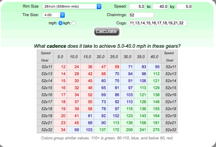

Just curious GeeMac if you have modified the standard gear ratios in your bike?

Hello JRA. I have not not made any modifications to any part of the bike. I purchased the large size HF1100 in Oct 2018. The MAC motor also has a 9T paper sticker on it. It does what it does according to my physical input. My numbers are not a computer generated simulation, they are real, in the field actions. Our tech people tend to forget that simulations are not real. They are best guesses at what can be done given the variables that are incorporated into said simulation.
I was just curious as my personal observations of being able to pedal with effective input at those speeds on a bike with much narrower tires with a similar wattage motor and a higher gear ratio available is a bit different. However a computer generated simulation does support your in the field actions:

I was only speaking to the rhetoric in reference to my initial post, not to the validity of sim stats. I am not an engineer or scientist, just a critical thinker. I ride my HF1100 daily, so thought my input could be informative. Nice stat sheet by the way. Very colorful.
