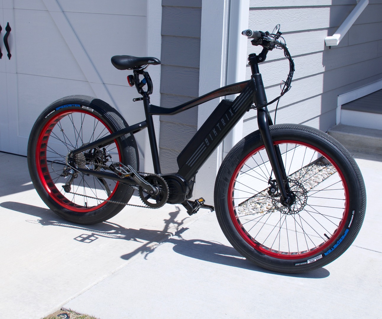

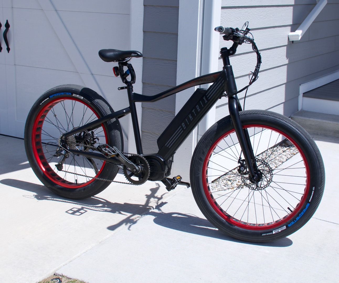

I had my handlebar backwards in error and fixed it, but now that it is OK to do it, I might switch it backward again for better reach as suggested. I also moved the included rear light to the back of the rack so it is more visible when stuff is on the rack. Did you have to cut the grip for the mirror? Are you going to put on the front fender? Rear basket looks good! Thanks for sharing.
It gives it a motocross type handlebar position that I like. Just had to punch a small hole in the end of the grip and you can't tell at all, it was aftermarket. I had a problem with mounting the fender with the fitting on the bottom of the right shock tube. I think I'll just attach it with a self treading screw. Not the most elegant solution , but it will work.

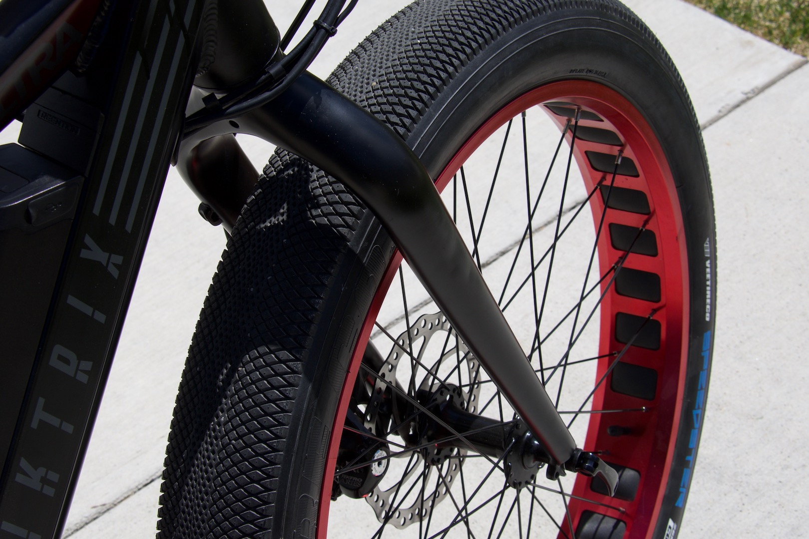

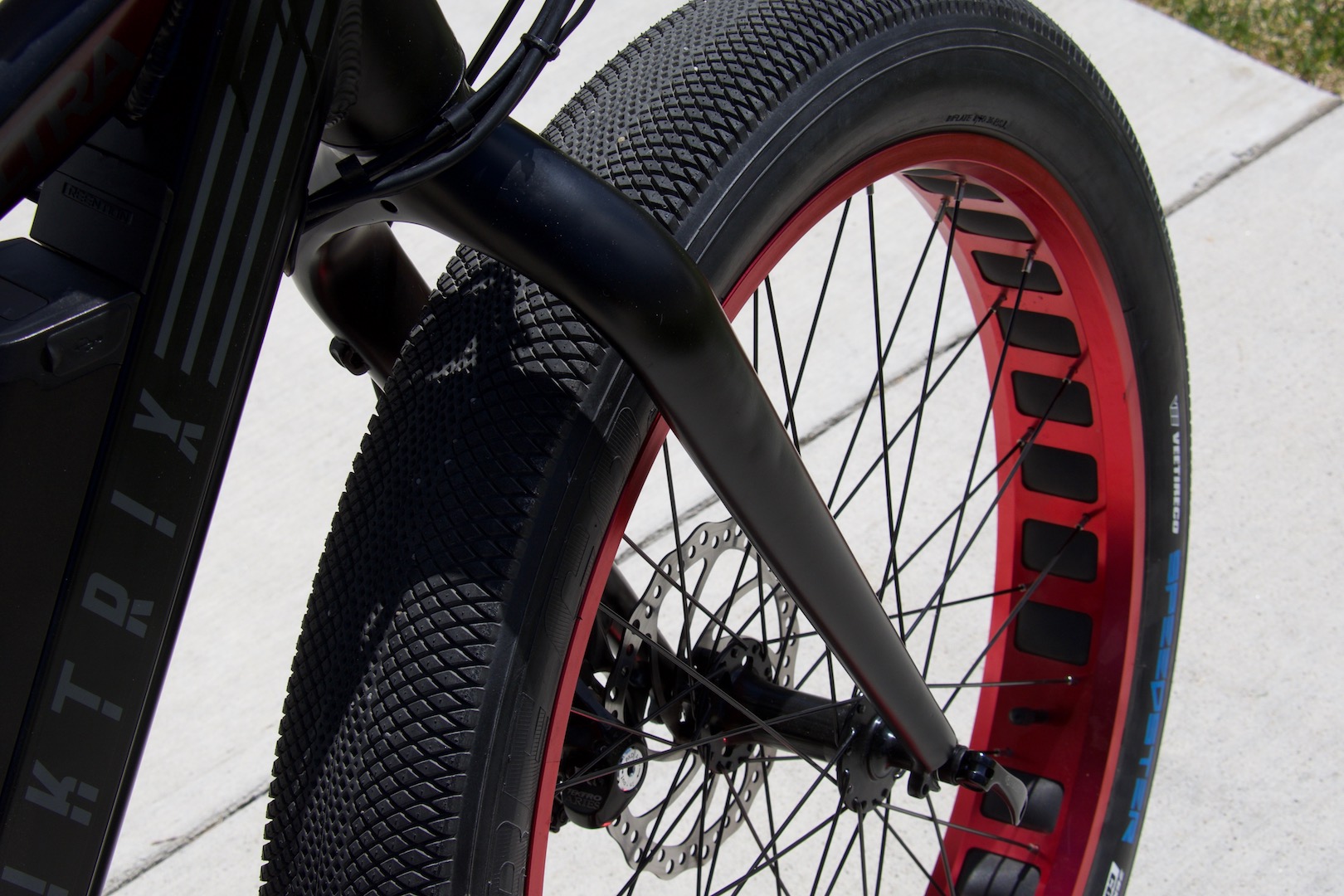

I like the bags a lot. And the seat looks comfy. I couldn’t get the front fender installed correctly either and I like the look without it even better. I could get both brackets installed under the forks but the bracket that went under the non-allen bolt was flush up against the side of the tire. Instead of bending the bracket out (and probably mangling it in the process), I just removed it. I’m not taking her off road as of now so I’ll be OK without the front fender. However, I am looking for some sort of guard to put over the mid drive to keep debris from front tire off it.
[QUOTE="I could get both brackets installed under the forks but the bracket that went under the non-allen bolt was flush up against the side of the tire. Instead of bending the bracket out (and probably mangling it in the process), I just removed it.[/QUOTE]
I had the same problem. The wire stays were holding the fender crooked. I gave a couple tugs on those wires and presto - the fender is straight. The wires bend easy and once bent stay in place.
