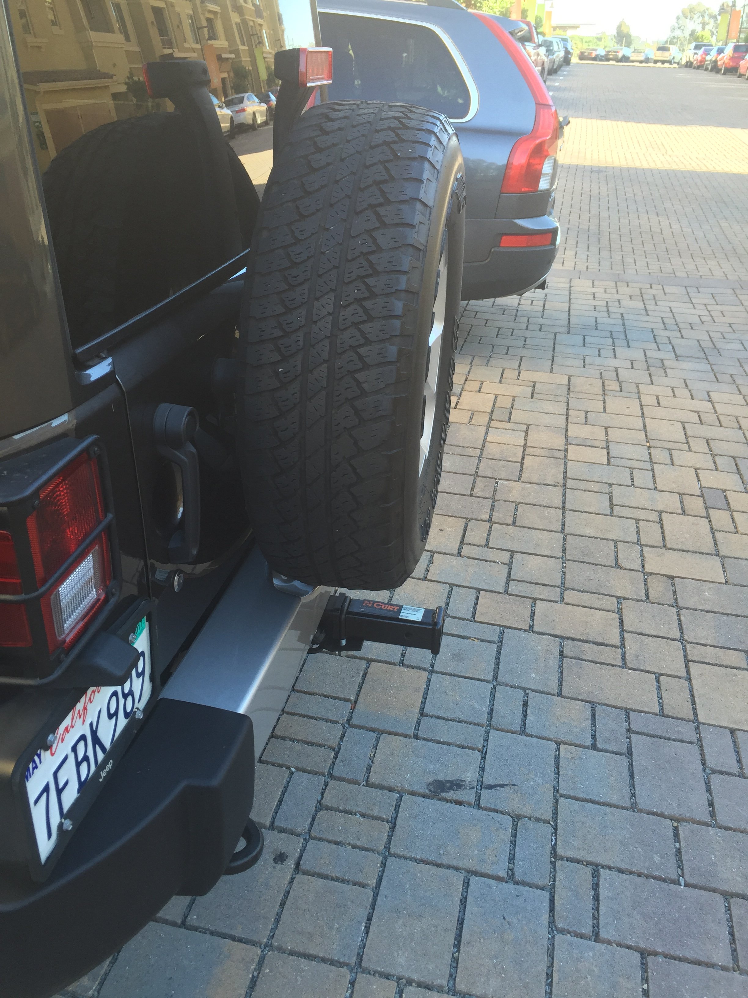

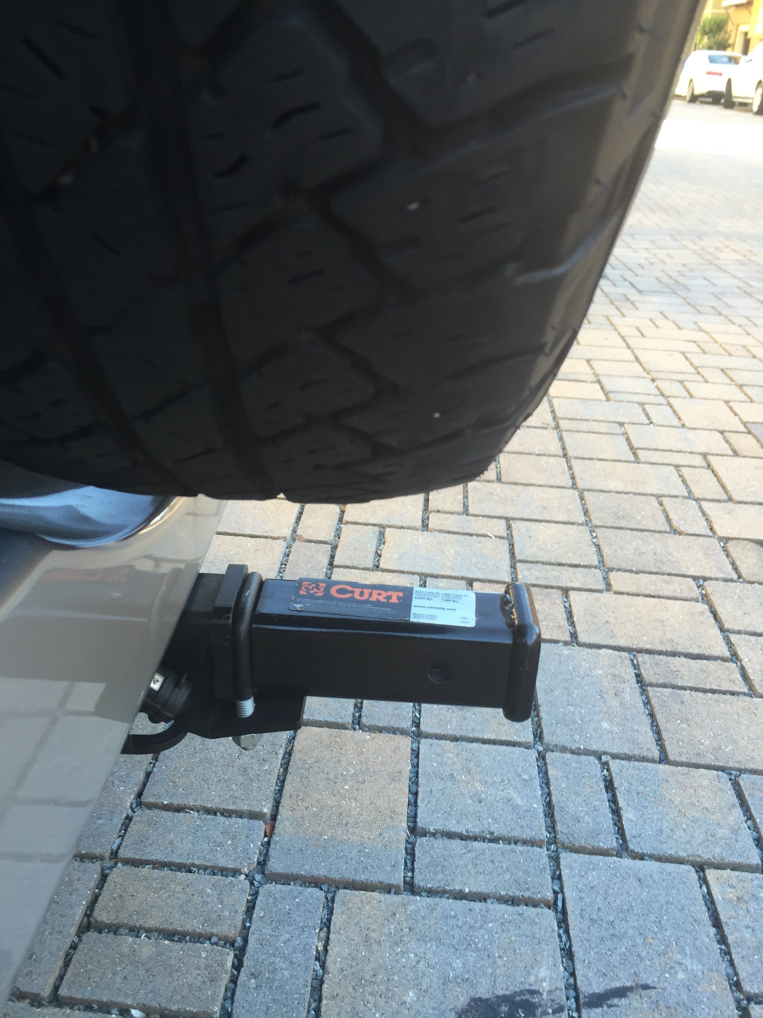

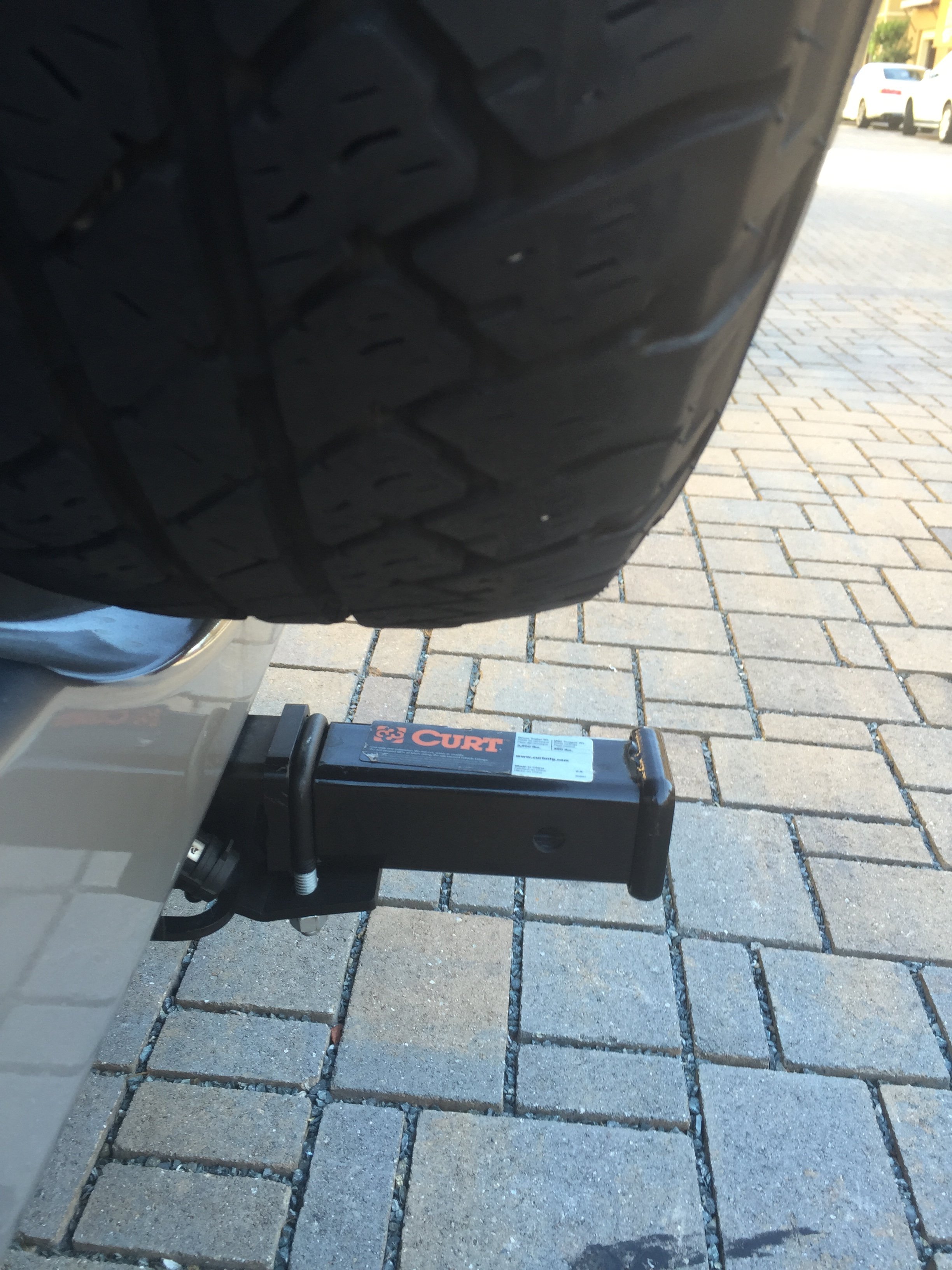

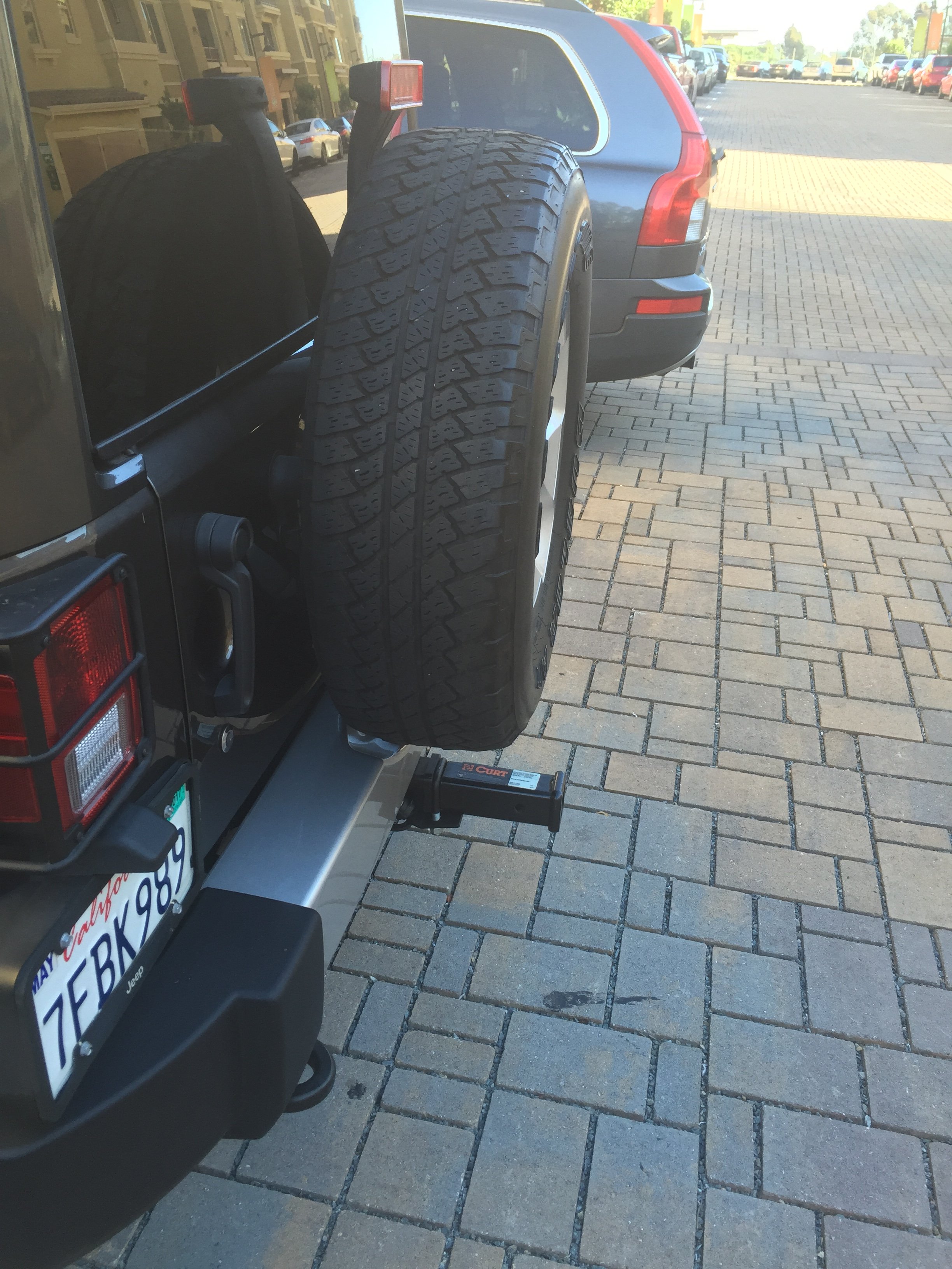

I have looked into the Kuat NV, Thule T2 Pro, Yakima, etc. The issue that I am having is that from the hitch pin hole to the outer rear tire I have about 12 1/2 or 13 inches of space being occupied by my tire. I have attached a few pictures to illustrate whats going on. I was told that the Thule T2 classic would work, but it may not support the weight of the ST2 bike.
I don't want to remove my spare tire for obvious reasons but I need a solution to transport my bikes too~ Suggestions would be appreciated~ Thanks~

I have a 4 door Jeep Rubicon, the issue is that my Jeep suspension was modified and upgraded, also, a lift of 3.5 was done and 35 inch tires were installed, so the spare tire in the rear tailgate is a bit larger than a stock tire which occupies more space. It's a 2 inch hitch, from the pin hole of the hitch to the outter rear tire is about 12 1/2 to 13 inch and I have about 4 or maybe 5 inches of space between the tire and the hitch line... So not much to play with... Unless of course I remove the spare tire but that won't be a smart idea of course..
As Smitty mentioned you have to 1/2 the load when using an extension. In your case and 8" appears it will work. So with a 2" receiver size this means 300 lbs/2 = 150 lbs. With a 150lbs calculate the bike weight (even better if you transport with the battery out of the bike), the bike rack and the extender. So looks like all will be OK based on the info provided.
