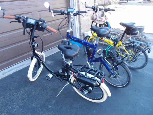

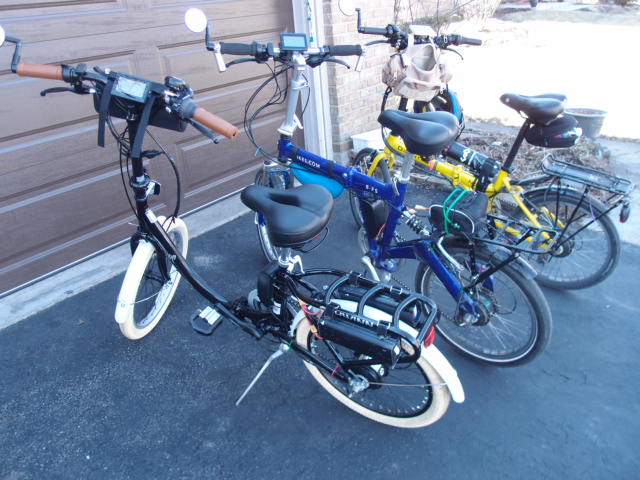

The LiGo's would work. I run my folding fleet on a mish mash of 36V batteries, although mine are 200-300WH. At 190 pounds, I use 10WH/mile. I would need two of the LiGo's to go 20 miles. If I needed the airline portability, I would run them. Probably three per bike.
For a commercial folding e-bike, maybe look for one with a easily removeable external battery. You'll need to fashion a wiring harness with connectors for the LiGo's. THese are all DIY conversions.

If you notice, none of harry's small bikes have oversized tires on them. You won't do yourself any favors with the resistance of oversized tires with a tiny battery.
Yes you are right.
Maybe Lectric and RadMini aren't a good options... They are over 60 pounds and have powerful motors.

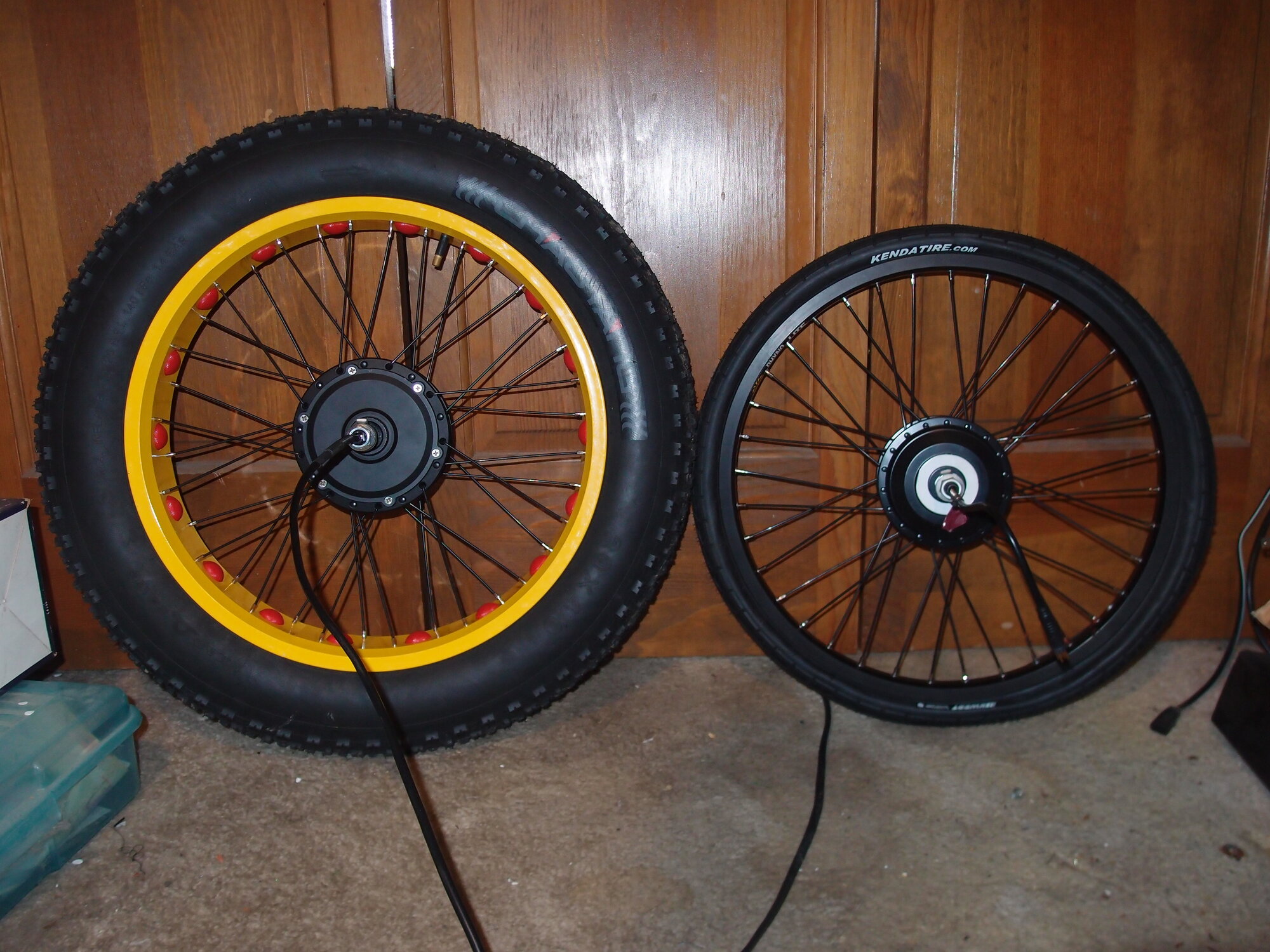

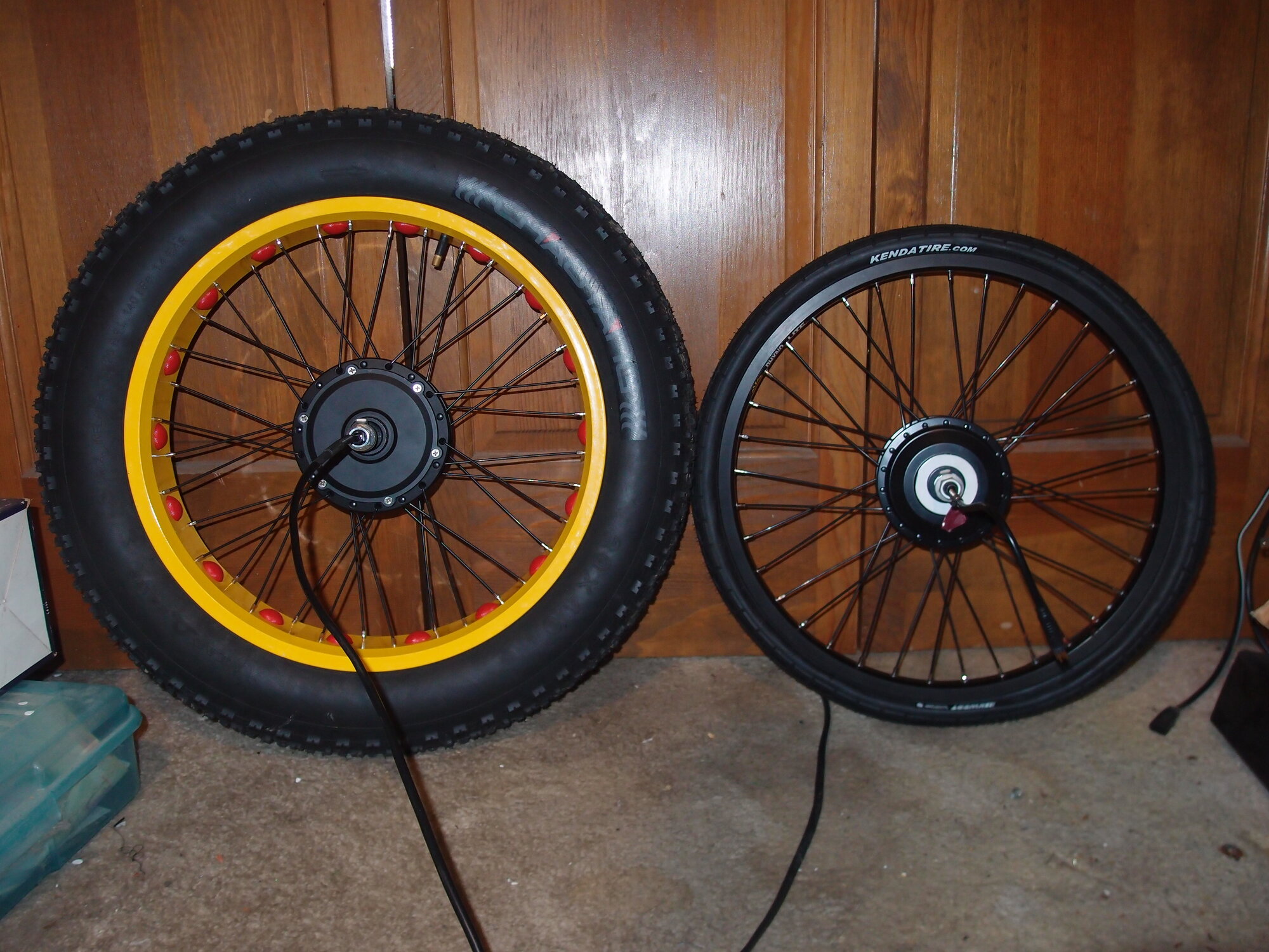

Radmini and Lectric XP are 48V, not 36V. So that's out. You could find a 36V fat tire folder. They're heavier bikes, 2X heavier than mine, but if you ride them slow, under pedal assist 1, you can get close to 10-12 WH/mile. I also have one. They're not the kind you really want to carry onto public transport.
Look at the difference in tire sizes. I built these two wheels a year ago. It's true that 20x4" is comfy, but it's like a fullsize bike.
Maybe a folder with 20x2.1" tires would work OK on Cuban roads.
Wow. Can't believe those are the same size rim. Thanks for the picture. I can really see the difference.
I did not know I could not use 36V battery to replace 48 V battery. Good point.
