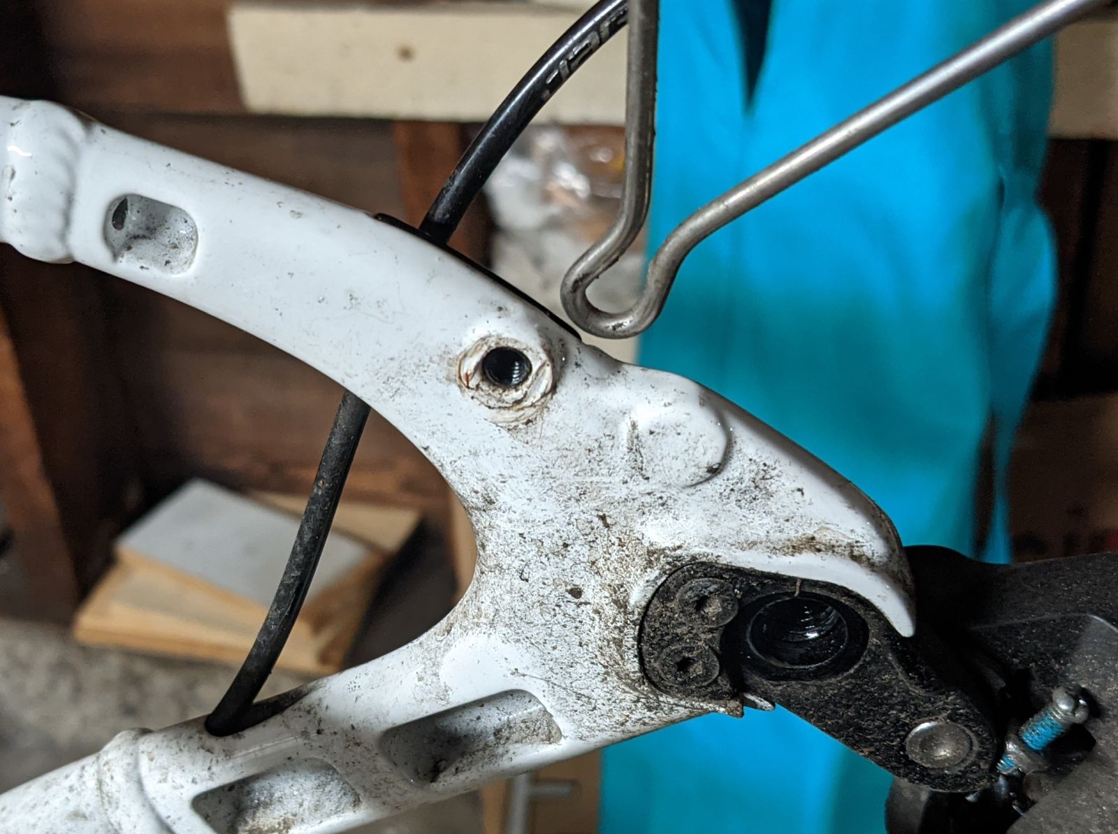

I am trying to add a rear rack to the Yamaha cross core. There is an eyelet in the inside of the rear frame, which has a fender screwed. There is a black triangular patch on the outside. I expect it is the cover of another eyelet for the rack. I have tried the hardest to remove the patch with no success. Any tip about this? I am not even 100% sure if there is an eyelet under it. So I avoid using force to remove it. But looking at its sibling Cross Connect, it seems to be in the right position.
There is definitely an eyelet under that piece. If I recall correctly, there is a screw that you'll need to remove from the inside of the seat stay. This is much easier to do if you remove the wheel. You'll need the clearance to work anyway.
edit for clarification: There is only one eyelet but it can accommodate the fender and rack mounts. On my urban rush, I have the fender struts mounted inside of the seat stay and rack mounted to the outside of the seat stay. You will need to be creative about bolt lengths and nuts to properly secure both.
Thank you. Taking the wheel off helps. I have made some progress. But still no luck to pry it off. Furthermore, I scraped some paint and found that the black piece is made of medal, not plastic.
You’re more than half way done taking it out! You just need to push it out from the inside. Something like a nail will work.
I pushed it out. Thank you. I would not have tried so hard if not for your tips. It is one piece of metal with a threaded end in the inside.
Turn out this is not the only difficult one. The plastic cap in the on the upper part of the seat stay won't come out either. I ended up tearing the cap but the rest stuck in the thread like an anchor bolt. I tried drilling and pulling and all other ridiculous method to extract them. Took me at least an hour to get one out. The other one was dislodged and felt into the tube.

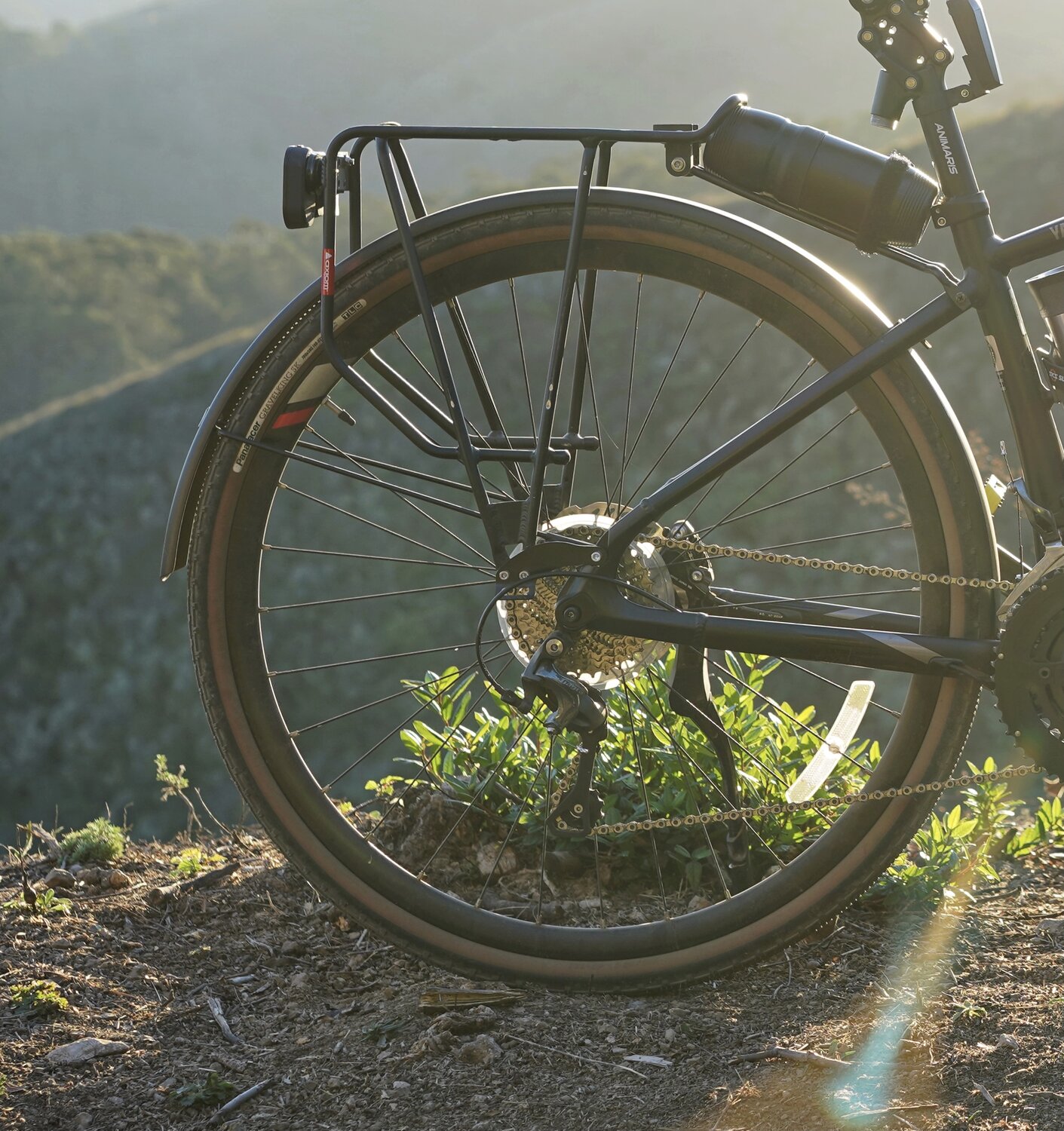

Hey Dude, What rack is that? and are those Yamaha OEM fenders? thanks
Rack is a Axiom DLX Streamliner disc and the fenders are SKS EDGE AL 46 aluminum fenders. I love the rack. The fenders look great but it was a chore to fit in the rear. I had to fabricate a spacer out of aluminum tubing because the eyelet behind the cranks was set in too deep.
Rear rack is nice, thanks
