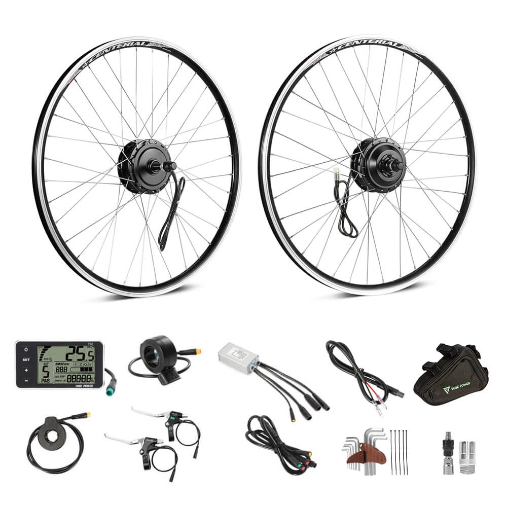

Since you’re in the EU, consider a 250w hub motor + battery kit from yose power in Germany
This was for my wife's Trek Pure but geometry is similar to Townie.
Yose power has a 250w hub motor for €209, and €239 for a battery with cargo rack and tail light. Rack has room for the controller too. We already have V-brakes, so I think we're good there. Do I need anything else? Just curious- will the 350w rear hub work with a standard 7 speed shimano cassette? I don't know why, but the idea of front wheel drive seems strange to me and it'll be better hidden in the back. However I have no idea how compatible this stuff is.
The Yose kit takes a threaded freewheel - looks like a cassette but different design. Also, the Townie might be equipped with a threaded freewheel so you could just move it over to the new wheel. You'll need a special tool.
Here's an example of a threaded freewheel at Amazon: Shimano-TZ500-7-Speed-14-28t-Freewheel
All that remains is a battery and you're good to go!
Yose power offer kits for both rear wheel types, freewheel or cassette which is helpful to have the choice
