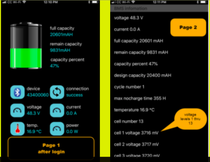

Any smartphone. Android or iPhone. Here's a crappy screen shot, but you can make out the info available.What device do you need in order to use it?

Nice..you can see the difference between cells. That is your beater battery?Any smartphone. Android or iPhone. Here's a crappy screen shot, but you can make out the info available.

No, it's the same as I support for an online reseller. But I did buy a 36V 17Ah 35E for my new MAC and folder.Nice..you can see the difference between cells. That is your beater battery?
