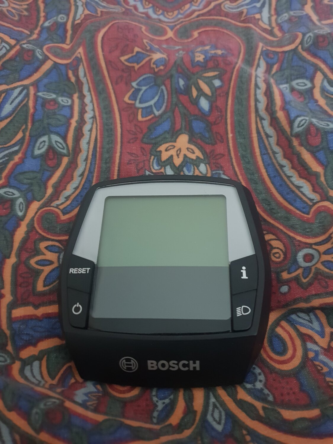

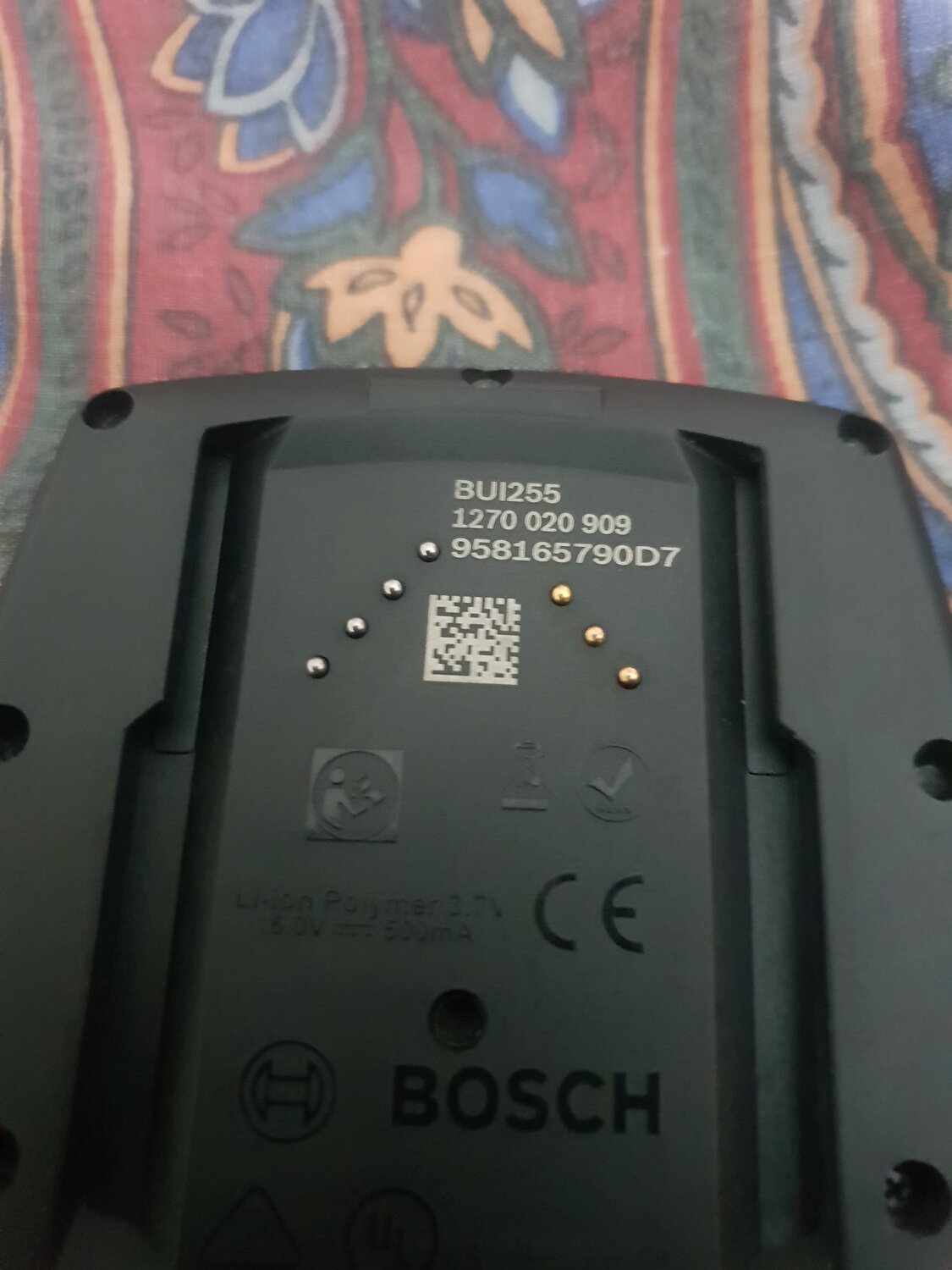

Hi
I have had a problem with my bosch intuvia display on my Raleigh lotus tour.
Attach to bike would come on the display & it would then turn itself off & wouldn't come back on & the battery wouldn't work.
I took the bike to my local Raleigh dealer & they told me it was a problem with the display & I needed a new one,so I bought one & the same message attach to bike would come up & the display would switch its self off.
I have taken the bike back to the dealer & also contacted bosch ebike UK.
Could anybody on here help? Thanks

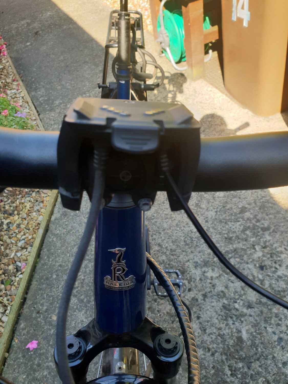

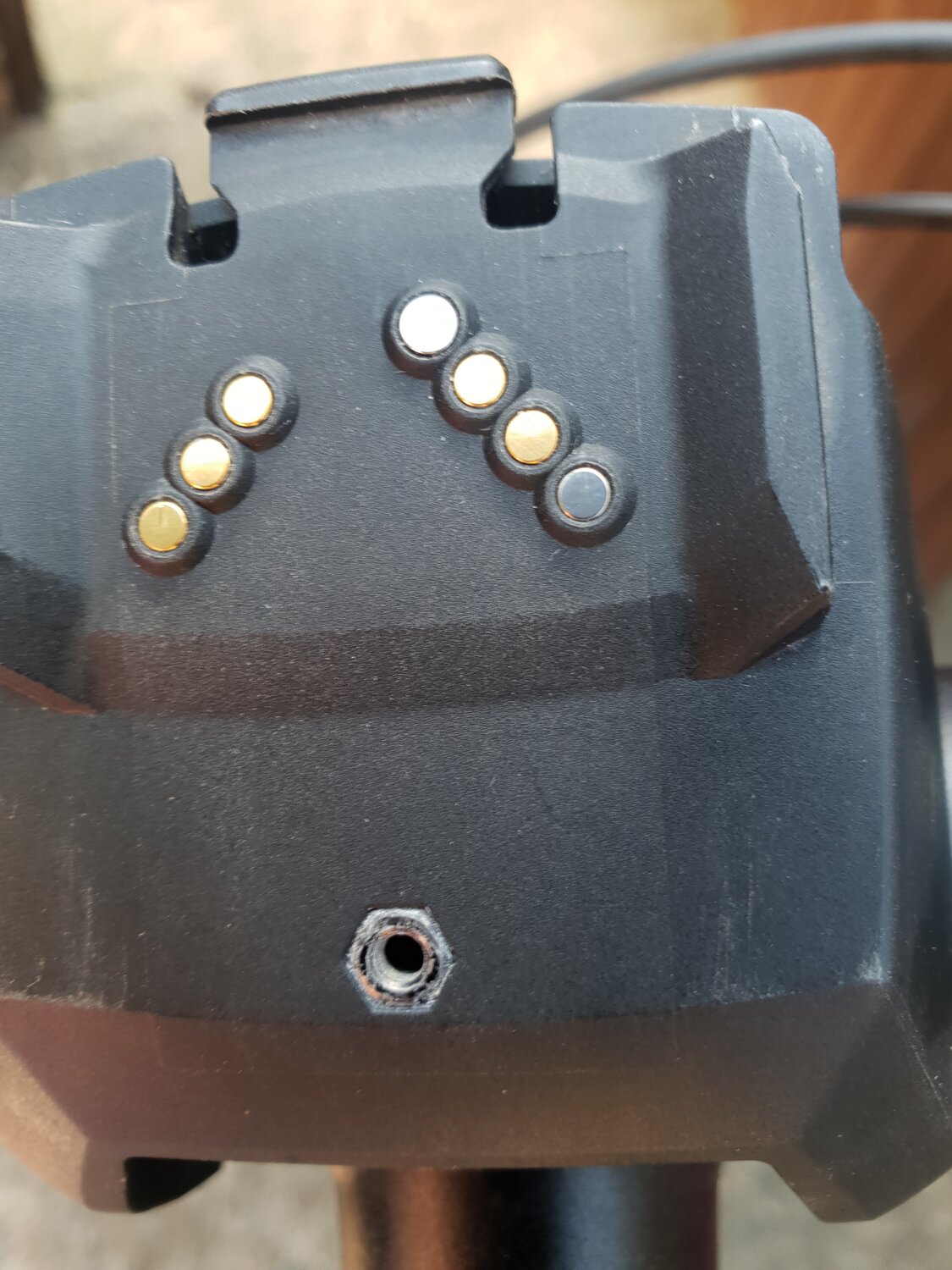

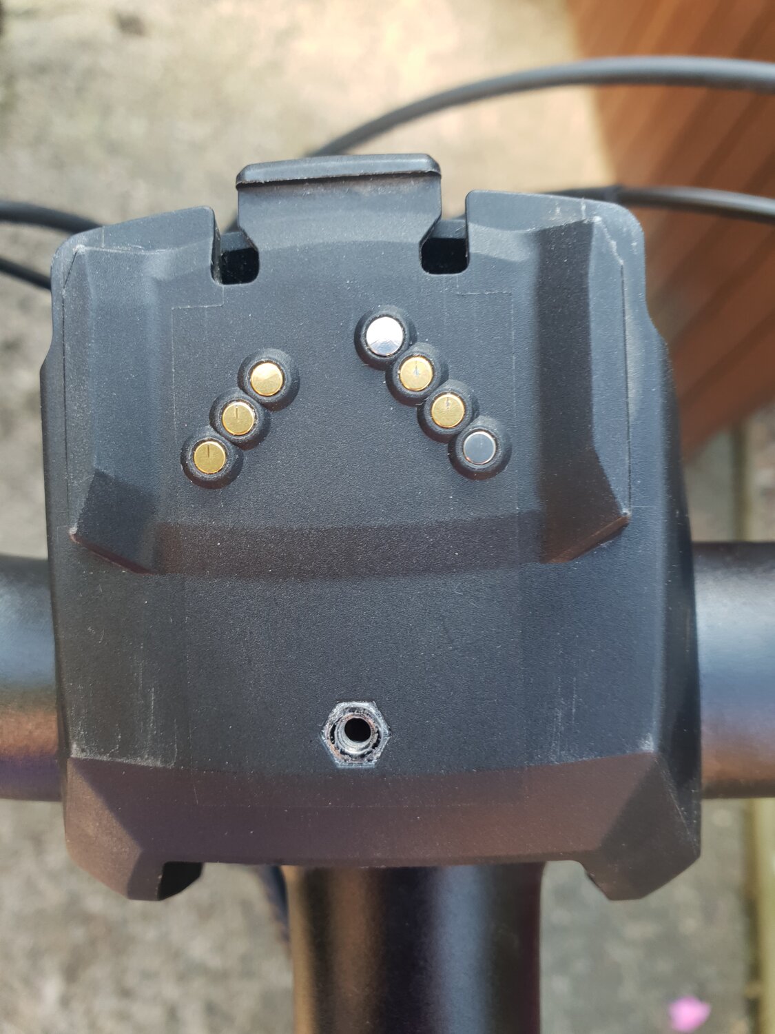

the contacts don't look bad. I have cleaned all the contacts with this it helps.
it could be the mount is worn out and not holding the display well. I have had that on my nyon.
and the mount. its not hard to do you would just replace the mount and not the wires. it could be the wires and the shop would need to run new wires.
What battery pack do you have? 400wh? 3 things can be going on; dirty contacts, dead battery in the intuvia, or a reboot issue.
1. Dirty contacts, use a pencil eraser and rub all the contacts.
2. Dead battery in Intivia,
3. Reboot main battery pack. I had an intermittent problem with my 400wh battery pack. The display would come on, but show no mph and not let me change PAS levels. Researched on line and found the solution. Turn on the display, if you get the situation with no speedometer and no PAS options, reach down and push the reboot button on the main battery pack and hold down for at least 5 seconds. When you release it, everything on the display comes on. Probably had to do that 4 times over 6 years. Works great. The only time I had to replace an Intuvia was after a crash. The back tabs broke off the back of the removable section of the display. I rode it for a year with the security bolt in the back and two zip ties around the base and display. If you aren't on a warranty, you can buy online for $177 for a new display and base. https://www.modernbike.com/ebike-head-units

Lots of people (not me) seem to have a "Warped mount" problem, where the mount is not integrated well with the bike handlebars, and gets just a bit bent out of shape. This causes bad connections where the Intuvia slides in. Sure, you should try to clean your contacts, and inspect them to make sure they are springy and clean. But also, try loosening the mount on the handlebars to see if your display connects better like that.
