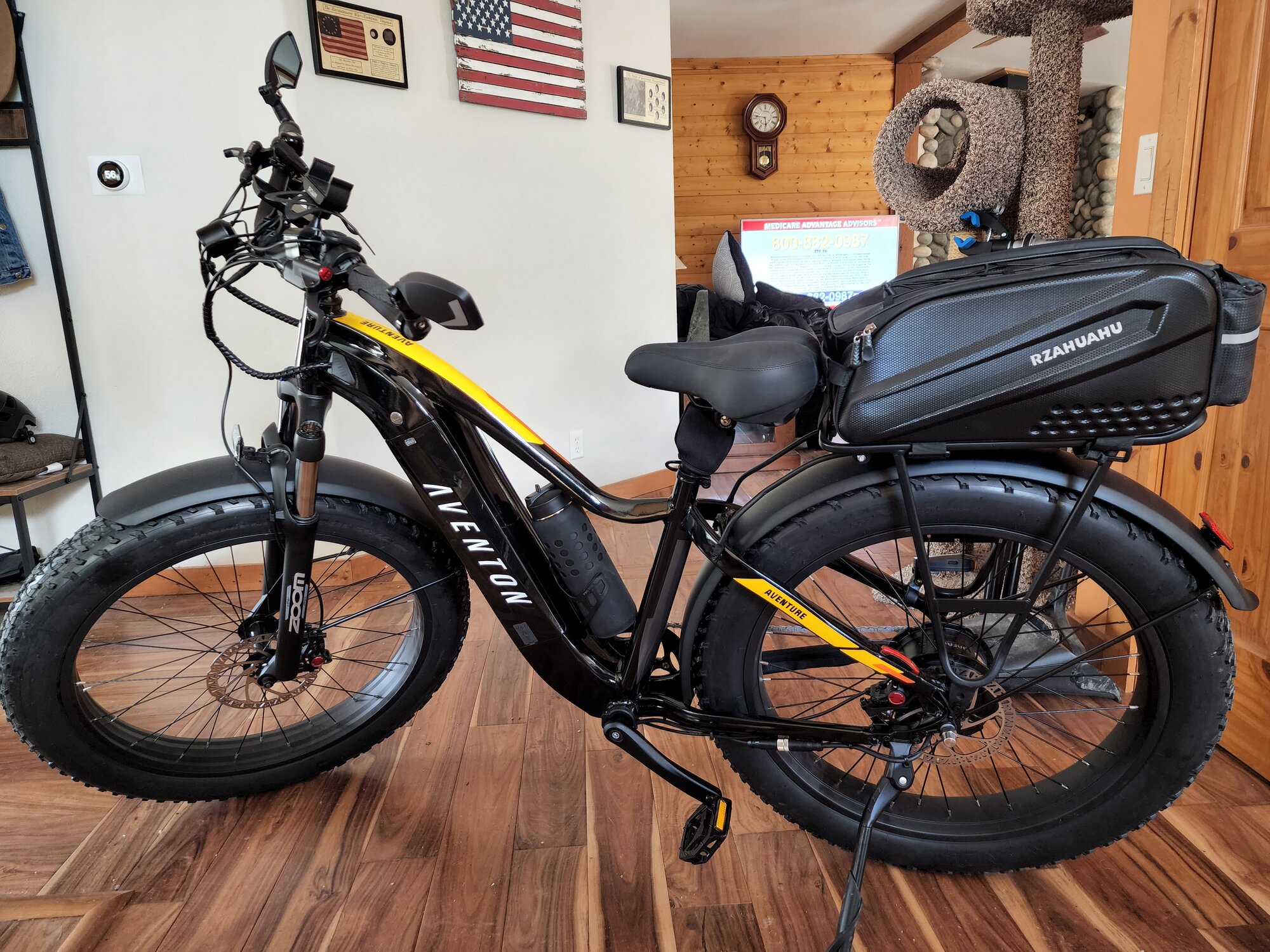

Hi All,
I just purchased my 1st E-Bike at age 69+ and love it. Purchased the Aventon Aventure (M) step over. I live in mountainous terrain so my old mountain bike just can't cut it. Attached is a picture of the bike. I do have a question. I like to carry an extra chain and am not quite sure what make, model and size would be best to buy. If anyone has a recommendation would greatly appreciate it. I have the bike fully accessorized and have just added "Flat Out" to the tires which has great reviews plus a skid plate with Aventon branding on Ebay. My only complaint is I wanted to purchase an extra battery, but they are out of stock and not available. Would not want to get stuck out of juice having to peddle the 73+ pound beast up mountains! LOL! Looking forward to riding this summer and being on the forum. Cheers!!! Jerry
