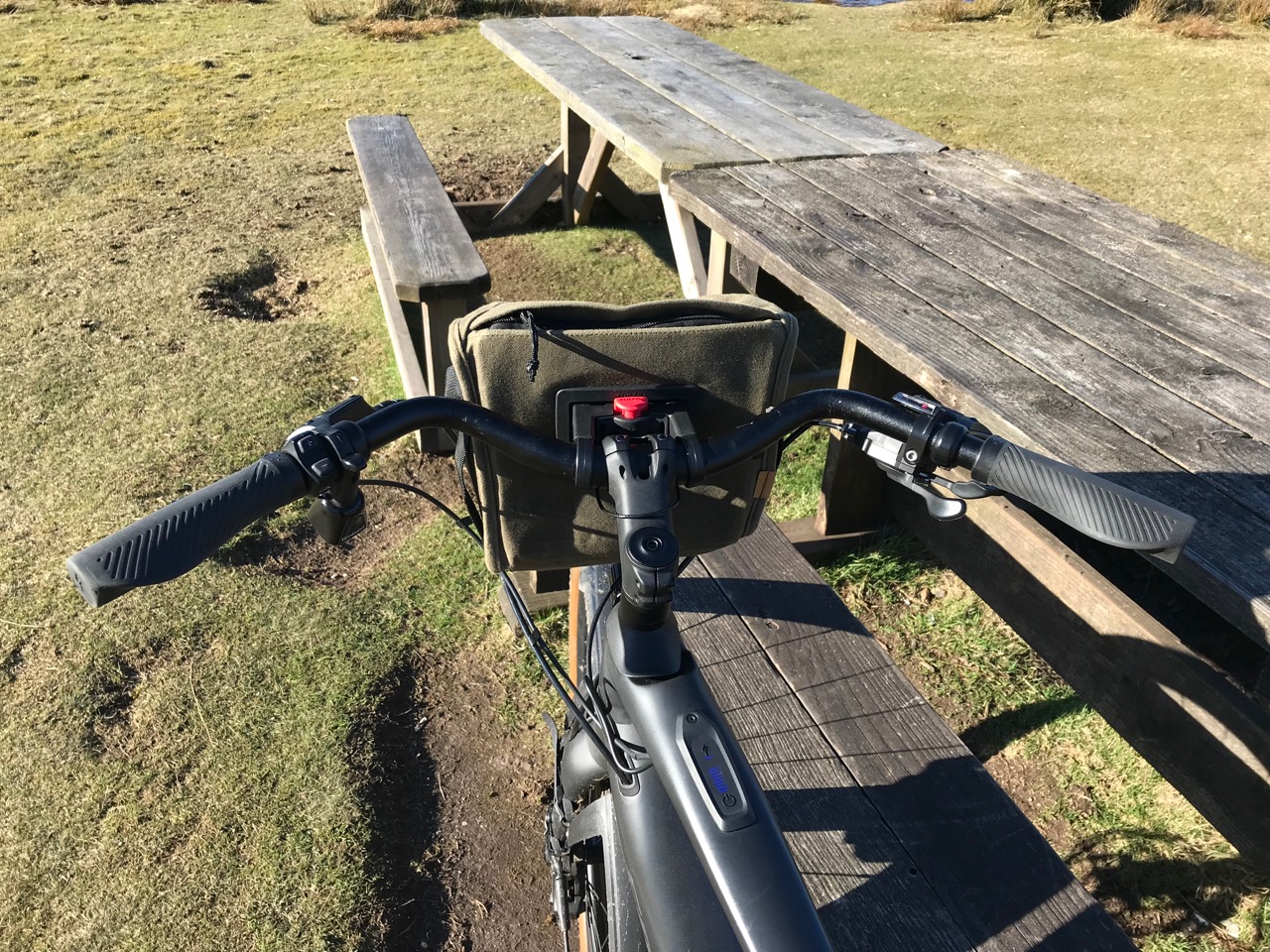

I recently put a Chinese knockoff of the Jones H bar on my commuter bike. I found the stock straight(ish) flat bar to be uncomfortable on longer rides, so I wanted to try something different.
The handlebar felt more comfortable, but I felt the bar had too much of a back sweep (45 degrees).
I replaced the Jones bar with a Surly Moloko and couldn't be happier. The bar looks kinda odd, but I find the 34 degree back sweep to be just about perfect.
Mine, once again, is a Chinese knockoff. The real Moloko bar is made of steel, while my Chinese bar is aluminum, which I prefer.
Some people like the 45 degree back sweep, while others find it to be too much. I hope it works out for you.

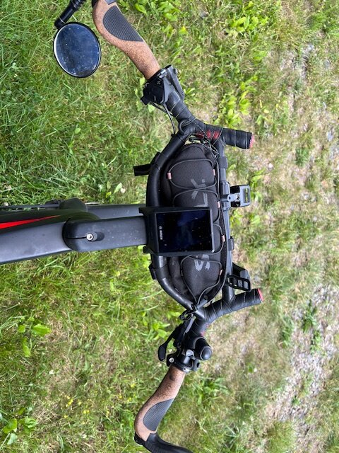

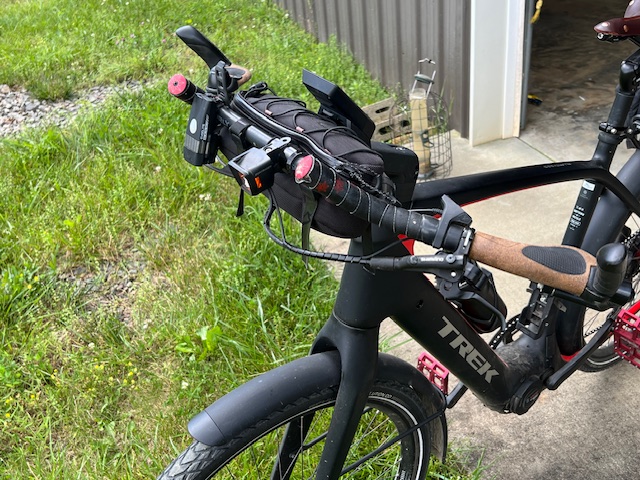

I changed mine to some swept back bars and the cables were fine. The backward sweeps (like the Jones H) reduce the reach and for me that helps a lot. It's now a very comfortable position and I don't feel so stretched out, though I think the H bars have more of a sweep and are wider.

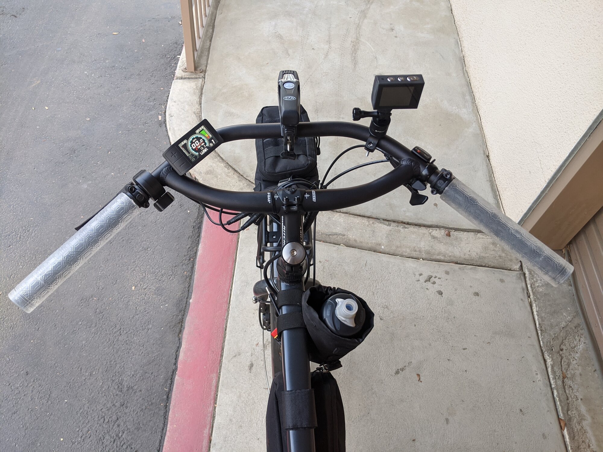

I have done the wider H bar on several bikes with great success. I went to them due to a wrist injury (hit by a car) and the 45-degree angle of the bars gave a natural wrist bend that was the difference between being able to ride a bike versus riding the couch instead.

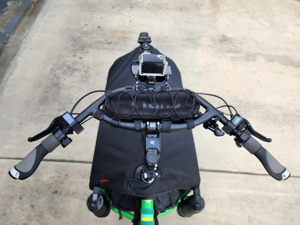

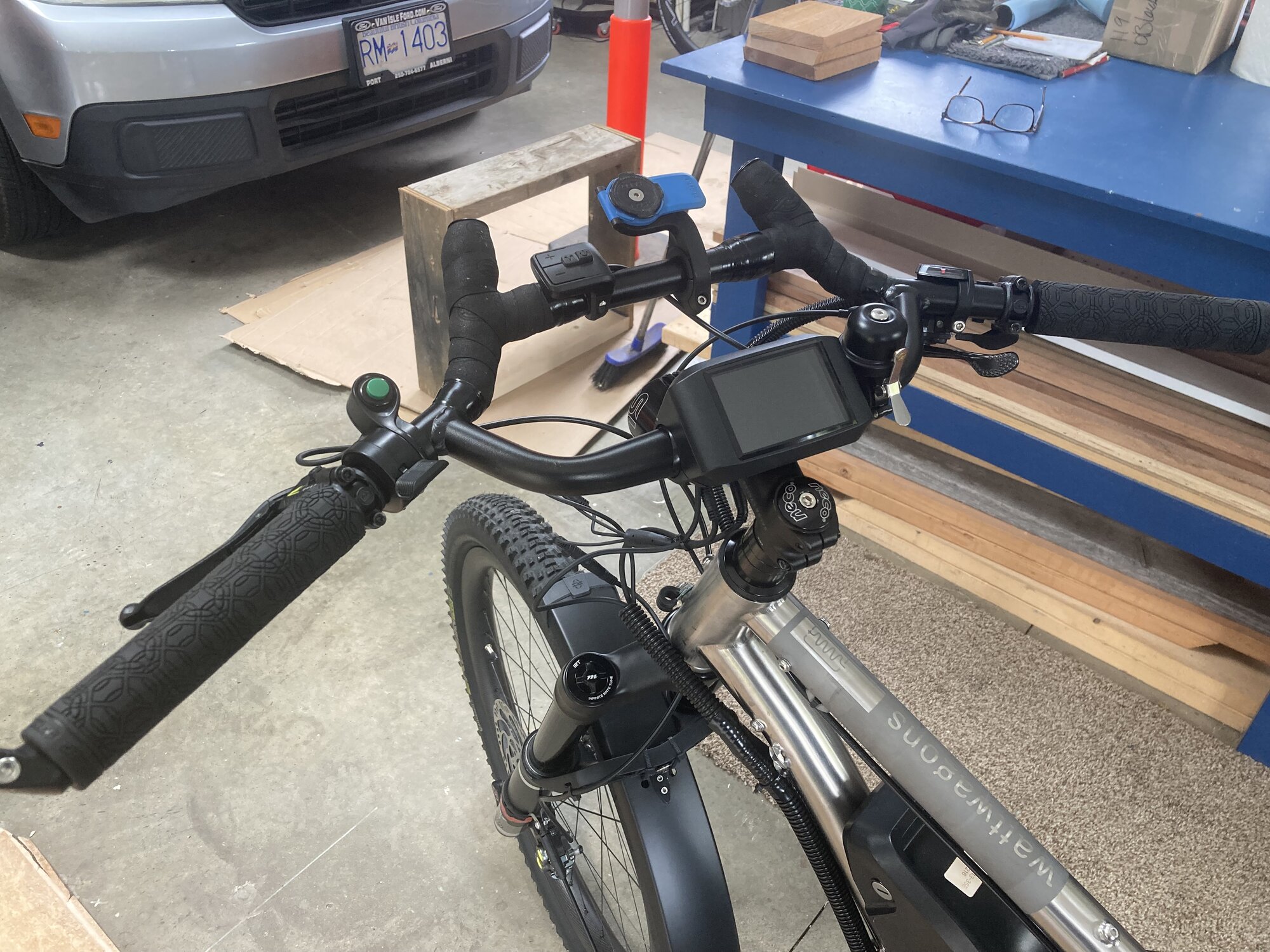

Here's a fairly mundane install. Note I did not tape the inner bar sections. Instead I used the longer grip space to be able to change my grip position which changes my entire upper body position. I can still use the center section if I want but I rarely do as it takes my hands away from the brake levers..

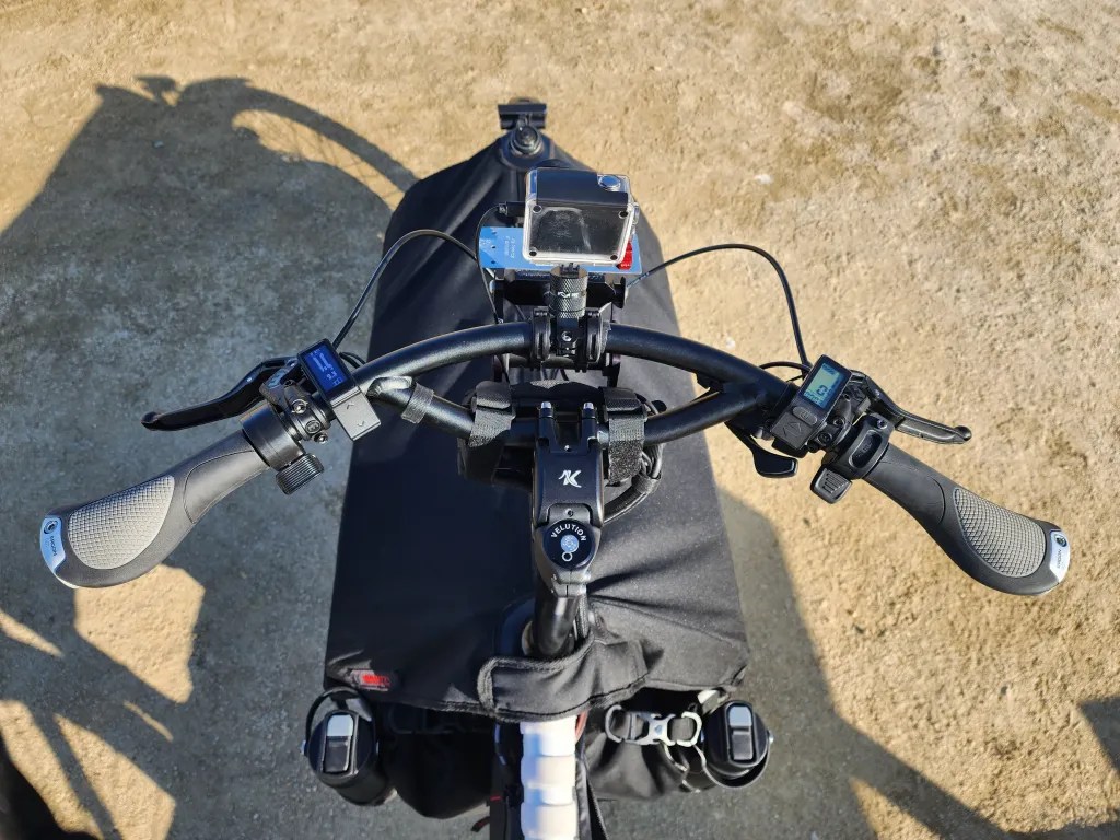

This is also a wider version of the H bars but since I am using it on a 2wd bike, I have less room for grip extensions and (since this is a much more recent pic) I am using Ergon palm support grips to further reduce wrist pain. The short grip extensions would just be done without on the shorter version of these bars.
This is a substitute I am very happy with as well. It is a very cheap bar: The Ergotec Space Bar. Less than US$30 and less sweep. It is the same width as the narrower Jones H bar, but has slightly more grip length thanks to the narrower center section. This bar also has a small rise built into it. I use this bar on two bikes (the other being my Apostate e-mtb) and am very happy with it.

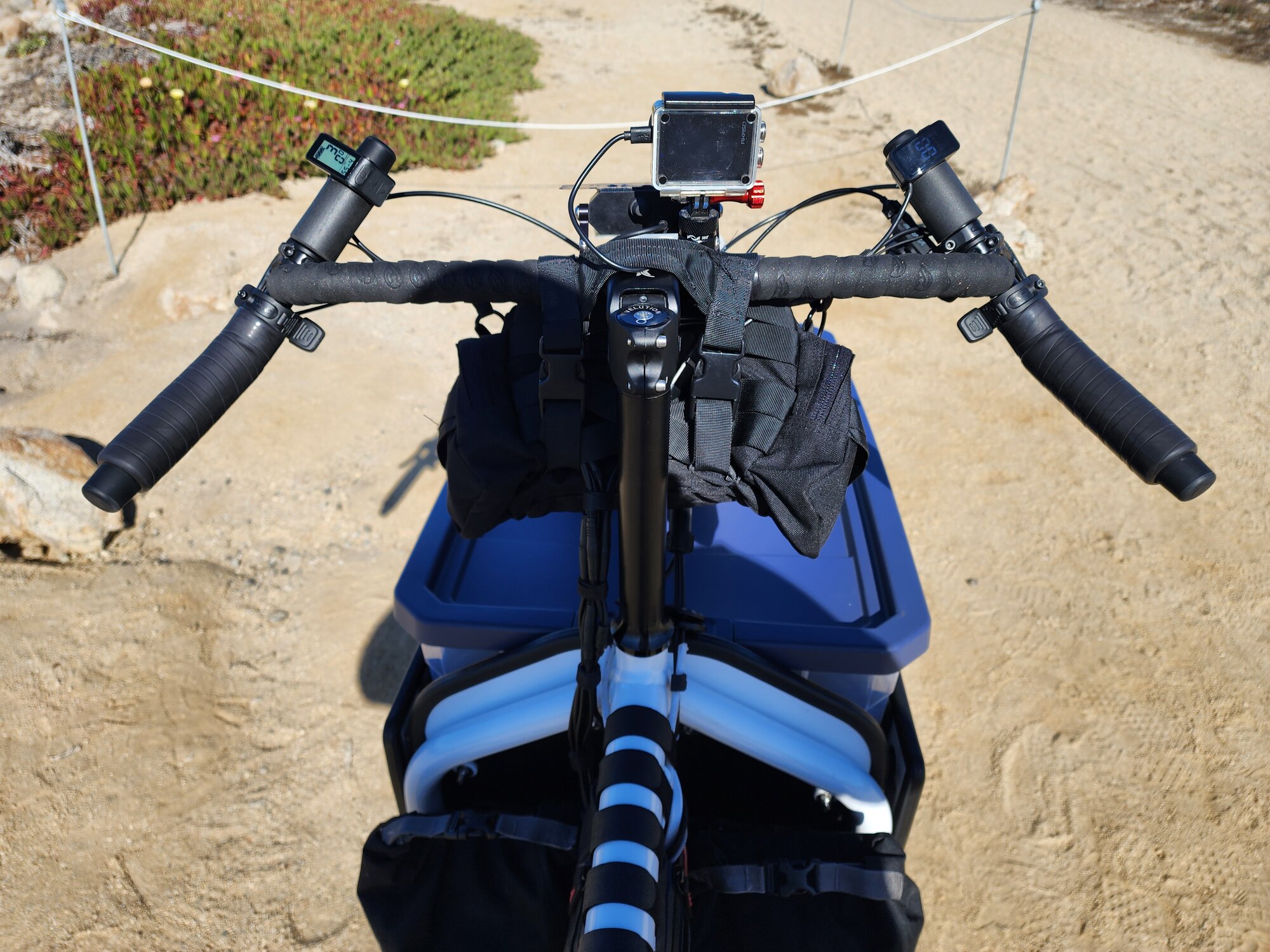

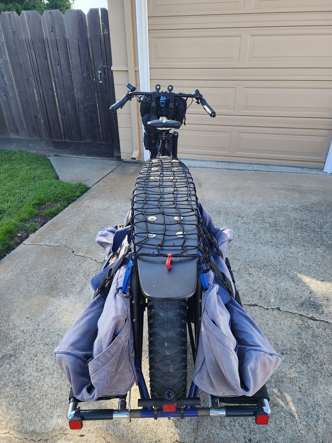

Its been a few months since I posted above about how the Corner Bar could not support the gadgets I need for a 2wd bike. Well, that was wrong. It can do so very nicely. Just finished the handlebar upgrade last week. I did the same two-thicknesses wrapped silicone grips like I did with the BFD. Oriented the 300X throttles differently so now I can hold normally in the drops and use the throttle properly with my thumb. Also wrapped the center section of the bars this time with old-school Cinelli cork tape to make a traditional drop bar hand position across the top.
I angled the bars precisely so my hands in the drop position contacting straight out with no wrist bend, and the pressure on my hand is even across my palms. No hot spots. This is just not possible even with the Jones bar. This bar is a really good alternative for sufferers of wrist pain, although you will need to do some work on the stem height if you are not comfortable with the increased lean-over position. Me, being an old road biker, I am pretty happy with it and how it changes the pressure points on my saddle.
