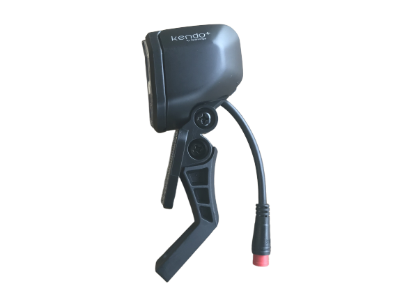

I ordered the NCM rack and light kit for my Moscow Plus. Very pleased with the rack, it is very sturdily made and the mounting is elegant, requiring no supporting stay. I doubt I'll ever use the light, but it is nice to know it is there when I need it. Yes, I'll confirm there is no headlight turn on from the display unit, but just a simple switch on top of the light. You have to look, but there is a threaded boss for the light on the BACK side of the fork support, so you can toss the lock nut that comes with the light, and just use its companion hex-head bolt to mount it there.
As far as the wiring, it is not necessary to disassemble the battery lock. You should be able to see the power plug in the opening on the front upper side of the downtube, where the control wiring from the battery exits. Just pry that rubber grommet out, and you'll have ample access to pull out the headlight cord to the desired length to plug it in. It's easy to get the grommet back in place afterward, and much less hassle than removing the lock mechanism.
And if it's the same as what came with my bike, the rear light is powered by it's own self-contained batteries and the front light directly from a 48V tap off the battery/controller with no on/off capability from the display. (This last point for Chinto's post above re an alternate headlamp)
Think again. I just measured the output on my Julet connector and got 50 Volts.
The front light Julet connector on the Moscow Plus is hardwired to the battery leads at the frame mounted battery connector. It runs at full battery voltage.

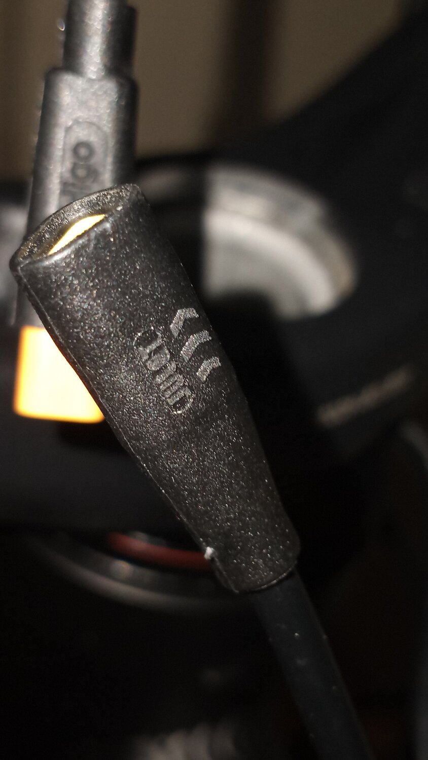

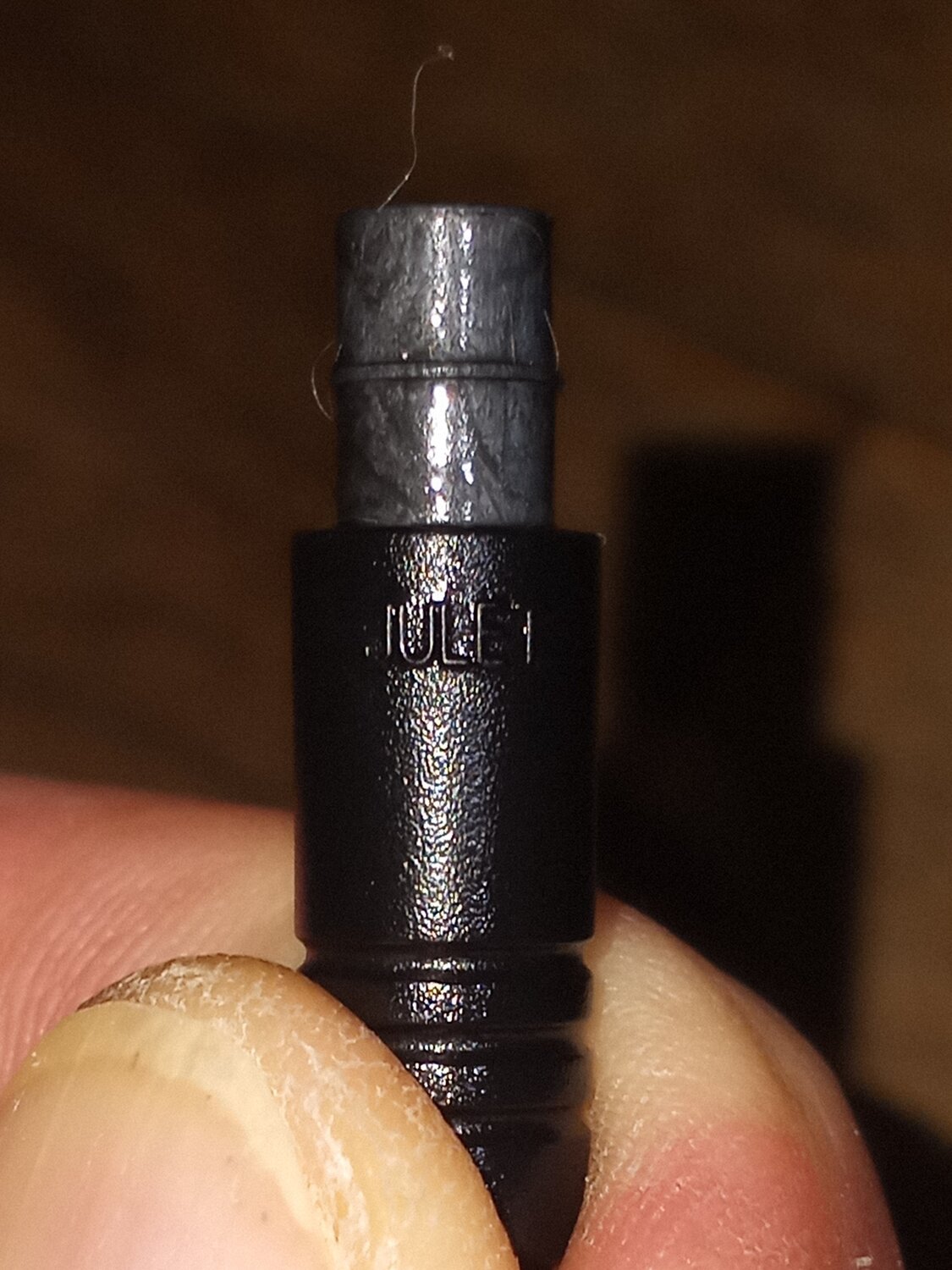

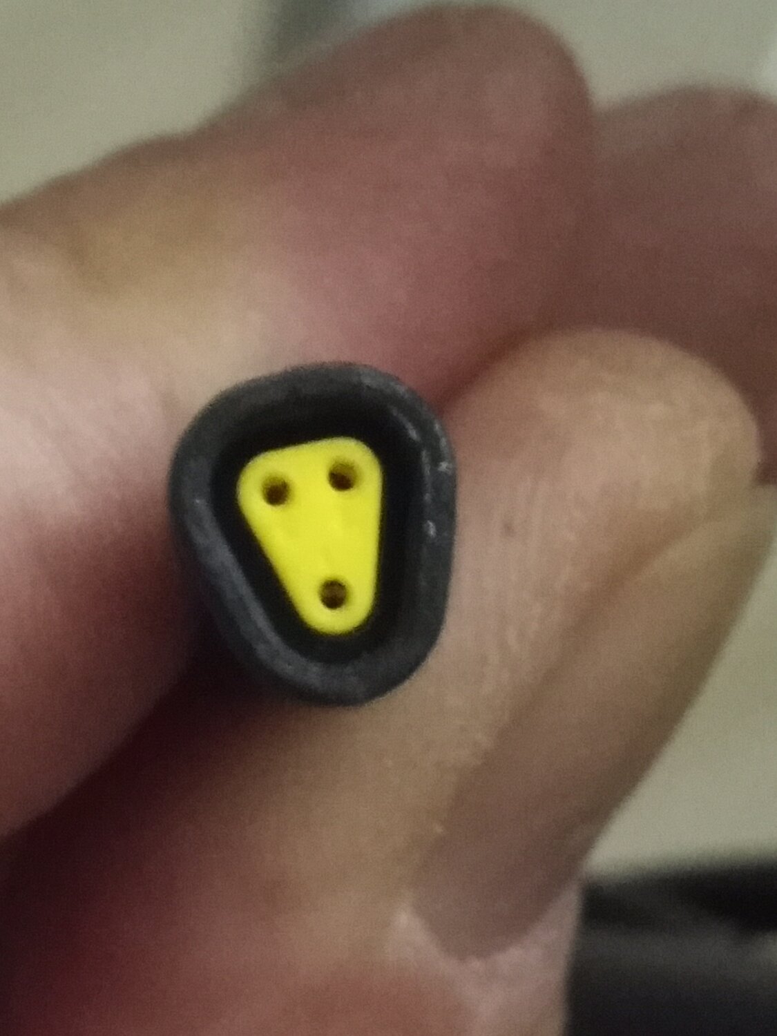

Does anyone know what kind of plug the headlight use or were to get one?

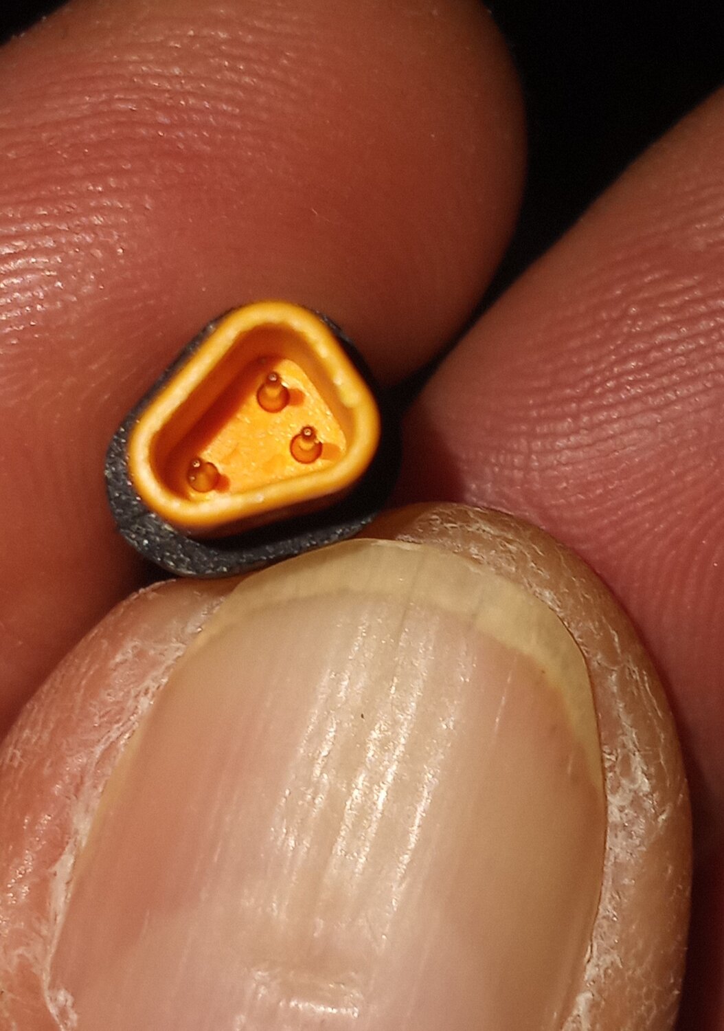

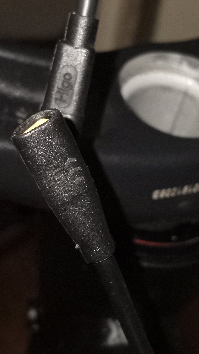

My Das-Kit C7 uses a 3 pin Julet/Higo connector.
The Higo/male is going to the headlight.

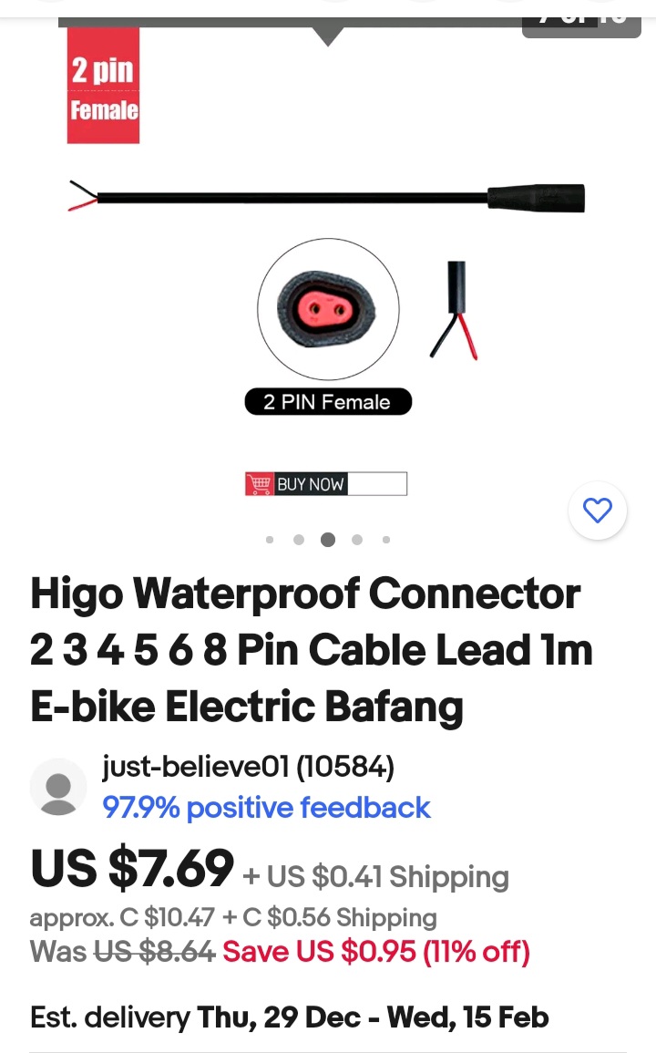

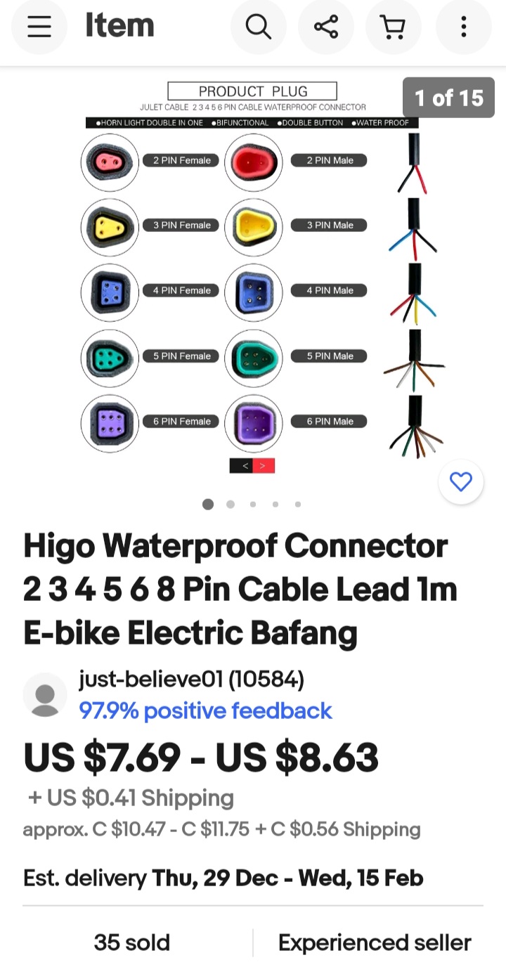

I found this on ebay,..
Screenshot_20221208-222314_eBay.jpgScreenshot_20221208-222453_eBay.jpgScreenshot_20221208-222715_eBay.jpg
I use the main battery, i connected the headlight directly to the battery and i use a power switch.Watch this trade, i put there many new upgrades.
View attachment 142038View attachment 142039View attachment 142040View attachment 142041

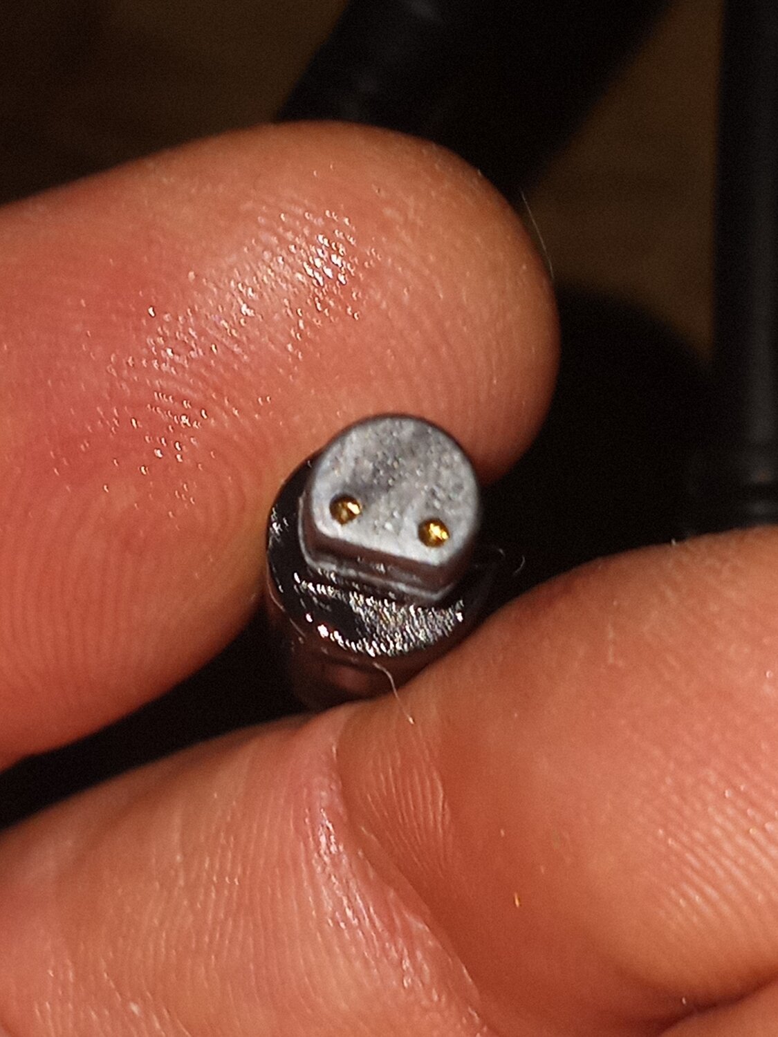

FYI...this is different on my bike (and I think on most NCM bikes). On mine the headlight is connected directly to the battery via a round 2-pin HiGo connector. ..Not thru the display. The light is turned on/off by a switch on the light itself, not thru the display. Not as good as the T1000 setup. It'll be interesting to see if your off-road display kit has a connector for the headlight and the ability to turn it on/off thru the display.
Oh, OK.
Thanks for the info.

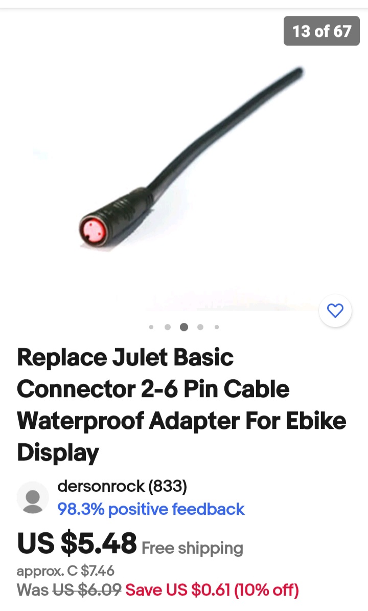

There is this then,..

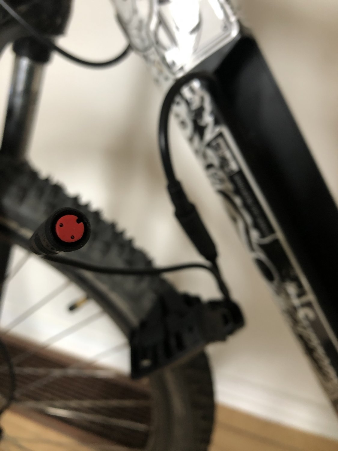

But my brake switch is a 2 pin plug labeled "julet" and it is different.
