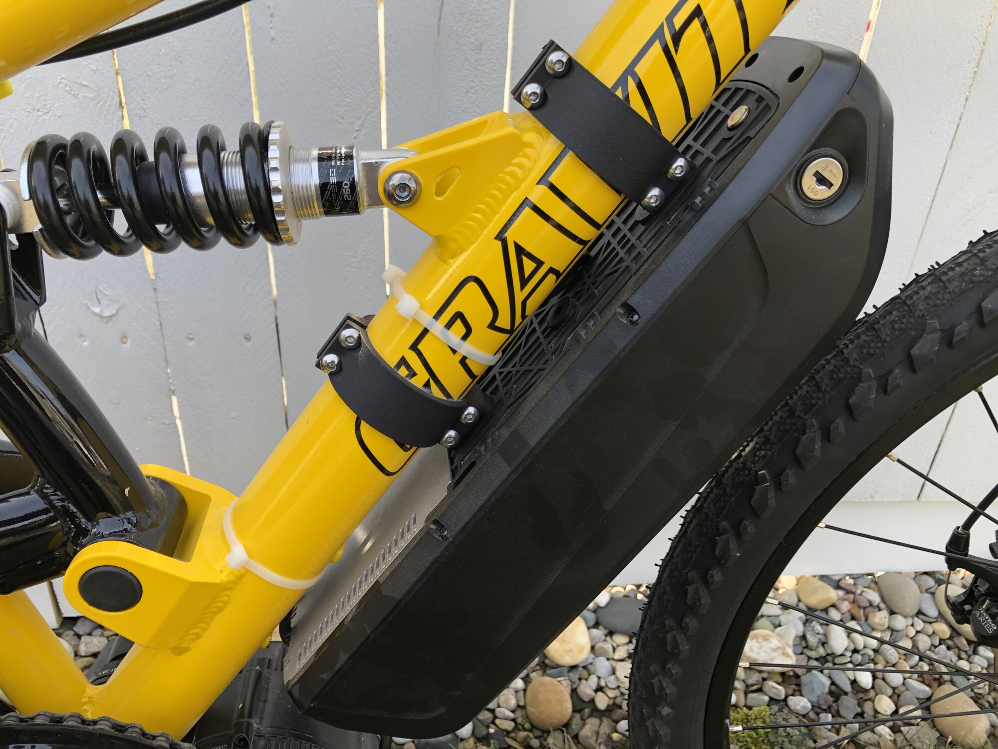

Too heavy for the two rivets nuts in the frame tube, or for any number of rivet nuts really. Thinking of making a couple of Delrin clamps around the tube(s) to fit the battery base plate on.
Something like this?
I cut clamps out of box fan shell, 1" wide by however long necessary. I use weiss shears. I drill a 13/32" hole on one end and several similar holes on the other end so I don't have to custom measure the length. Those will clear #10-32 SS machine screws. I file the strut edges & corners to prevent pants rips. I paint them, but raggedy appearance probably helps my bike from being stolen at stores, restaurants, meetings, job. I hold on torque arms from motor to fork and mounts for controller (under seat).

The tube is >2" diameter and thin walled, so I want any type of fixture to squeeze as uniformly around the tube as possible. Today's idea is fixing a mounting rail using 4-5 regular hose clamps, I imagine that will be pretty gentle to the tube. Unfortunately the tube is not entirely round so the type of clamps that @mikeschn suggested will not fit well (unless they are machined to the exact profile of the tube).
