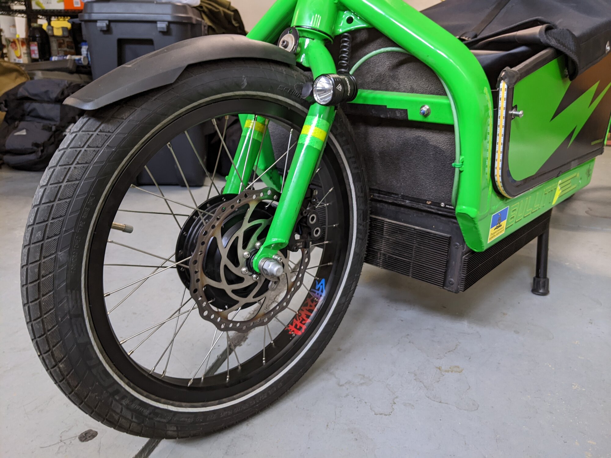

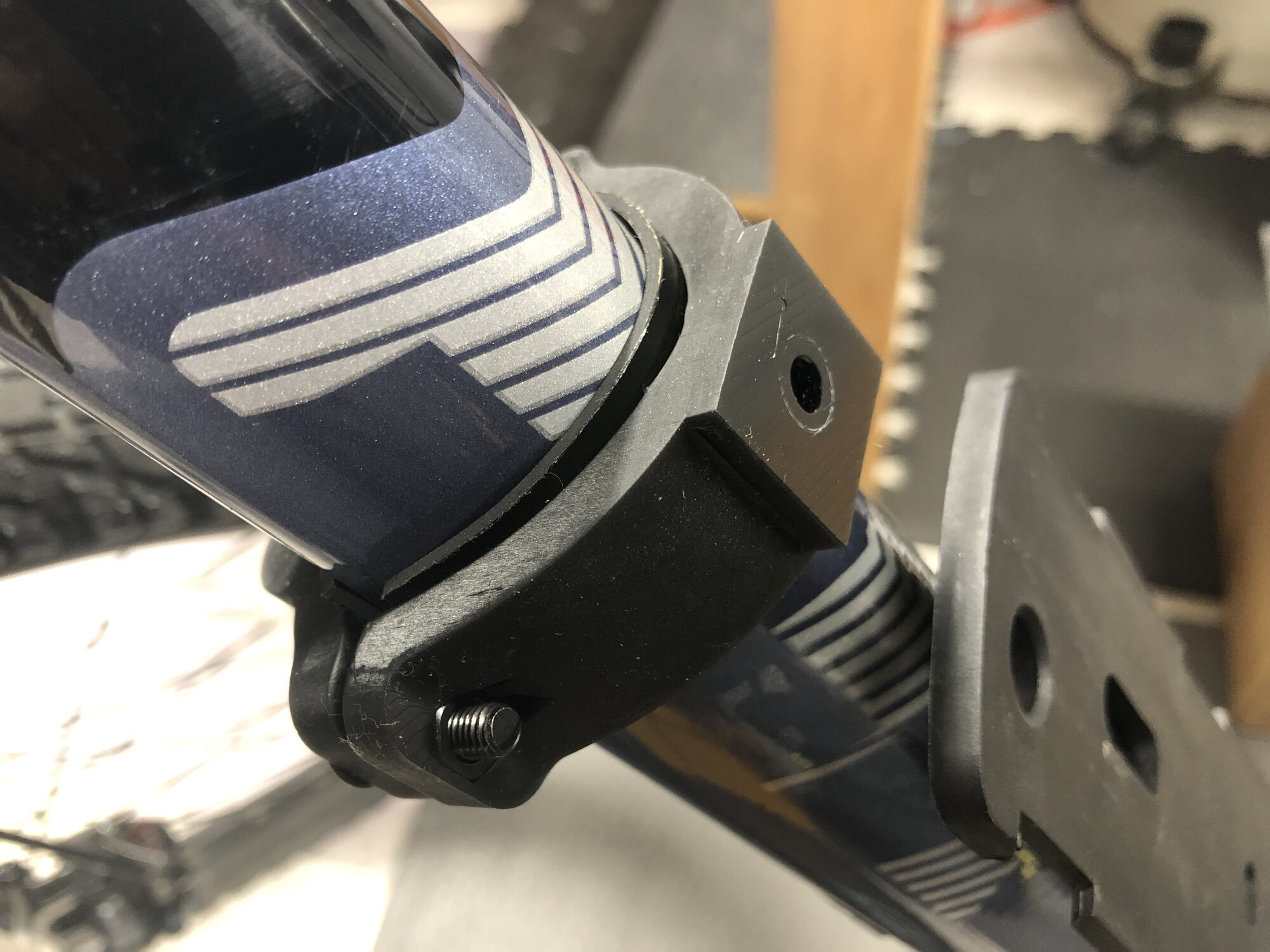

Here is a pic of a front wheel change I just made on my Bullitt (35mm wide rim to support that 2.4" tire). I'm showing the pic cuz it uses a different style of fender that bolts to the fork crown and doesn't get in the way of tire clearance. I don't use the rear as there is zero clearance so I have sealed the 'bulkhead' behind the tire in other ways. This fender is made by SKS and they have other versions.
None of these options will look as clean as what you had.

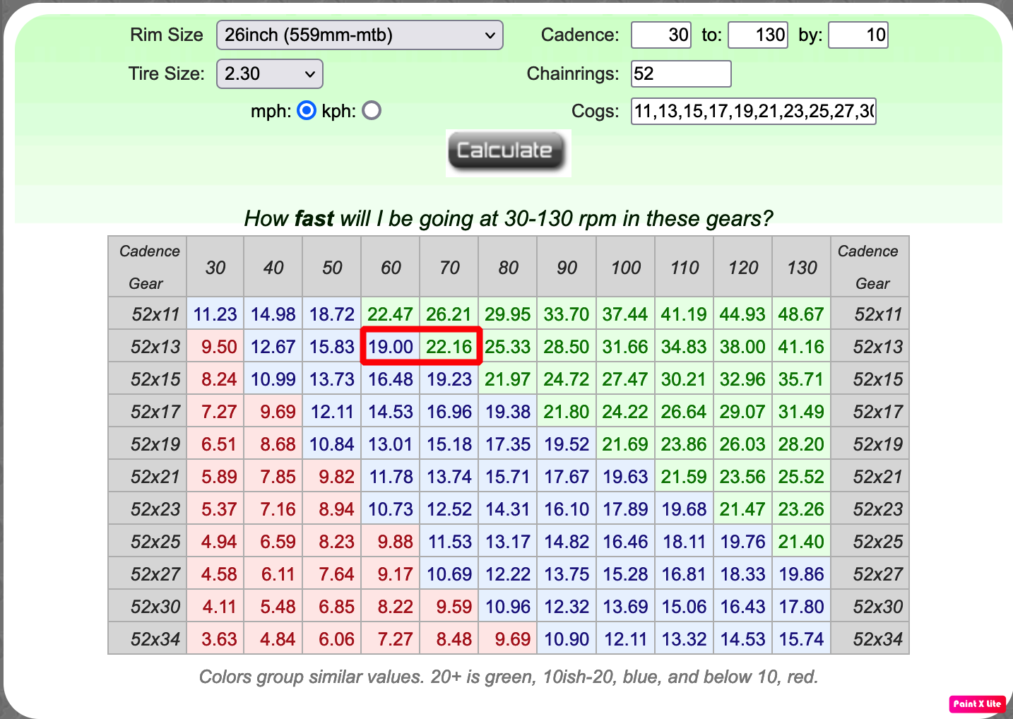

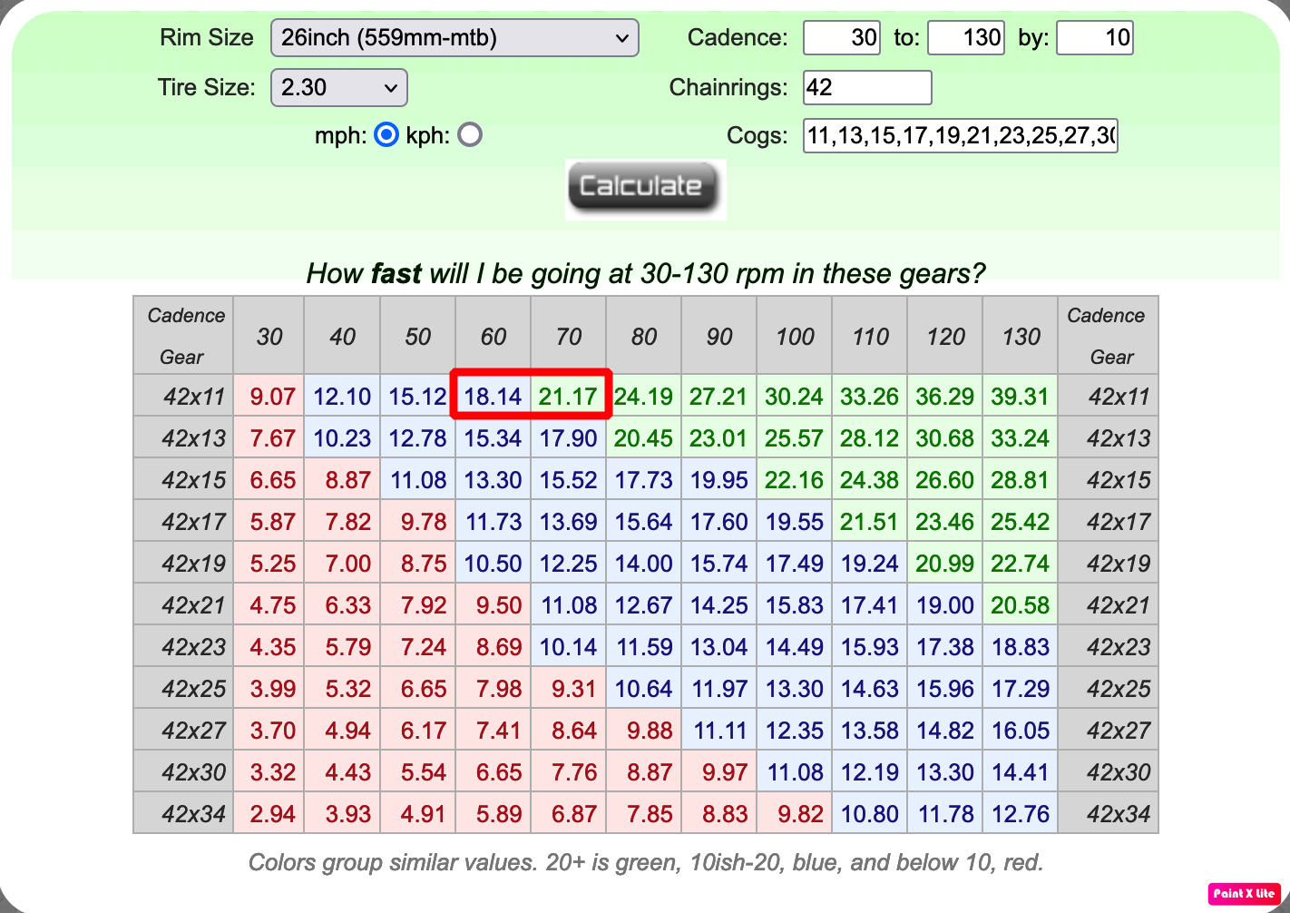

See the red boxed targets below...
That screen on that site is exactly the one I use to try and figure this sort of thing out. Set your chainrings as '42,52' and it will give you both data sets one on top of the other on the same screen.

At my normal cadence of 60-70, I am on the smallest sprocket. By changing my chainring from 42 to 52, I can get off the smallest sprocket. See the red boxed targets below...

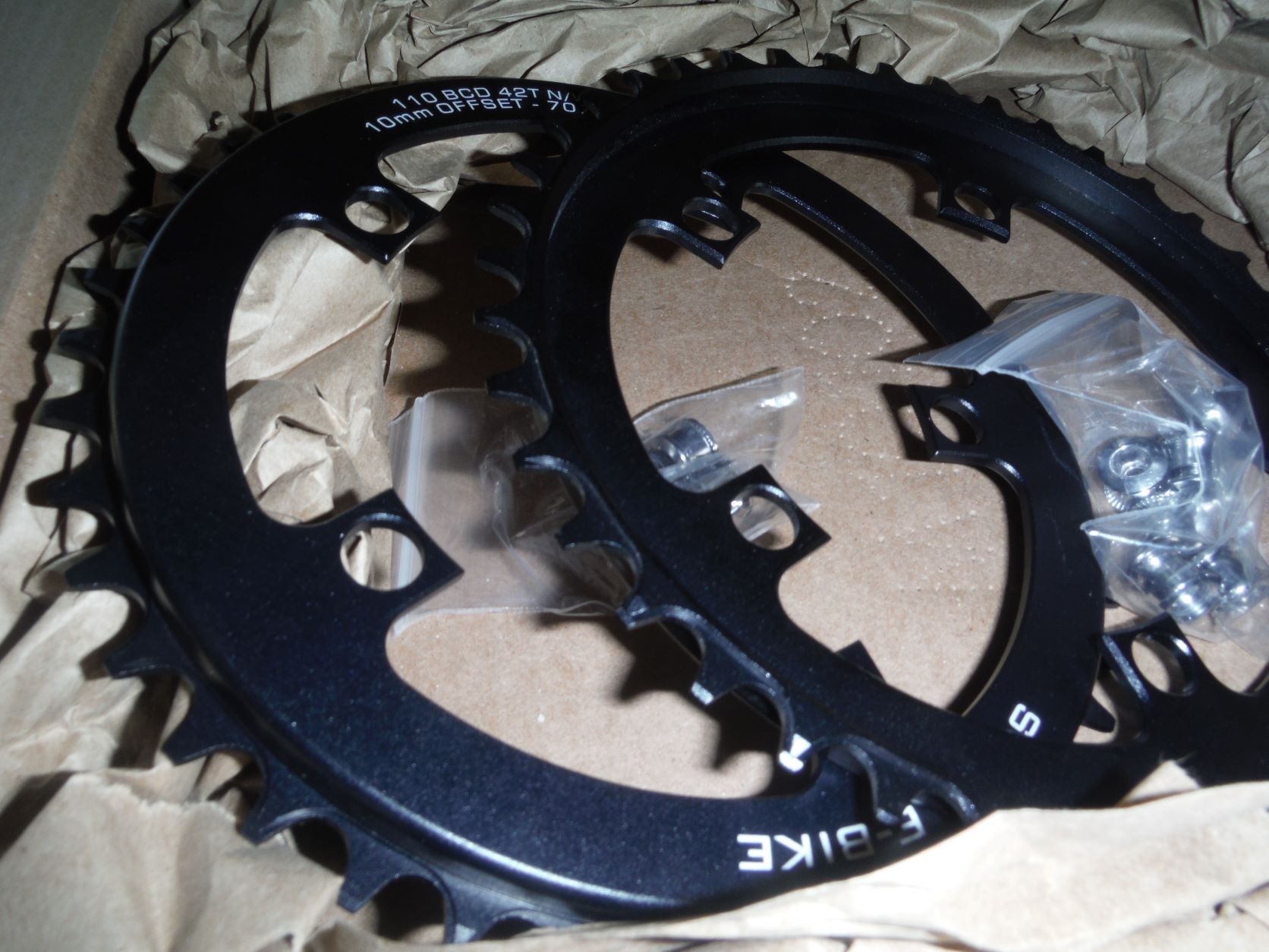

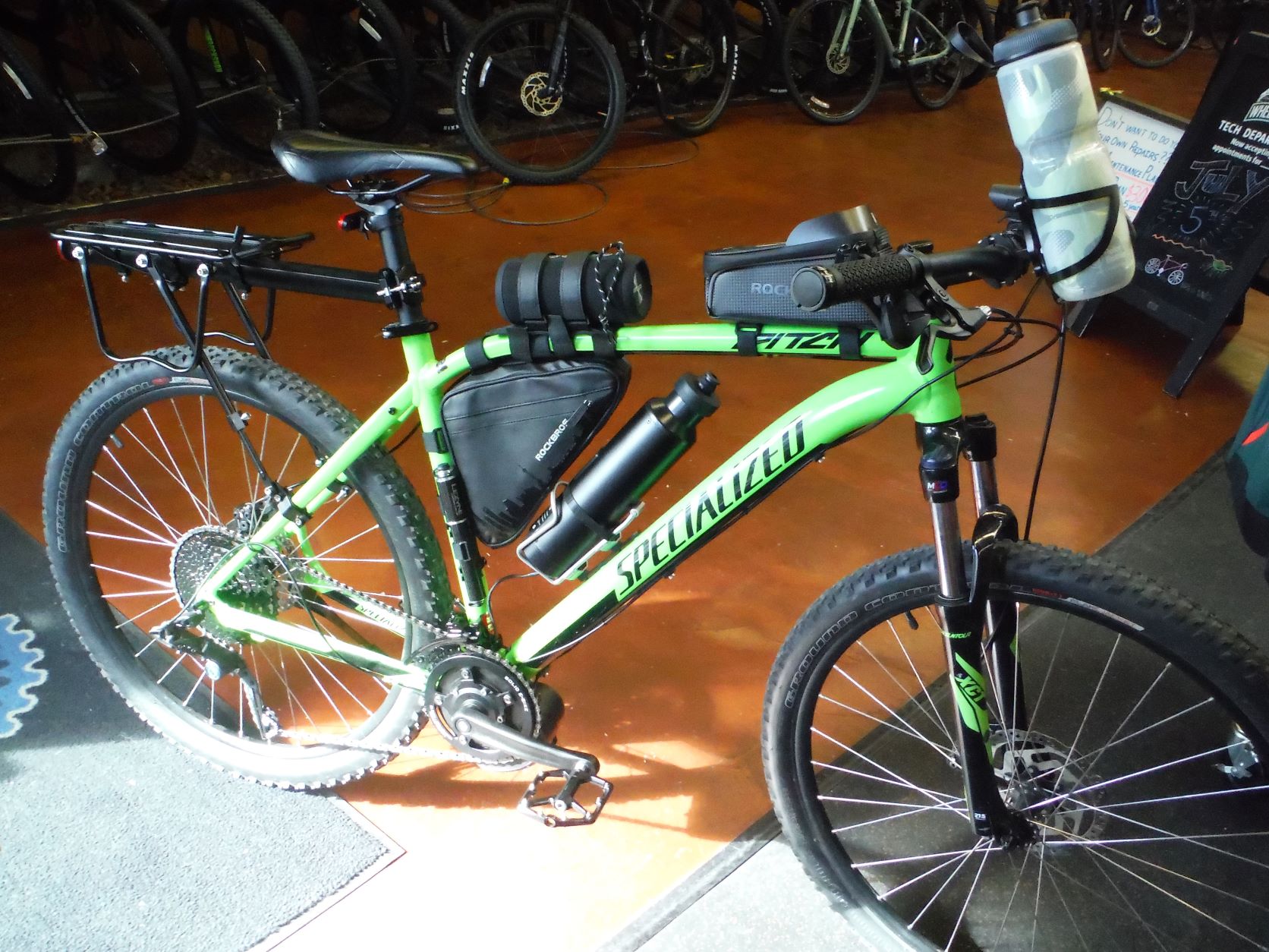

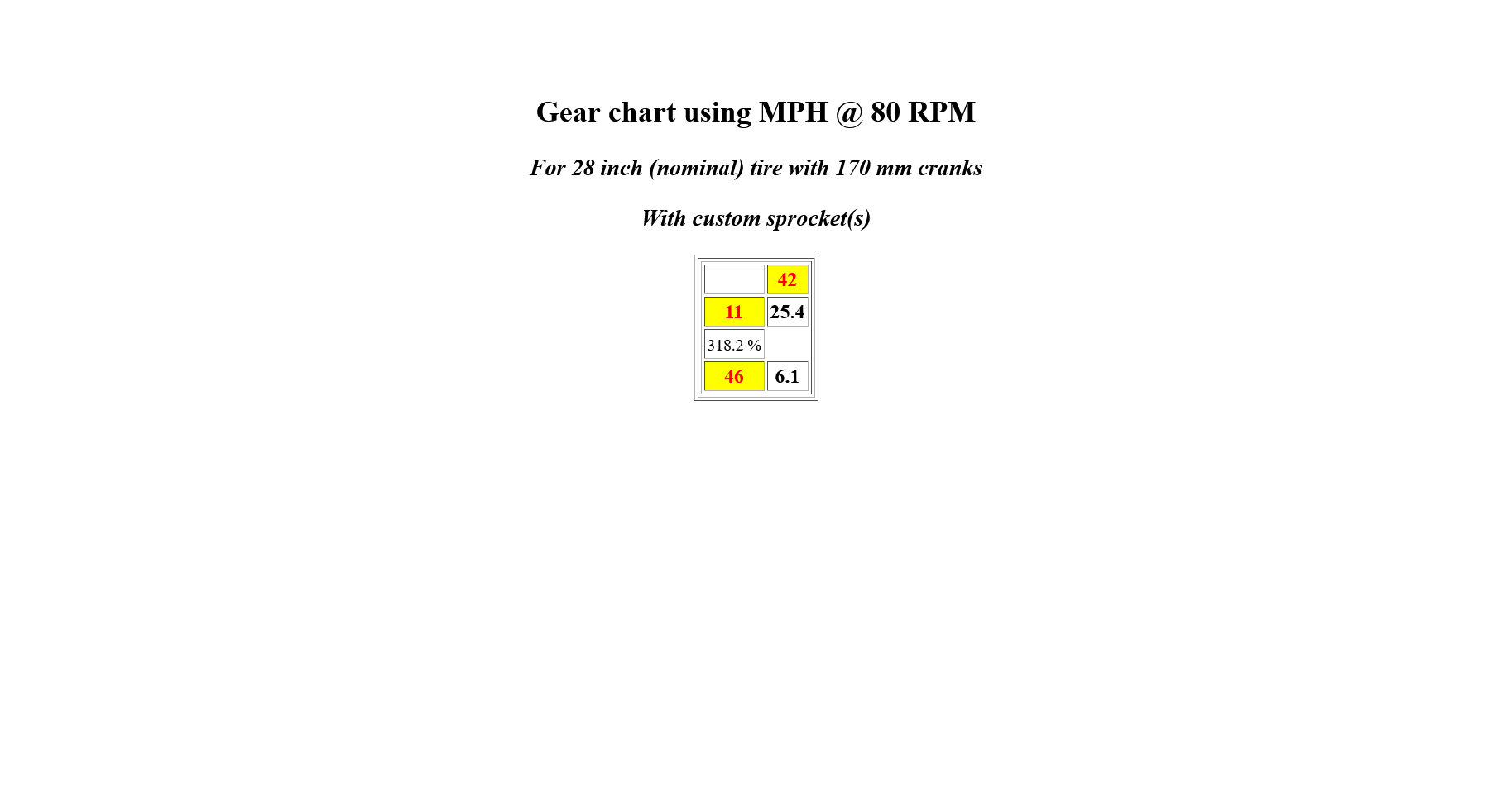

Interesting. I was just showing @m@Robertson an example from yesterday. I installed a Box 3, 9sp, 11-46 group set on an electric Specialized Pitch. It wouldn't hit 2 and 1. Too much cross chaining. Then I installed a 10mm offset, N/W, 42-t ring from Eco. It hit all gears but would drop off the front in 1. So I painted a front derailleur black and used it as a chain guide. Works perfectly now. That is about a 420% range.
Interesting bags on that Pitch. I need some storage bags on my bike... I may have to try some of those!
I think that he got them from that large river in South America. Those RockBros pedals are from there. They are super nice and dirt cheap. It is just too easy to order from that place. I can order at ten PM in my underwear and they arrive at my workshop at eleven AM the next morning. I put black nail polish on the logo of those pedals and tap it with a piece of foam for matte texture.

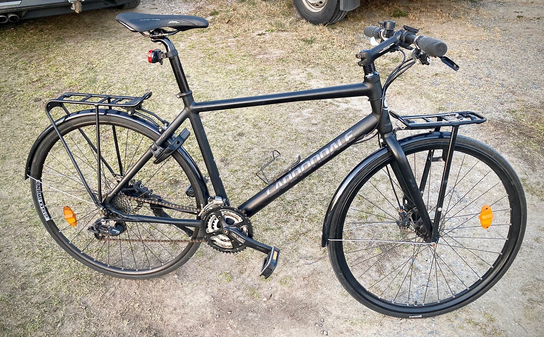

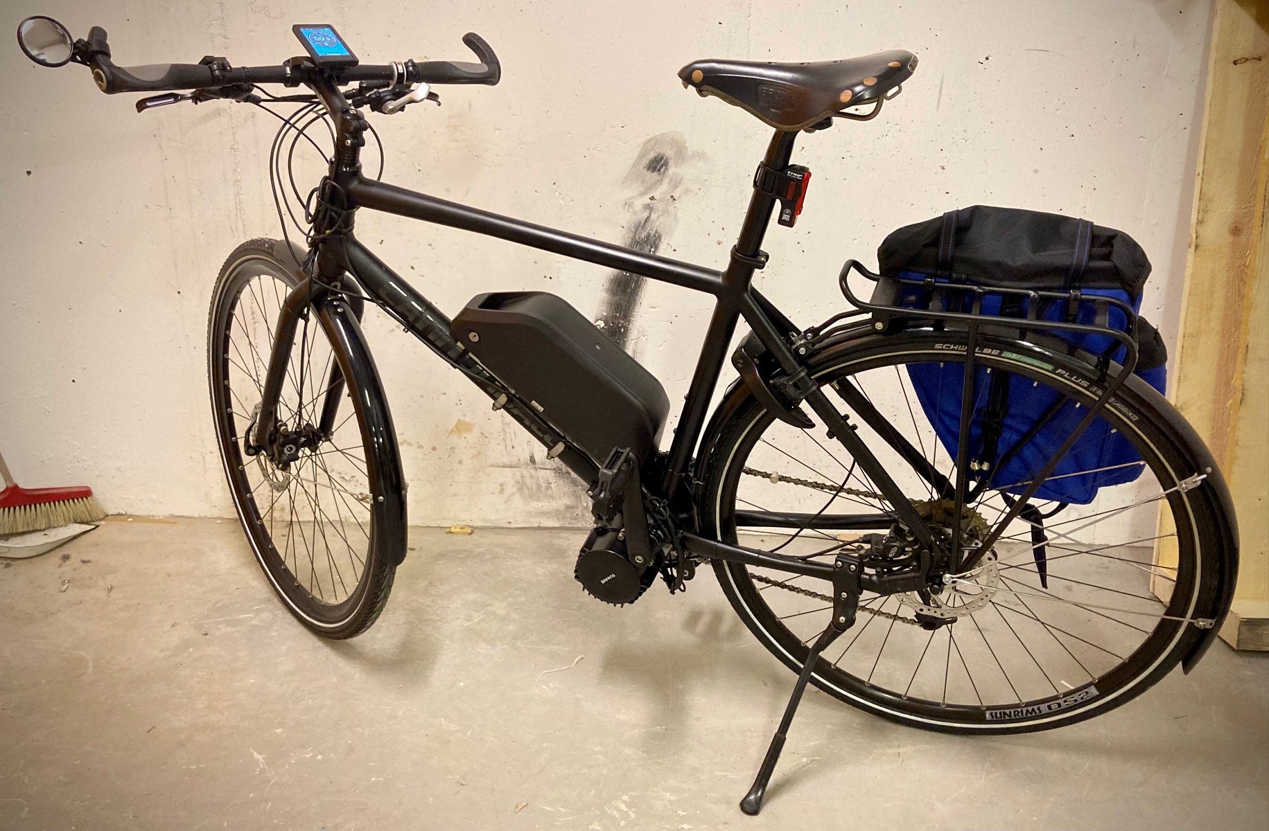

This was the designated victim, a Cannondale of unverified model from somewhere around 2004-2006 afaik. Alloy frame, 28" wheels with SRAM hubs and 28-622 tires. Avid Juicy 3 hydraulic 160 mm disc brakes, SRAM X-7 3x9 gear, 11-34 cassette.
Now with...
BBSHD with P850C panel
48V 24,5 Ah battery
Shimano pedals
Schwalbe Energizer Plus Performance 37-622 (E-50 rated)
Wider fenders to fit the 37 tires
New brake rotors, pads and chain
Brooks B17 saddle
Ergon GP3 grips
60 mm mirror
Lezyne Strip Alert rear light
I am quite happy with the choice of BBSHD over BBS02, not for the actual required power but for the extra headroom and apparently better cooling.
The Ergon GP3 grips make a huge difference for me, as does the Brooks B17 saddle. The mirror needs a better placement of course, wherever that is going to be, but just having it is a great benefit imho.
I would have gone with 40-622 tires for comfort - and I actually did at first, but they were just too high and touched the frame. The 37 mm is 3 mm lower and still E-50 rated.
Down the line I may consider a damped seatpost and a narrow click-on bag from local manufacturer AVS.
Nice build. Gotta be a very fast bike. The BBSHD can run as a one speed and take incredible abuse.
Target was 40 km/h or 25 mph sustained (and, ideally, trip average) for 30+30 km and it does that. ;)
Almost all my commuting route is paved, low traffic, smooth country road and fast cycling. But the last few km is dedicated bike lane/path, paved but for several reasons not fit for speed, and that inevitabely brings down the average by an amount that I can't make up for on the rest of the route. But I can live with that.
